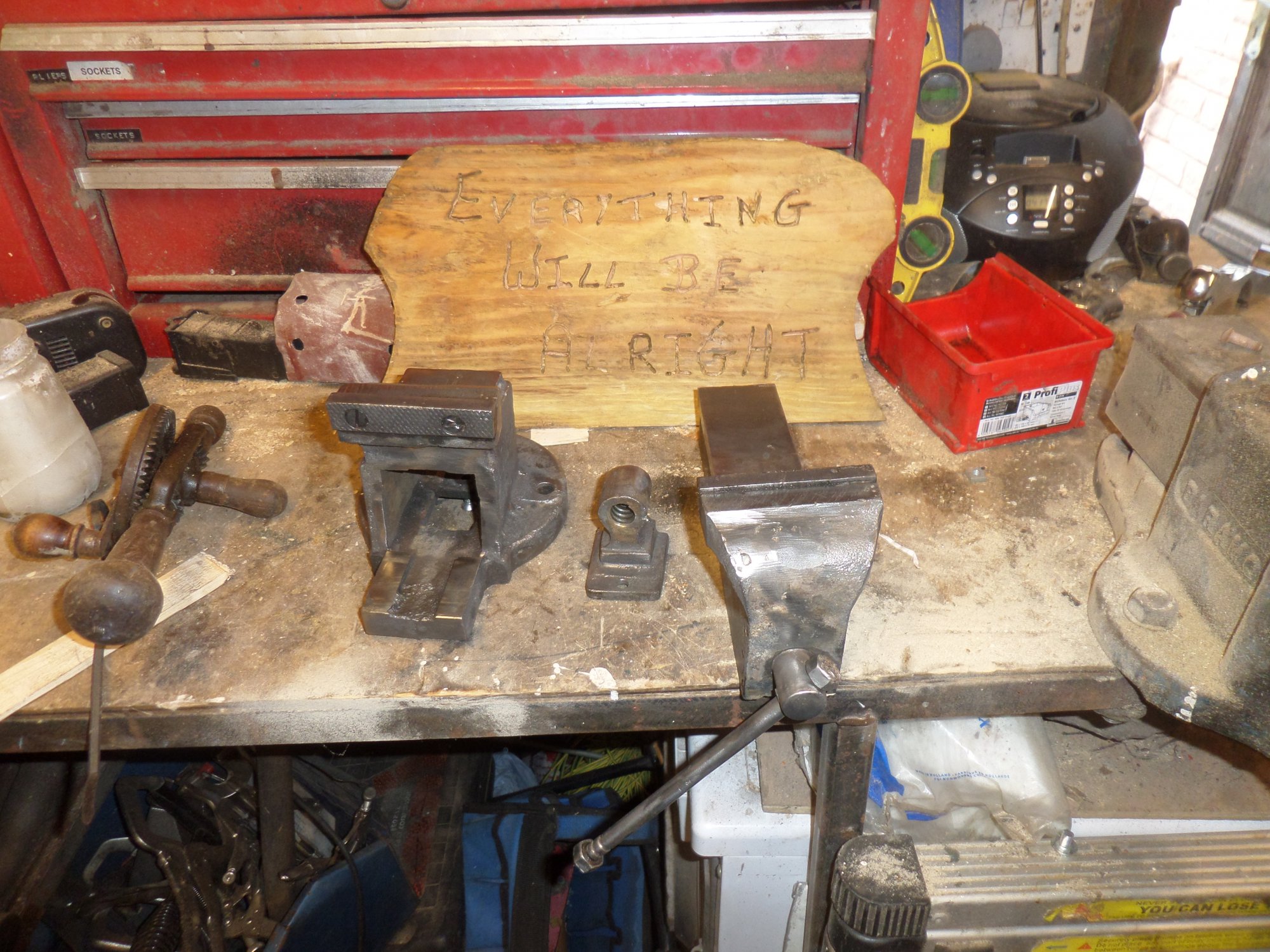

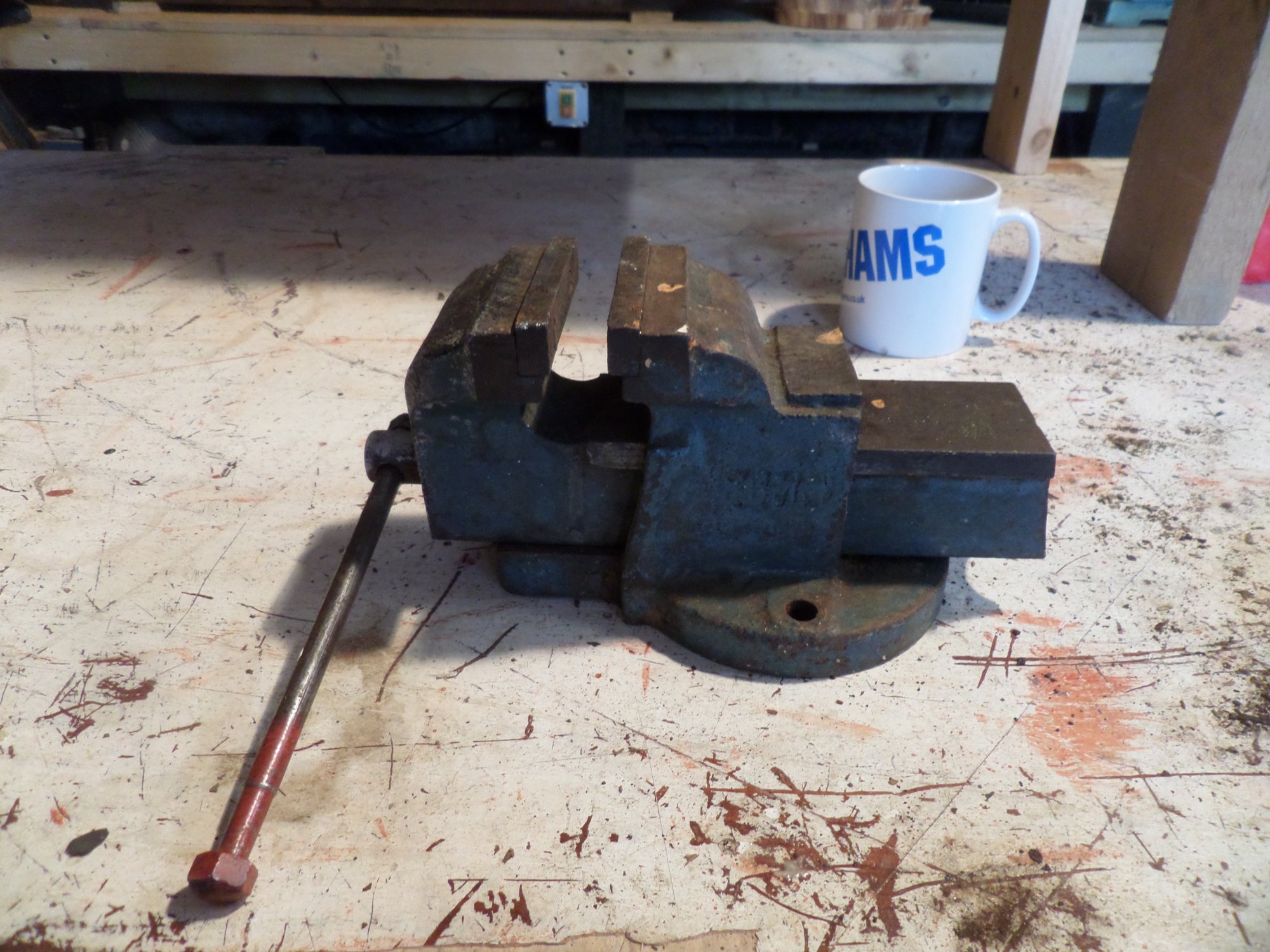

The other month, at the Men In Shed, we were donated a nice little vice.
The person who donated it was pleased that; "Dad tools are going to be reused."
Looks nice, well in this case looks are deceiving.
It did not move. The handle was glued in place as well. Underside was a mess off rust.
So, what to do. We are short of a small metal vice, so I thought I could at least have a go.

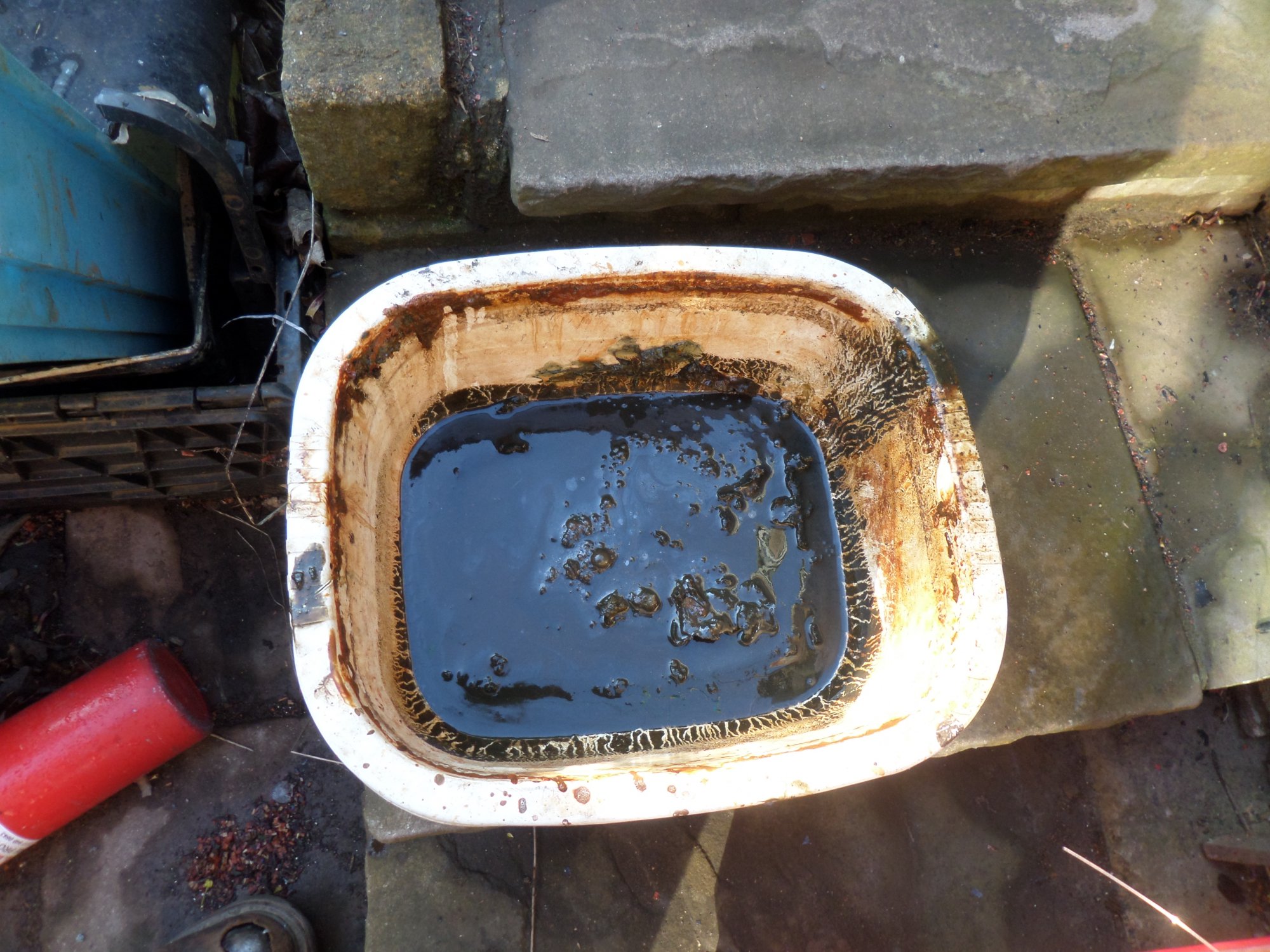

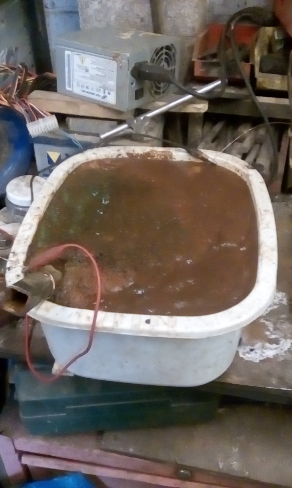

Step 1
De rust.
Step 2
Leave over night, drink beer and recycle beer cans.

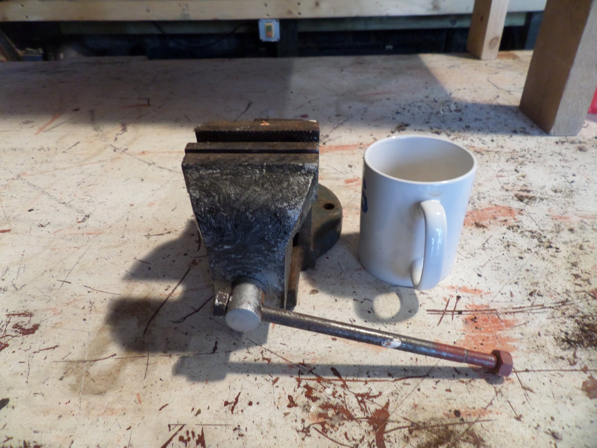

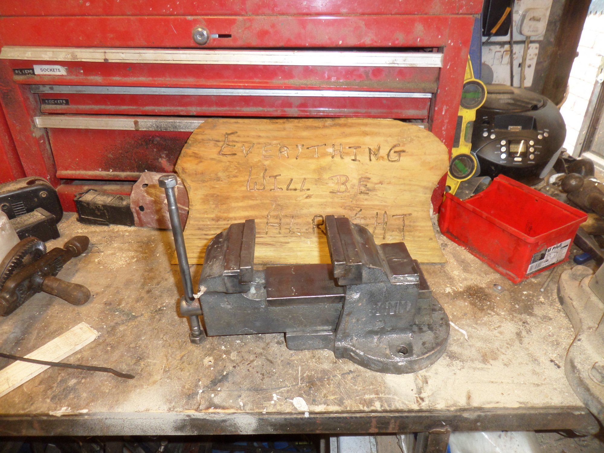

Step 4.
Clean and look at the mess.
Step 5
Wire brush clean, followed by a nylon brush and my mix of wax and linseed oil.
Look smug, drink coffee.
Step 6
Reassemble and feel smug.

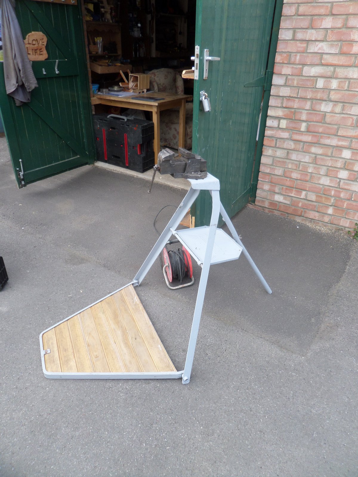

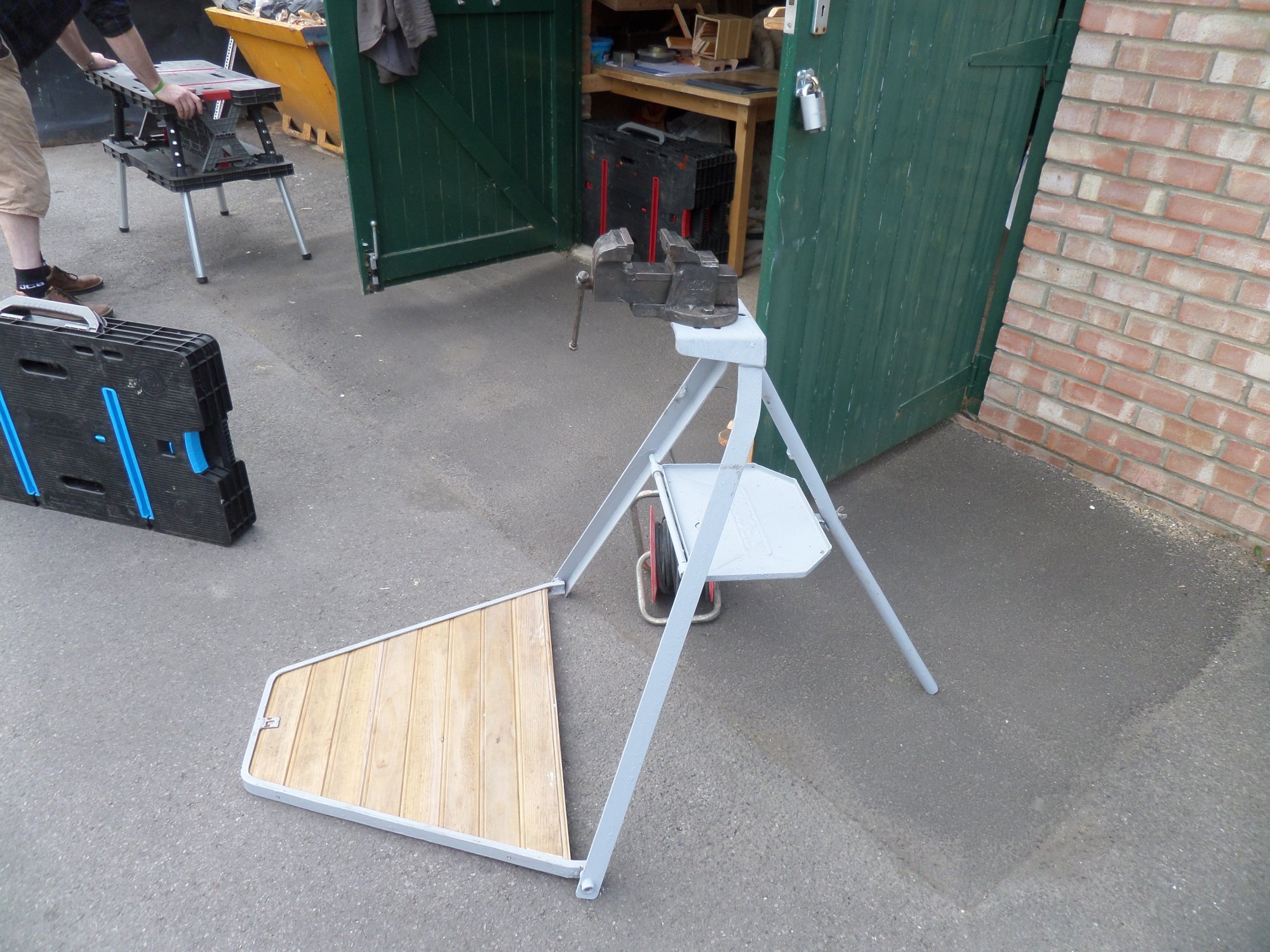

With reference to that post of mine and this one.
Post 4375.
The pipe vice is now removed and the vice fitted.
The old 19mm chip board was well past it's best.
So a rummage in one of my woo piles and some 20mm tongue and grove floor boards we have a nice place to stand.
A quick fettle with a router to but a nice bead on the wood, helps to stop slipping. We have a nice Danish oil finished to place to stand on.
