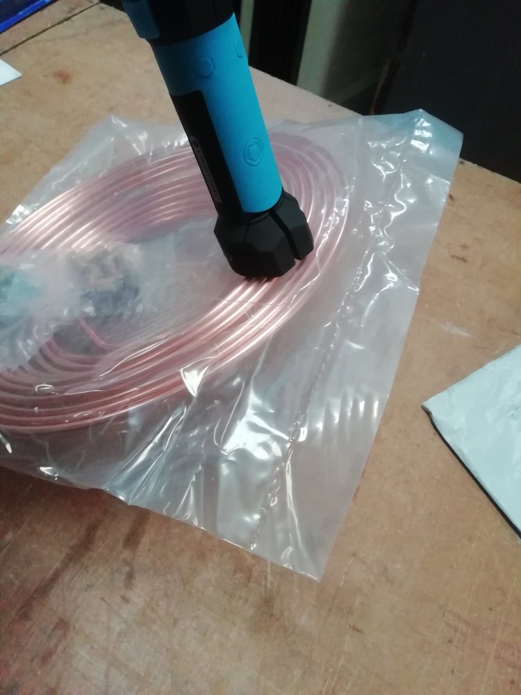

My Chinese made earth clamp also had magnetic copper too it seems! Just got to be very careful what you buy these days.Copper brake pipe that isnt copper, that

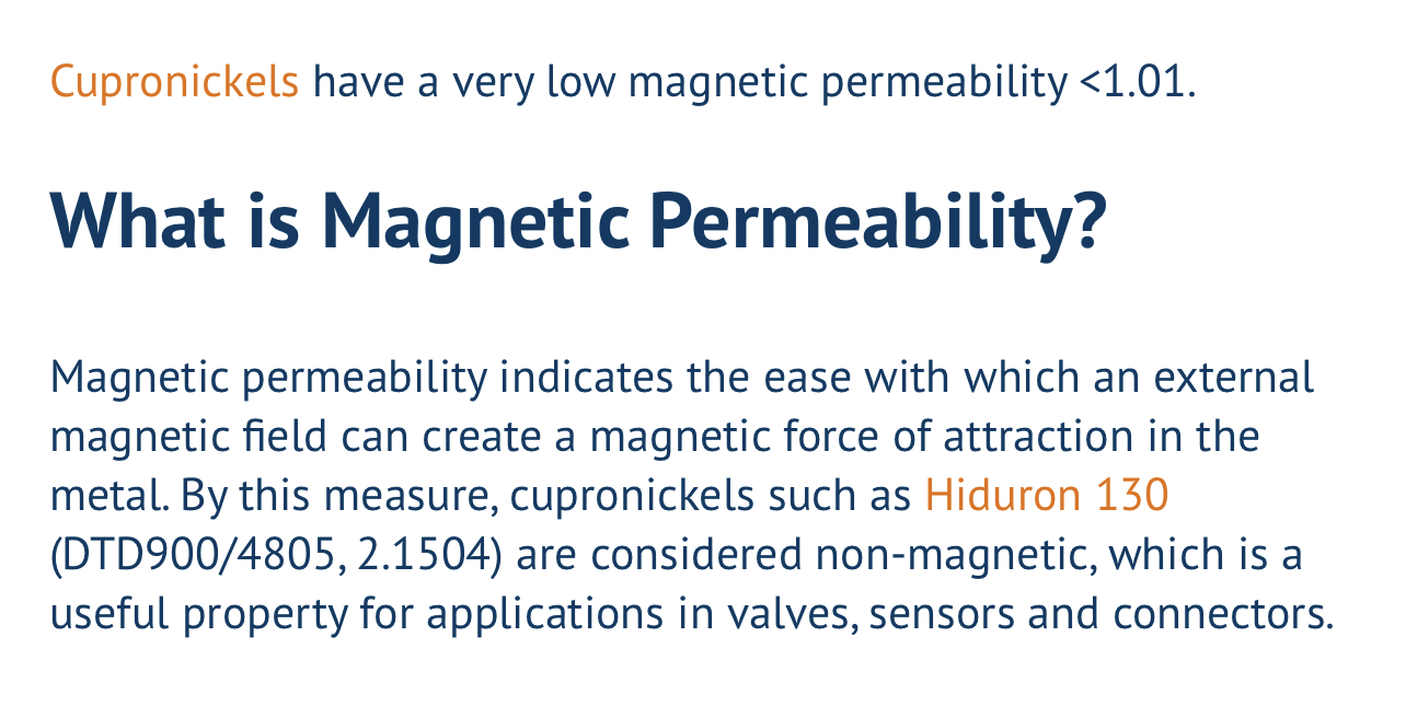

Copper brake pipe that isnt copper, thats the magnetic base of my torch picking the pipe up! before I get shouted at that I shouldnt use copper Ive never had a failure in 40 years, if its clipped and supported properly its fine
The Tri-leva has the long cross slide, but thanks for the heads up.![]()
Often sold and referred to as cunifer (I wonder why...?!
)CuNiFe is pretty rare for brake pipe, mostly 90/10 copper nickel.Brake pipe isn't cupronickel, it's CuNiFe.
Could be copper coated bundy, shouldn't be used as brake pipe as it can be welded pipe.
 Yep its definately copper plated steel, its going back whatever, my bad I should have bought from a reputable seller!Could just be steel pipe with a copper coating to make it look like copper! Check the cut ends I think.
My welding clamps were coated...badly....it scratched off very easily![]()

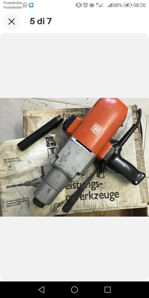

26mm in steel with a hand drill, f'k that!Today I acquired essentially brand new ...
This thing
Fein DSK 672
9+ kgs
1050W
26mm twist drill on steel
32mm twist drill on aluminium
Believe 60mm on dead three carcasses
It should have safety clutch and a monstrous amount of torque
Morse taper 3 spindle
I've always wanted one , never had the luck to find one till now
This thing is over 1600 euros and I've got it for 1/10 of it .

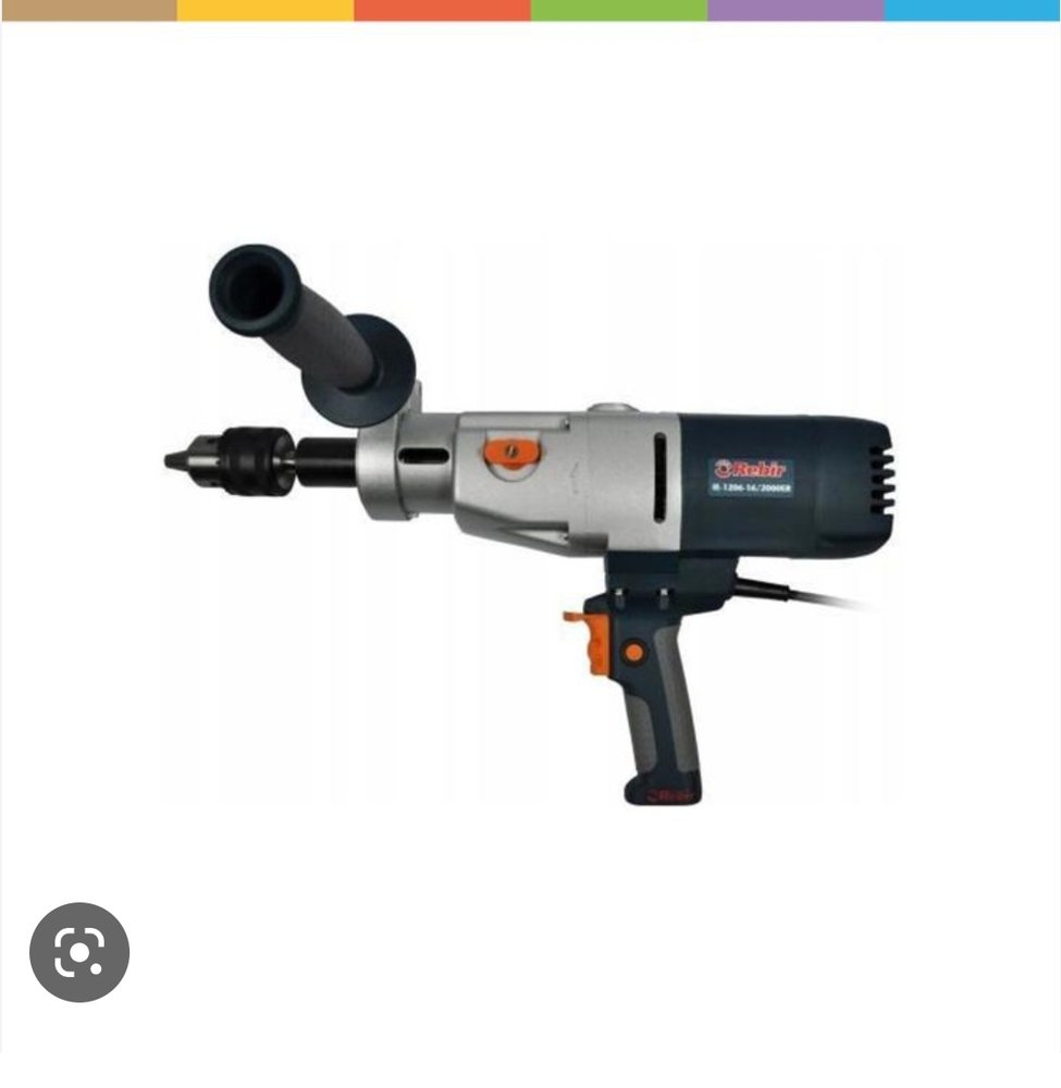

I was planning to get a "cheap" 200 euros rebir Morse taper 2 drill (picture above), and build a line boring rig (we never know I might need it )
Happened to find one of those Fein on the bay ,by looking at the auctions (I seriously need to take a break from them) so I've digit "Fein DSK" and appeared this and other ones .
Italian seller ,read the description,eBay buyer protection, offered a lower price than what demanding , accepted and bought .
Little sad it's not a Fein BOS 32-4 (4 gears version) but it's my first Fein
