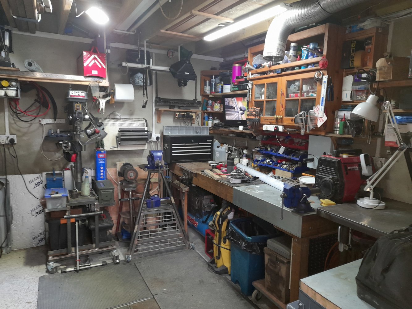

how do you ever work in there theres not even steping stone places let alone a walk way....... this unloved but working Sealey SM5 Bandsaw of 1984 vintage.
Needs a clean at the very least and I dare say benefit from a new blade, but it'll do everything to a level that I'll need & I'll get to practice a bit more making a vice-mount vertical saw plate for it
Been the same in my garage for quite a while. One learns to exhale when squeezing one's way around.how do you ever work in there theres not even steping stone places let alone a walk way![]()
That's just a corner and I'd dragged a small 100L compressor out that was in front of it.how do you ever work in there theres not even steping stone places let alone a walk way![]()

Not quite as cluttered as my first pic suggested.... but you can see why I need stuff on wheelsBeen the same in my garage for quite a while. One learns to exhale when squeezing one's way around.
Not quite as cluttered as my first pic suggested.... but you can see why I need stuff on wheels(including the 6x4 Saw).
You must be very organised and/or much better at being totally disciplined regarding having nothing but essentials in your space!The centre, empty area of your workshop is probably wider than my workshop wall to wall.
Length wise, I've got around 15'. Width wise, it's only approx 5½' wide though, so I simply have to be creative in how/where I store my "treasures".

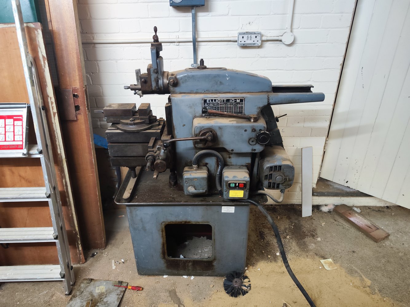

I still have some shaper tooling left, some of which may still be advertised on here somewhere. I've probably got some more too. What are you after?I got an Elliott 10M shaper a few days ago and a small donkey saw (The Benchmaster Senior).
Since I already have a donkey saw (Qualters & Smith) this little one went to my friend.
I am sure I will make a thread on the Elliott 10M soon.
Now, who is hoarding all the shaper tooling?
