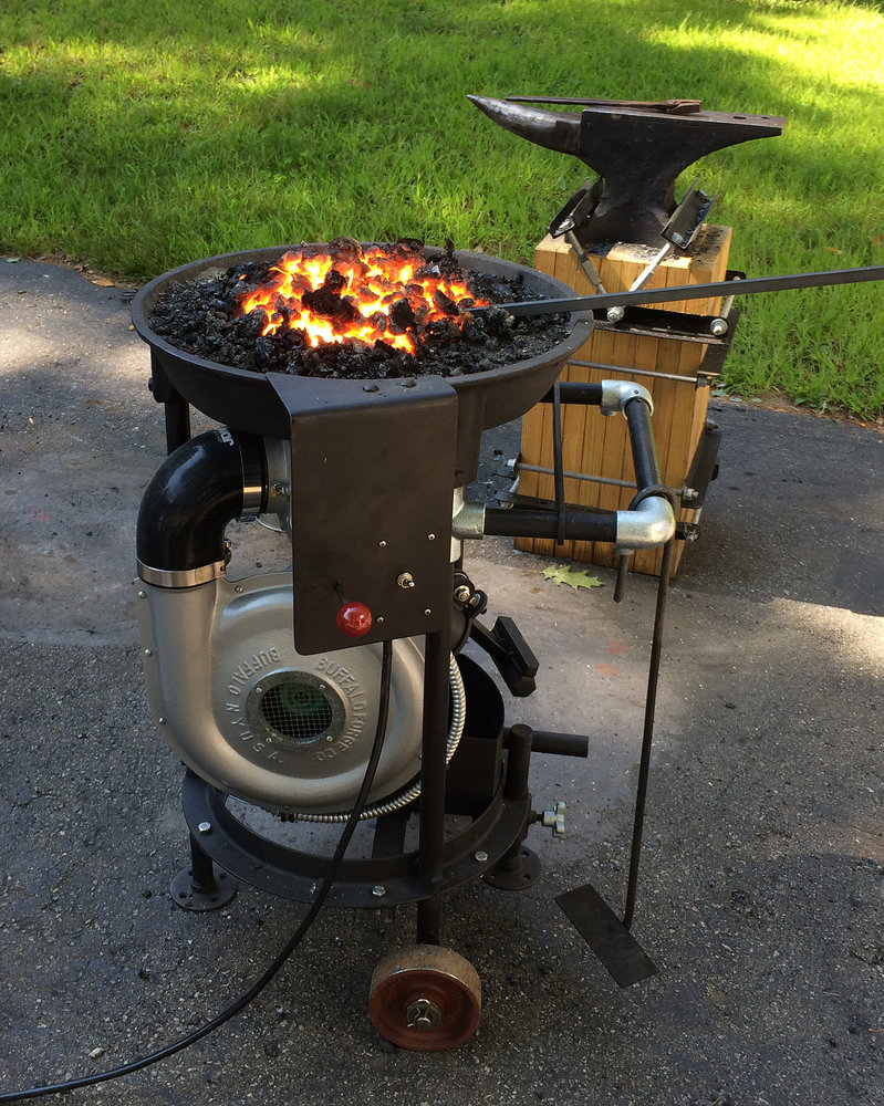

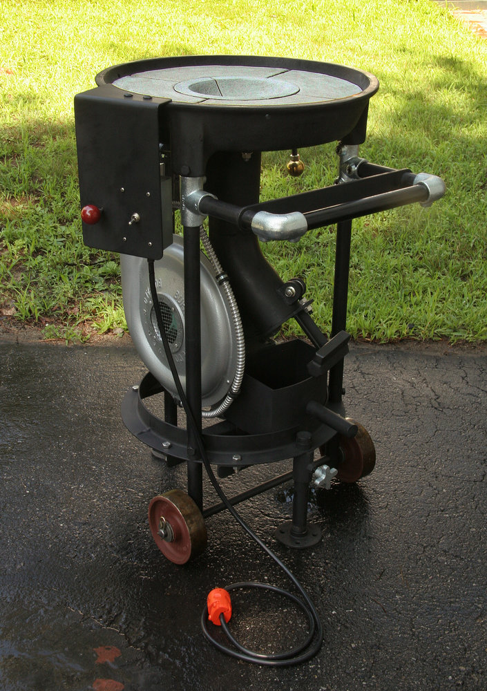

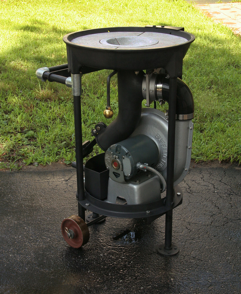

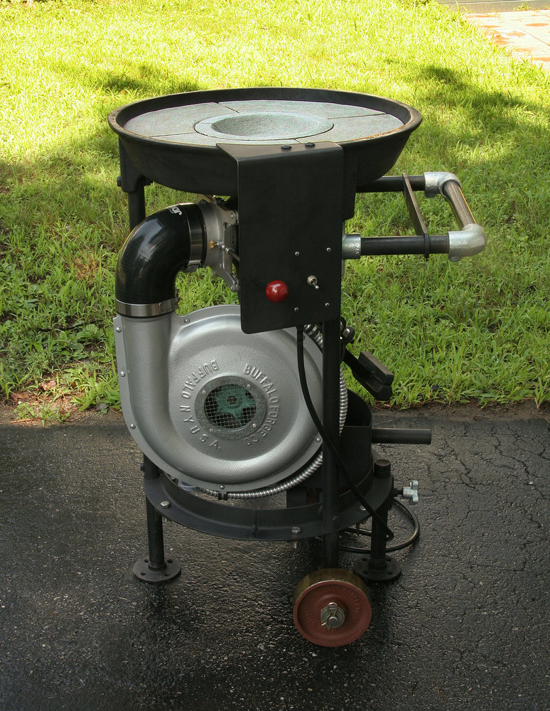

Nice @Blue Chips , I don't think you need the disclaimer, but it's a nice touch.Speaking of blacksmithing coal and coke, I haven't fired up my little solid-fuel forge for a while. I still have a few bags of bituminous blacksmithing coal stashed in the garage. I've never used anthracite. Checking around, the price of what they call 'nut-size metallurgical grade bituminous blacksmithing coal' seems to run roughly between 30 and 40 dollars for a 50-pound bag, which is the pick-it-up-yourself price. It's good stuff for smithing...burns pretty clean and cokes well, but it's not cheap. Bags of coke are a bit more expensive...maybe an extra 5+ dollars per bag. I think that volume discounts would probably kick in to get a much better price, but I don't do enough forging (or have enough dry storage space) to justify a large load.
This is the small solid-fuel forge that I built a few years ago. I found an old cast-iron forge pan for 20 bucks and then fabricated the rest of it myself, including the frame, tuyere, clinker breaker, grate, ash dump, ash bin, air control, etc. I found an old blower that I adapted, incorporating a silicone turbocharger tube to connect it to the air gate. Instead of a clay pan lining, I made some molds and cast the liner segments with Kast-O-Lite castable refractory (following the Kast-O-Lite instructions to the letter). I made 'nested' inserts so that one set could be removed to enlarge the bird's nest volume. It works well, but I've found that my gas forge is much more convenient to use. I might post some images of their construction when I have some free time. I'm strictly an amateur when it comes to blacksmithing, but when I have the time, and when the weather isn't too hot or too cold for using the forges outside, I enjoy pretending that I'm a blacksmith.

That's a lovely portable forge setup!Speaking of blacksmithing coal and coke, I haven't fired up my little solid-fuel forge for a while. I still have a few bags of bituminous blacksmithing coal stashed in the garage. I've never used anthracite. Checking around, the price of what they call 'nut-size metallurgical grade bituminous blacksmithing coal' seems to run roughly between 30 and 40 dollars for a 50-pound bag, which is the pick-it-up-yourself price. It's good stuff for smithing...burns pretty clean and cokes well, but it's not cheap. Bags of coke are a bit more expensive...maybe an extra 5+ dollars per bag. I think that volume discounts would probably kick in to get a much better price, but I don't do enough forging (or have enough dry storage space) to justify a large load.
This is the small solid-fuel forge that I built a few years ago. I found an old cast-iron forge pan for 20 bucks and then fabricated the rest of it myself, including the frame, tuyere, clinker breaker, grate, ash dump, ash bin, air control, etc. I found an old blower that I adapted, incorporating a silicone turbocharger tube to connect it to the air gate. Instead of a clay pan lining, I made some molds and cast the liner segments with Kast-O-Lite castable refractory (following the Kast-O-Lite instructions to the letter). I made 'nested' inserts so that one set could be removed to enlarge the bird's nest/fire pot volume. It works well, but I've found that my gas forge is much more convenient to use. I might post some images of their construction when I have some free time. I'm strictly an amateur when it comes to blacksmithing, but when I have the time, and when the weather isn't too hot or too cold for using the forges outside, I enjoy pretending that I'm a blacksmith.
My standard disclaimer: I am not a professional blacksmith. I do not guarantee the safety, efficacy, or applicability of any of my designs or ideas that I have described here in this thread. Any use of my designs or ideas is entirely at your own risk.
Thanks, Dan. I wish I had more free time to play with it (and some other toys).That's a lovely portable forge setup!
