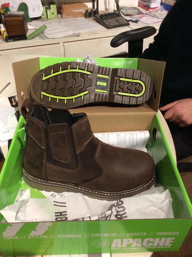

What have you done to the poor boys fingers?!At £35 ,the most expensive boots I’ve had for some years!

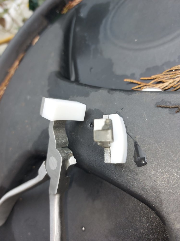

After seeing them recommended on here I bought a pair of the Piergiacomi flush cutters on Amazon.
I went for a larger set as they can cut 2.5mm & were on offer. Unfortunately the 2 cutting edges don't meet properly with one edge sliding over the other when squeezed hard.
So they are heading back to Amazon for replacement.

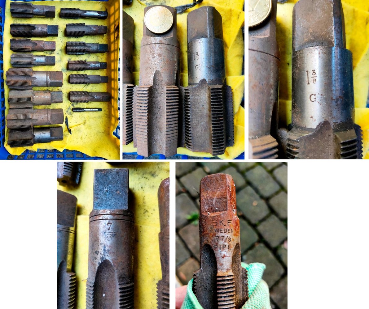

Morning!
Question for the forum:

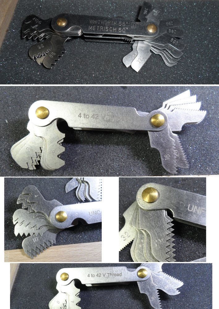

I have been offered taps in inch sizes where only the diameter value is given, but no indication of the pitch.
Is there a standard correlation between diameter and pitch in inches if any additional information is missing or do I at least have to know the system (BSW, UNC, UNF, etc.)?
These are the sizes: 1-3/8", 1-1/2", 1", 7/8", 7/8" Pipe, 3/4" - the pictures look like pretty fine thread to me, may be the size is deceiving though ...
Thank you.
Carsten
I think the "G" denotes BSP thread.
They're BSP / Pipe ThreadMorning!
Thank you.
Carsten

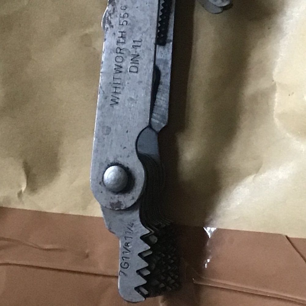

Oohh, my whitworth thread gauges have a ‘G’ on them.
As indicated by the G
my money is on all of them will be bsp
Time to start using those gauges on the unmarked ones then and see if the thread counts match a BSP chart.

As I understand it the EU has adopted BSP thread sizes for pipe threads so they directly equate to your 'G' threads, (though the 'G' on your taps probably actually relates to GAS as they probably pre-date the EU adoption).That could be a problem, for me it's not much more than a "nice to have", the guy thinks he has quite the good stuff - I didn't wanted to open his eyes unneccessary
Carsten
I asked the supplier: Some of the taps have marks like S, R, SS - does that mean anything?
The German DIN standard I'm certain is BSP.As I understand it the EU has adopted BSP thread sizes for pipe threads so they directly equate to your 'G' threads, (though the 'G' on your taps probably actually relates to GAS as they probably pre-date the EU adoption).
