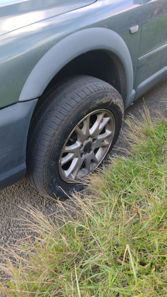

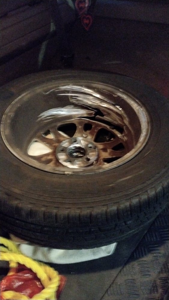

Almost certainly not torqued or even tightened the last time the wheel was re-fitted, look for signs of fretting on the hub, wheel mount face and around the taper on the bolt holes, if they fell out it would probably have been a slow process,Definitely a close shave on the wheel...I can't work out if 4 out of 5 bolts fell out or were "removed".
The alloy wheel didn't survive...I'm 100 miles from home so local garage will be checking for other damage in the morning.

It's all a bit odd...I'm wondering if it happened over a long period maybe.Almost certainly not torqued or even tightened the last time the wheel was re-fitted,
