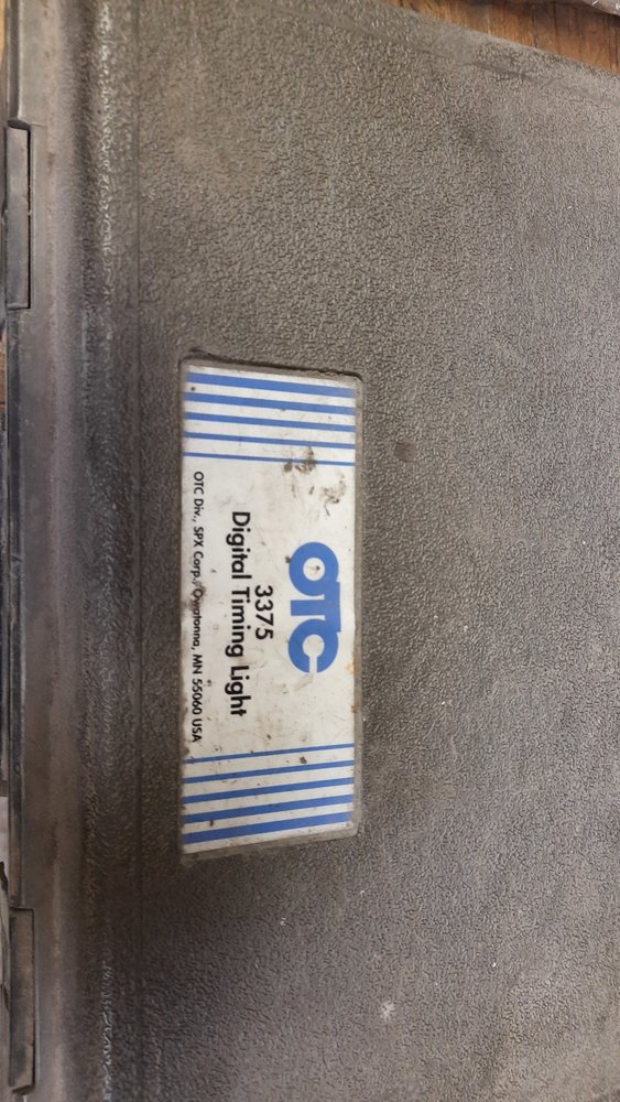

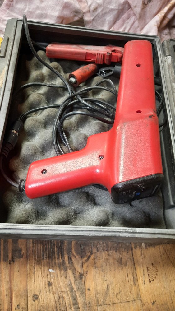

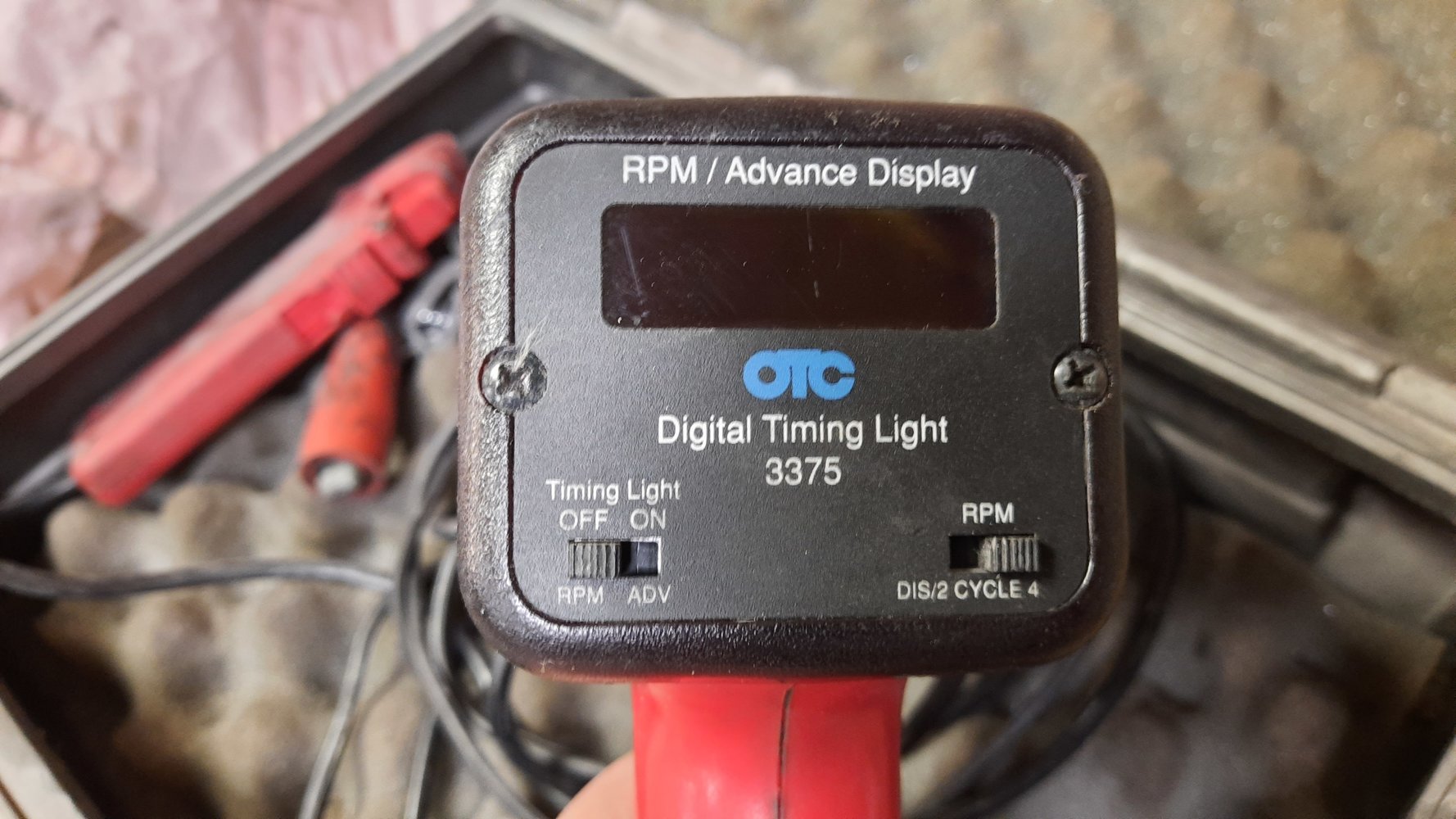

If you get your blink rate at the correct frequencies, the light stays onA timing light to play about with but it must be faulty as it keeps flashing when the engine is running
