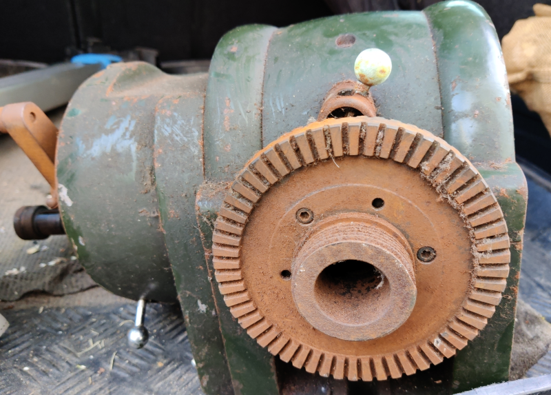

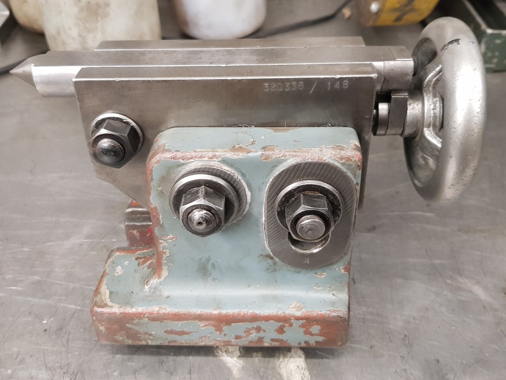

When its level, does it reach anywhere near the level of the split in the dividing head? Or is it lower/higher?A few more piccies of the £30 dividing head (still in the boot of my car)...

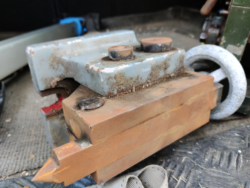

Rusty spindle nose. The direct indexing thing has two sides, one with 60 (I think) teeth and one with 56 teeth. I guess the 56 tooth side is most useful for dividing into 8 or 28? I can't imagine many times I'd need to divide into 7, 14 or 56! Centre height seems to be about 120 mm so probably 4¾".

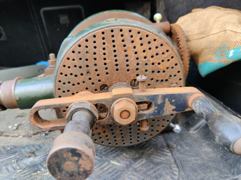

One dividing plate, but the sector arms are missing so I'll have to make some I guess.

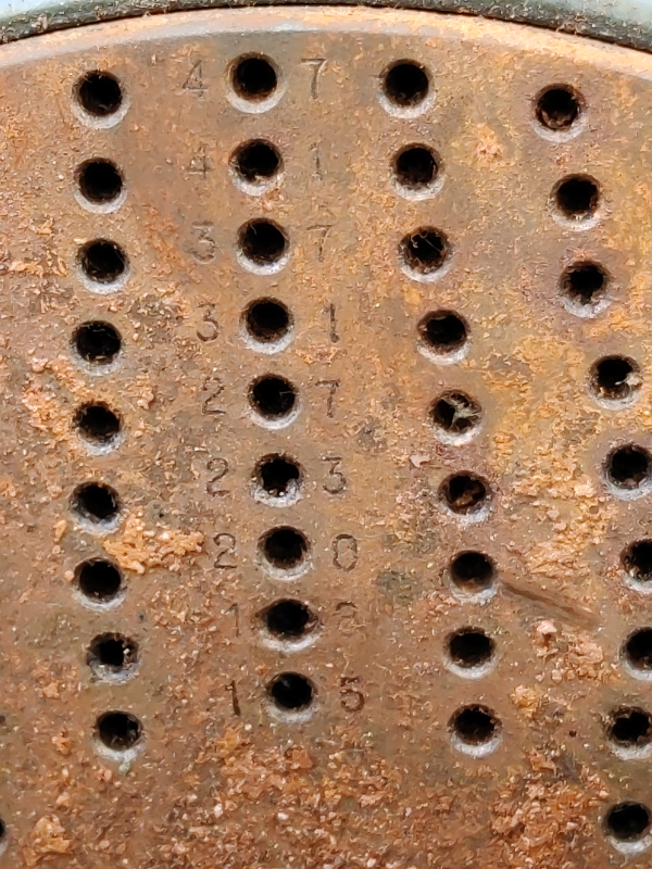

Despite the rust, the hole counts are still visible:

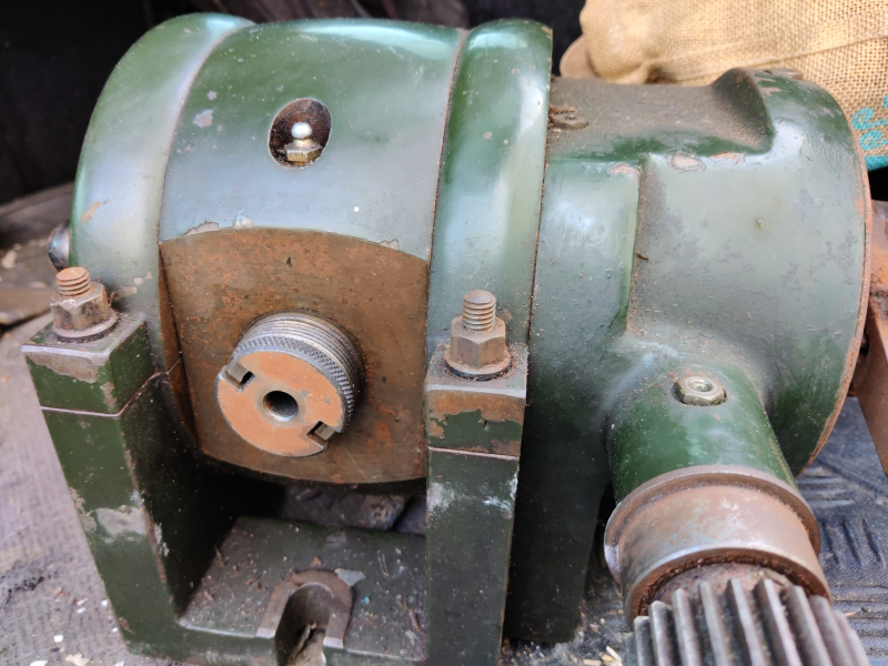

I haven't completely figured out this end yet:
I've worked out how to engage and disengage the various drives (for worm input, gear input or free-turning for quick indexing), but I haven't figured out what that knurled thing is on the back of the spindle. It keys into the dogs on the spindle, so can't turn and I can't budge with gentle pulling force. Any ideas what it's supposed to do?

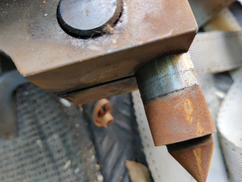

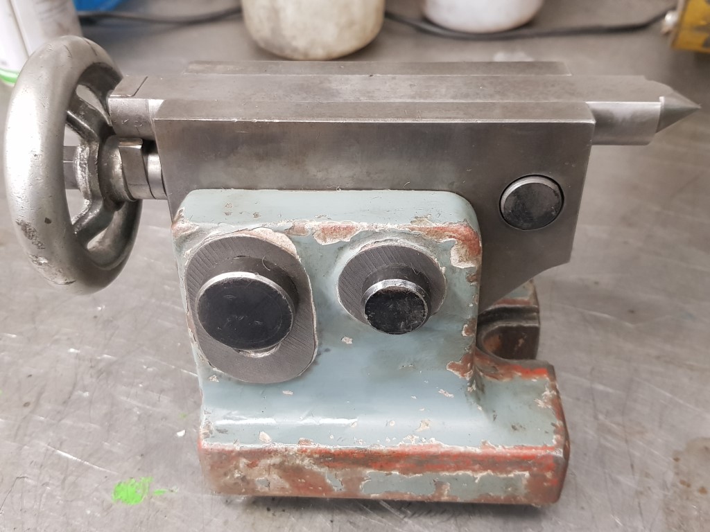

The tailstock looks to be from a completely different dividing head, but it moves smoothly despite the rust and, when the handle's turned to extend the centre a bit, the bit that wasn't exposed looks alright:
Re that knurly nut, it should come out to reveal a machined internal - parallel or taper.
