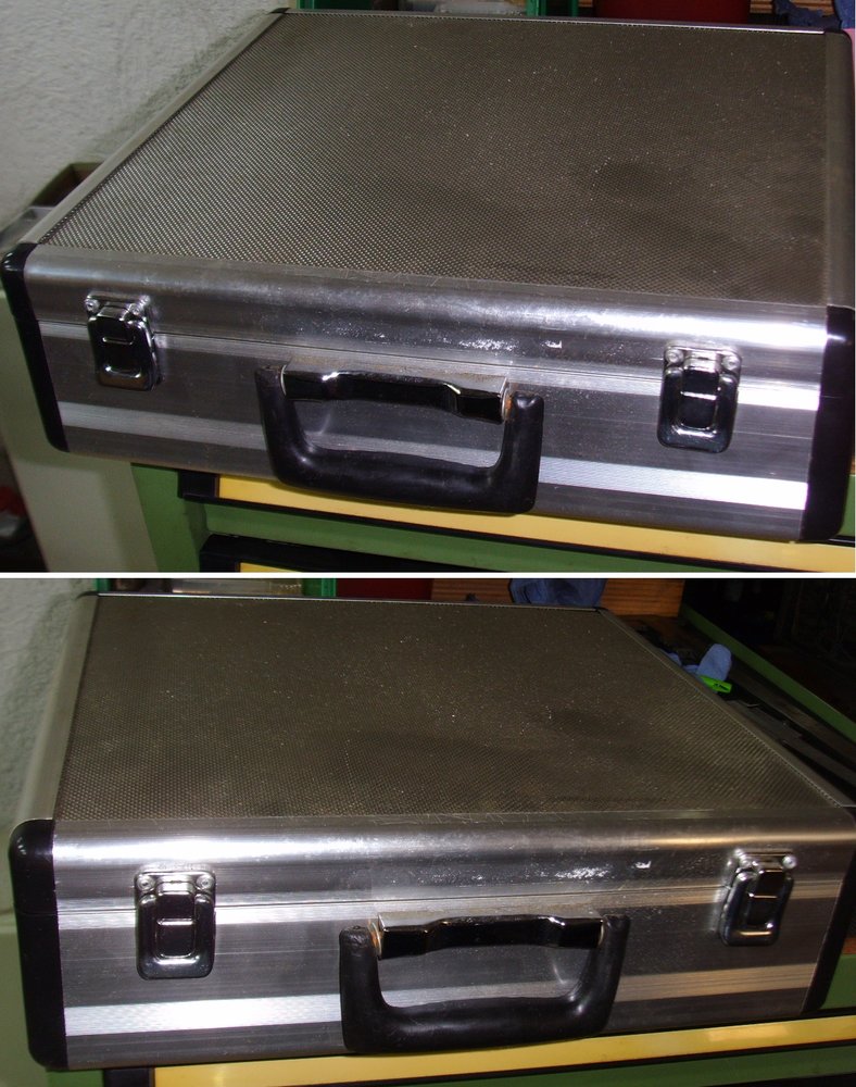

And then there came an alu-case with some weight my way:
containing this:

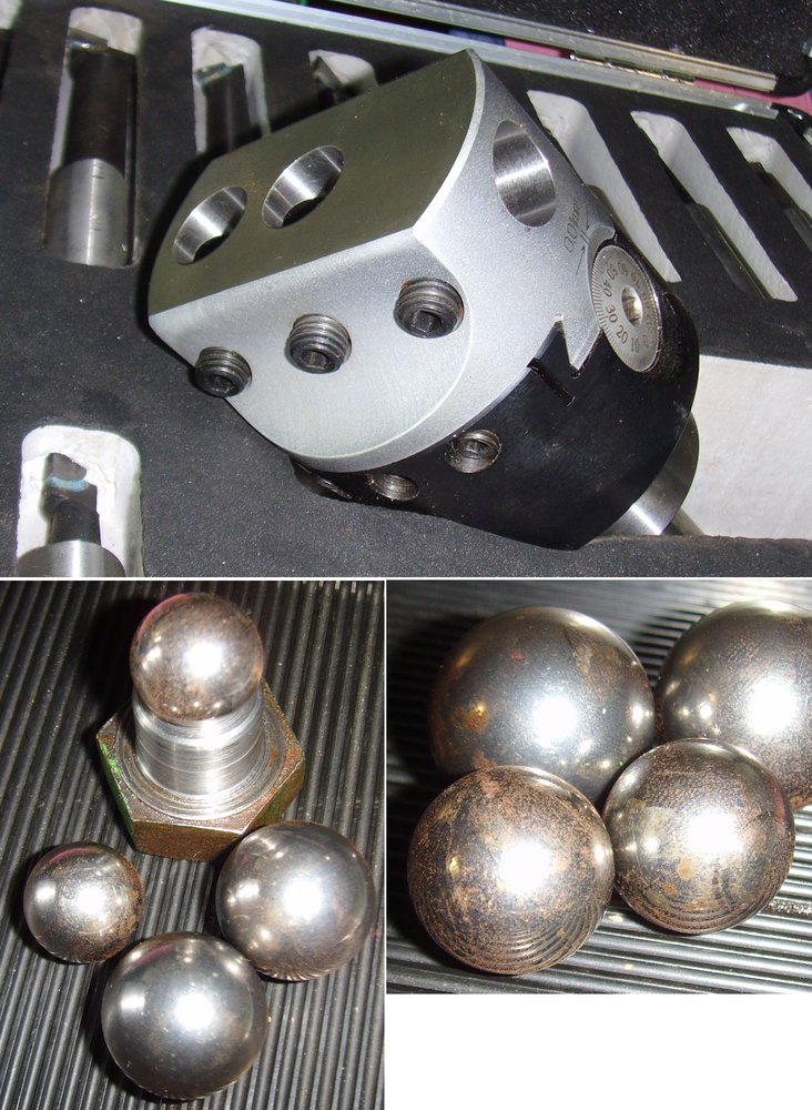

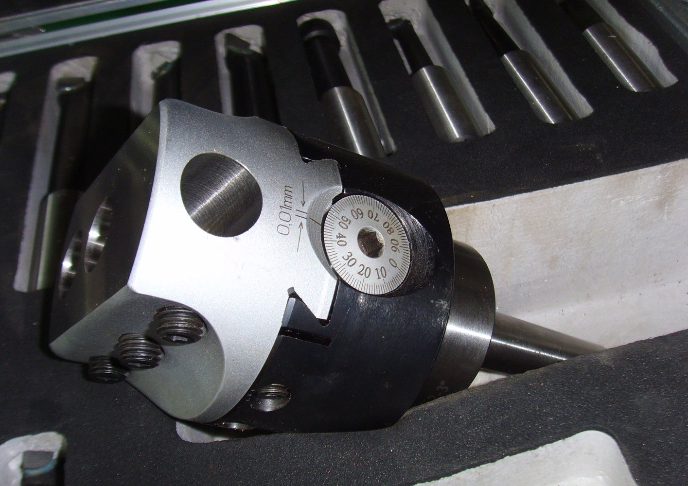

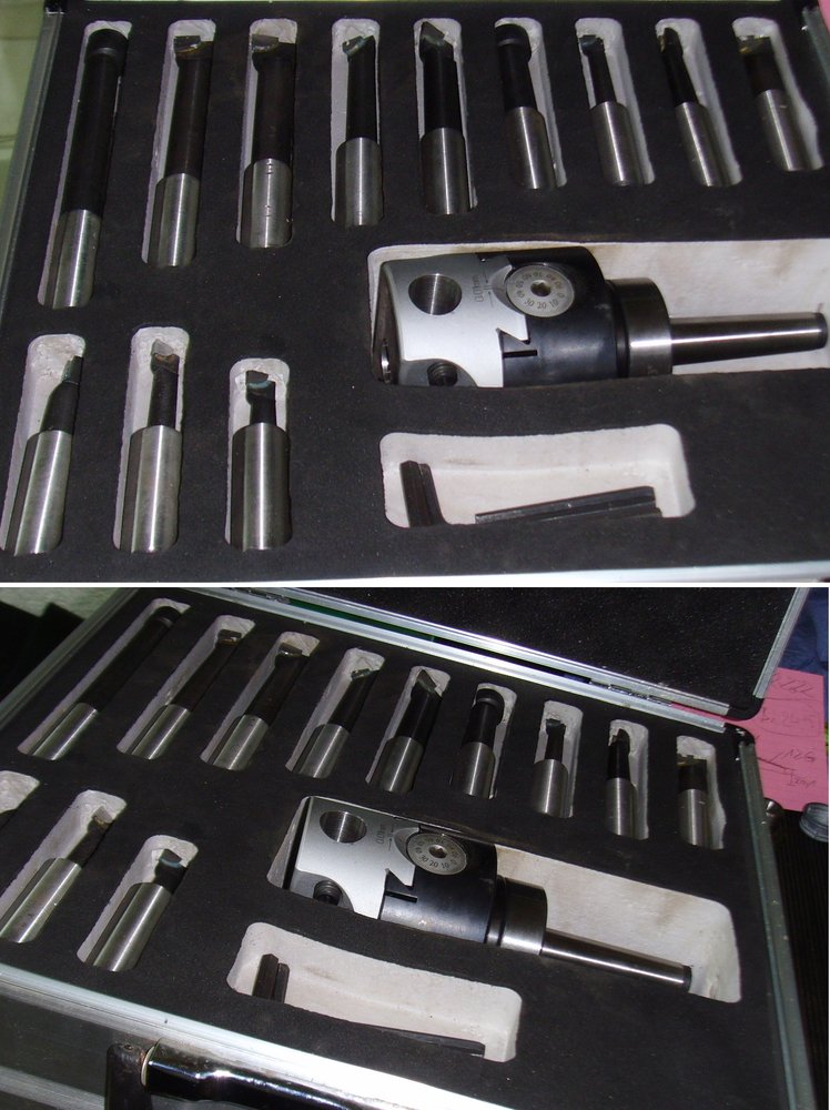

Those who have been paying attention know that I have a very serious boring head with MT3 for my Arboga; this one - of far more moderate quality caliber - in MT2 fits on the small Myford and is there to help in the future in its very own way.
I've learned that to intentionally turn a taper, you don't necessarily have to de-adjust the tailstock - getting that back in line I find quite annoying - you can also just use a boring head in the tailstock to make the lateral offset finely adjustable without disturbing the base-adjustment of the tailstock.
If one needs then also still flatter cones, more than between two tips are to be manufactured safely. one can turn also between balls, if one made itself some appropriate holding stumps - therefore also some steel balls:
