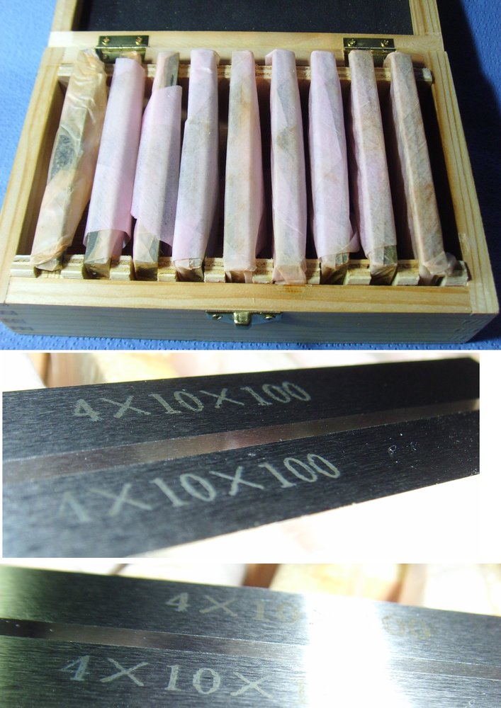

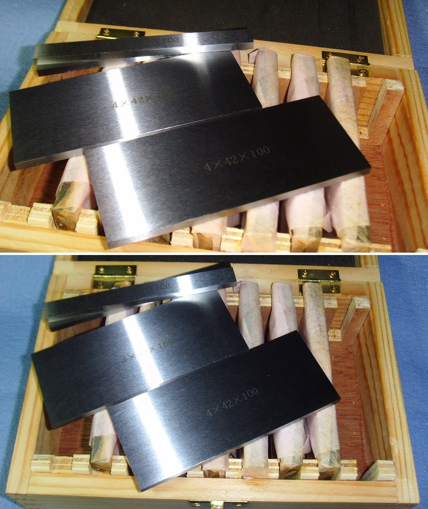

Today I have once again aquired what I have earned ... now that the little Myford is able to do more - or rather, I have learned to use it a bit better - more stuff was needed again.
And I got what I paid for ... the box already gives away the origin
A set of parallel underlays, or what do you call them?!?!
Parallel supports 100 mm, Width 10, 14, 18, 22, 26, 30, 34, 42mm
Thickness: 4mm; Parallelism: in pairs Tolerance IT 5 according to DIN 7168; Accuracy: DIN 2768; Accuracy class: f (fine); Hardness: 58+/- 2 HRC
Whatever may be true of it.

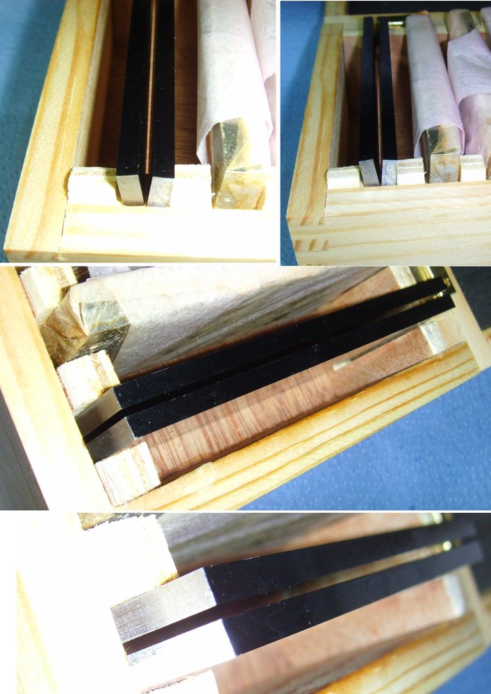

So far I have only unpacked two pairs, nothing daunting at first sight, but no sublime quality either ....
I haven't looked at squareness and parallelism yet (but that shouldn't be soooo difficult, should it?), but the edge treatment - or lack of it after grinding - is not at all convincing.

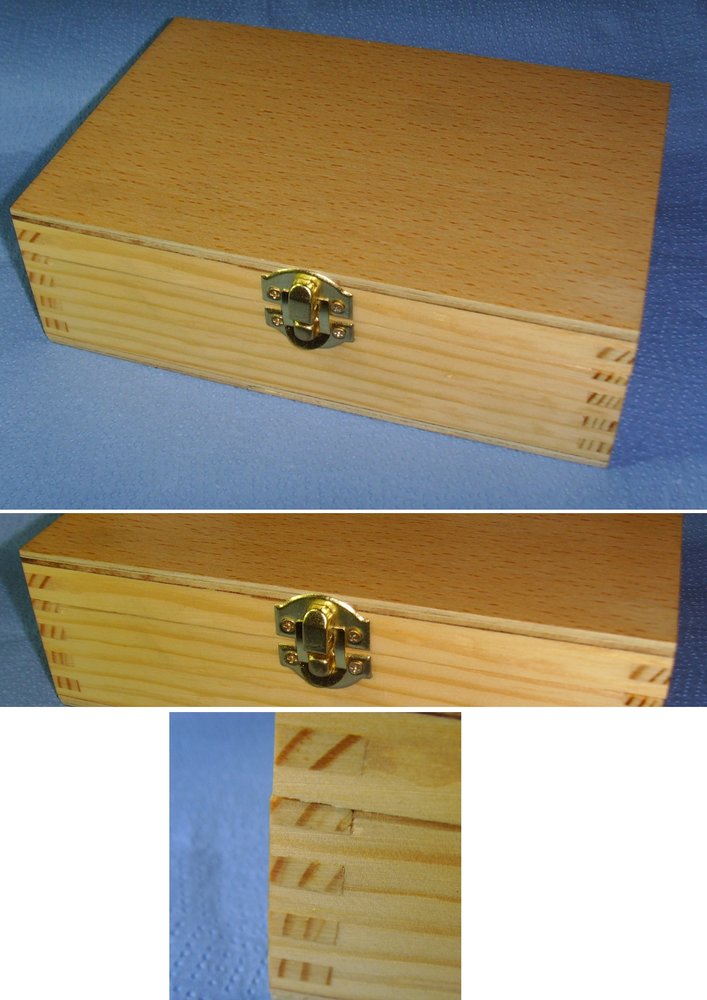

And of course the storage notches in the wooden box, which were already not very suitable for shipping, after the removal of the wrapping paper, are no longer suitable for the parallels ... everything is flapping around.
So I got what I paid for (probably a little less) but what I needed in used, old and good was not to be had.
Good night
Carsten
