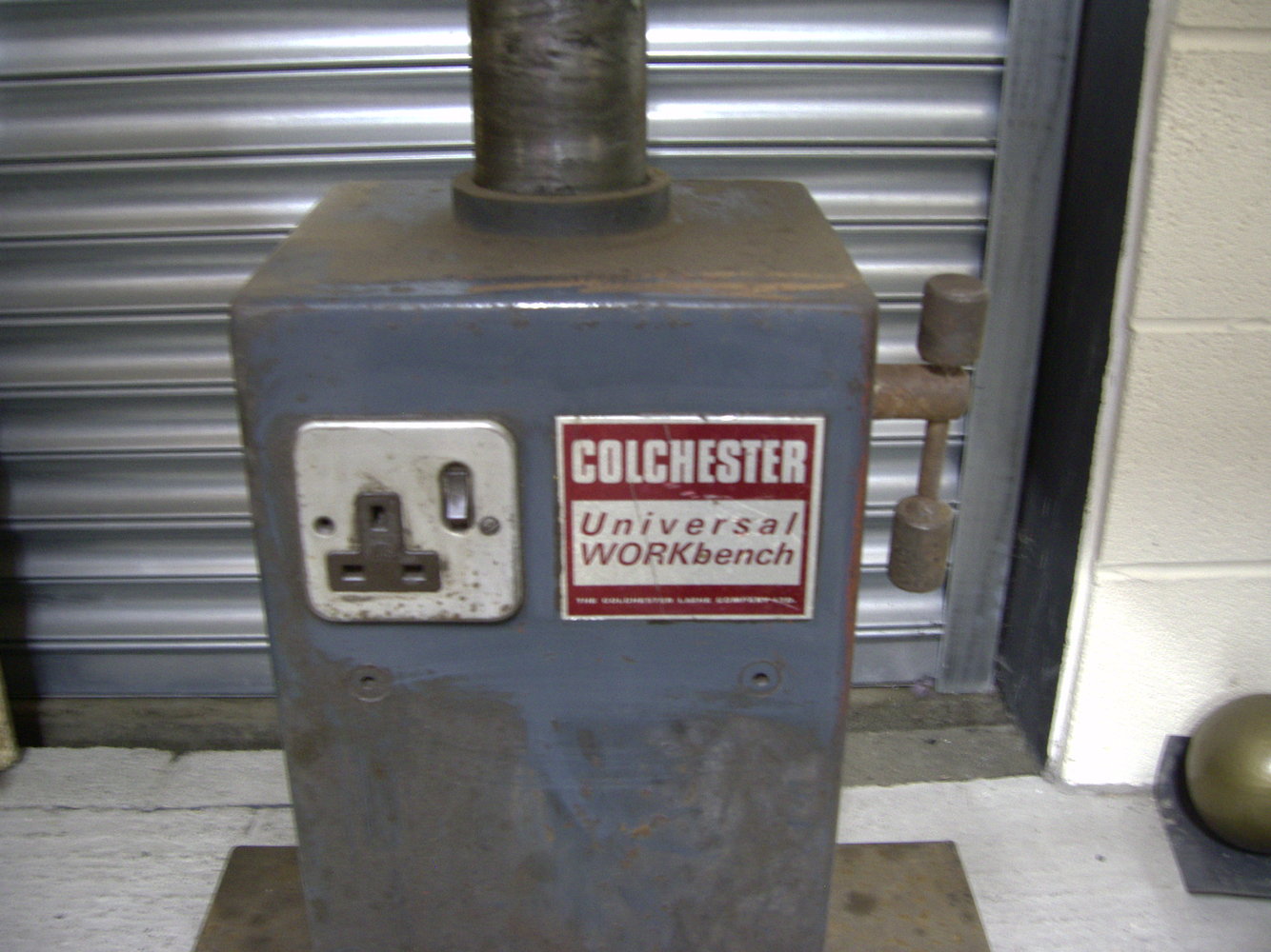

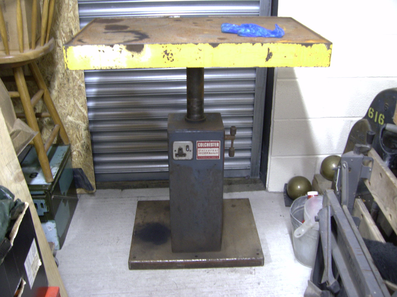

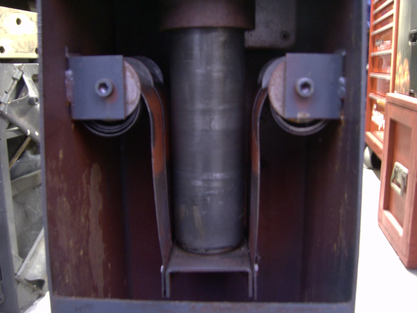

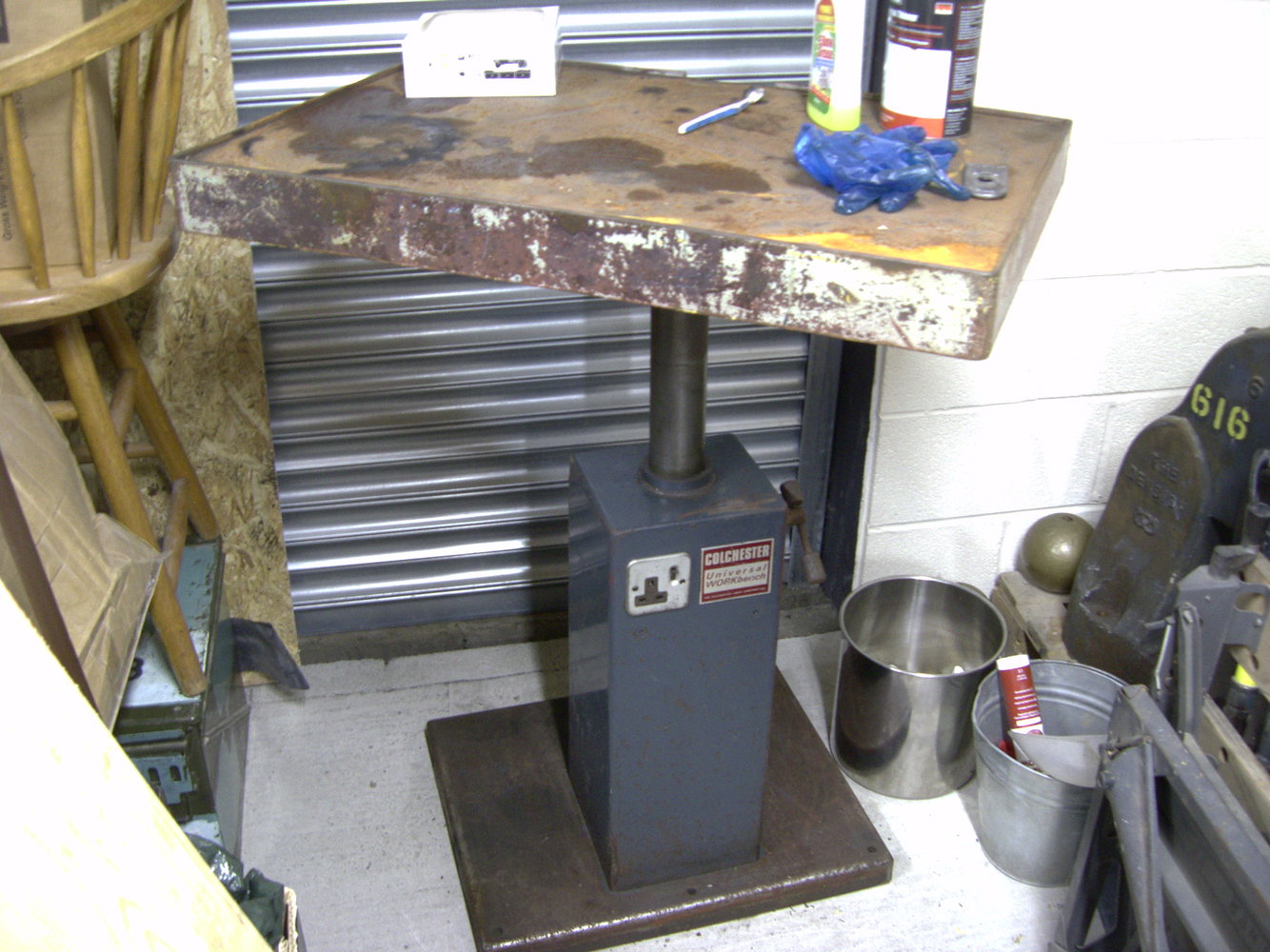

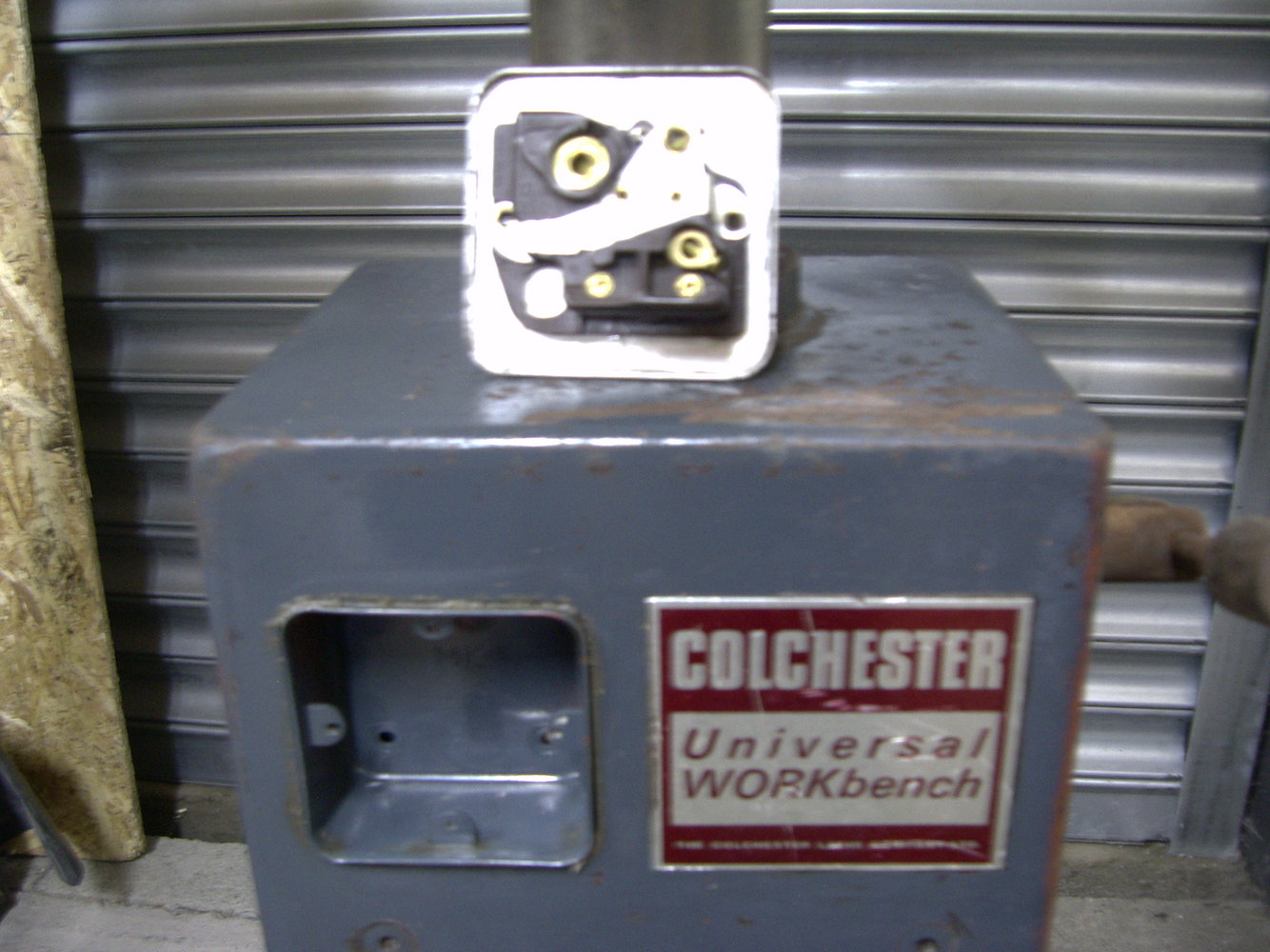

.....................The cranking mechanism is a little stiff, and needs a new extension cord for the 240v receptacle. .........................................
View attachment 323463 View attachment 323464

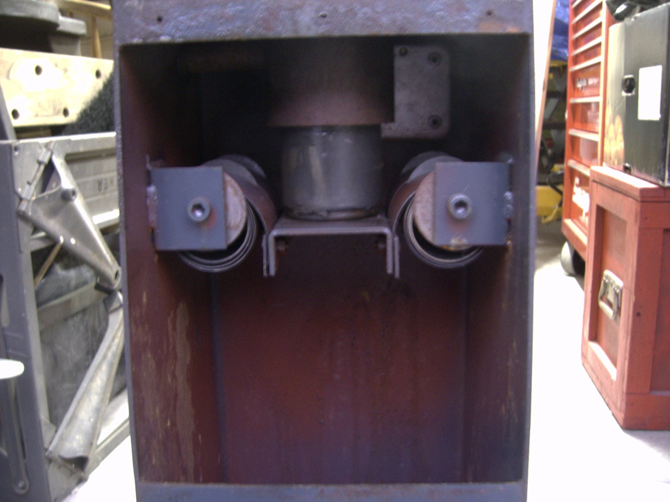

I started to refurbish the the workbench today, and after taking the access plate off of the back of the stand I discovered there wasn't a cranking mechanism, but a spring assisted setup to act as a counterweight for manually adjusting the height. Its much simpler to use and also allows the table to be rotated 360* to the left or right. The handle on the side actuates a clamp which holds the pillar in position. The height is adjustable from a low of 31" to a maximum of 45". I also noted that there was no sign of the electrical outlet ever being hooked up. Also, there are no holes in the electrical box to allow wiring to be routed either. Here are some photos from today.Thats nice, how does it raise up and down?
