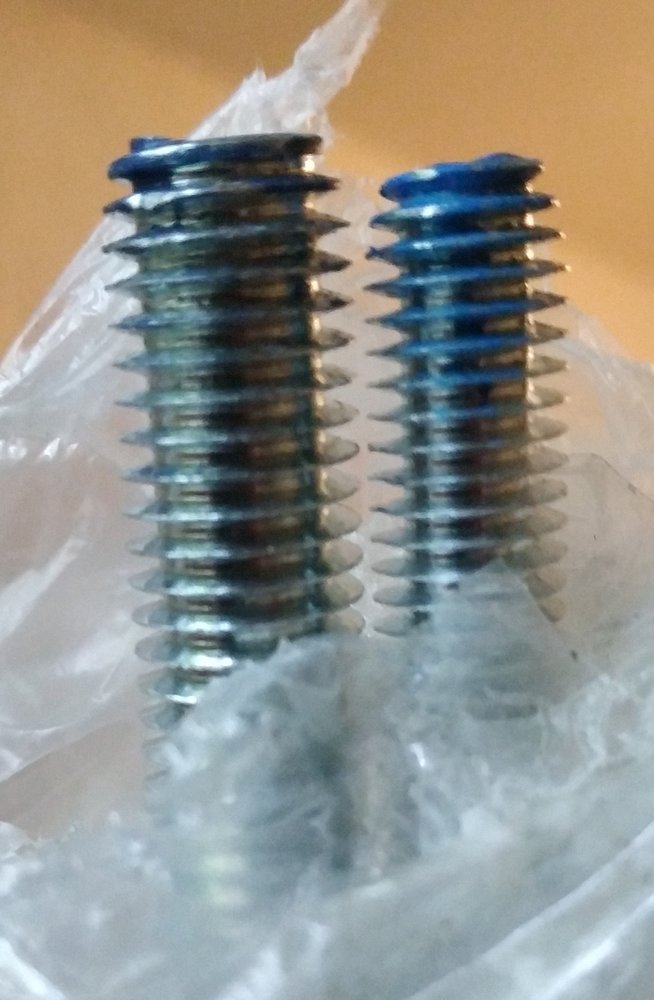

Phoned up toolstation and they sent some more out.. 10 months later it is the same.Long ago aquired some m8,m10 and m12 studding from toolstation. It was cheap and *will* be needed eventually. Today.
Today aquired.. the knowledge that it is poo! A close look the OD is correct, the pitch is correct, but it looks wrong. Minor diameter on m10 is about 6mm, because the thread angle is 15/30 degrees.
Nope, I will not be using that to hold a heavy thing to a spinny thing
Concerning that somone has gone to some effort and stupidity to make/buy the tooling for these, to be made on a massive scale in China, then sold to a big shop (different months and different branches). How much stuff is bolted together with this?
