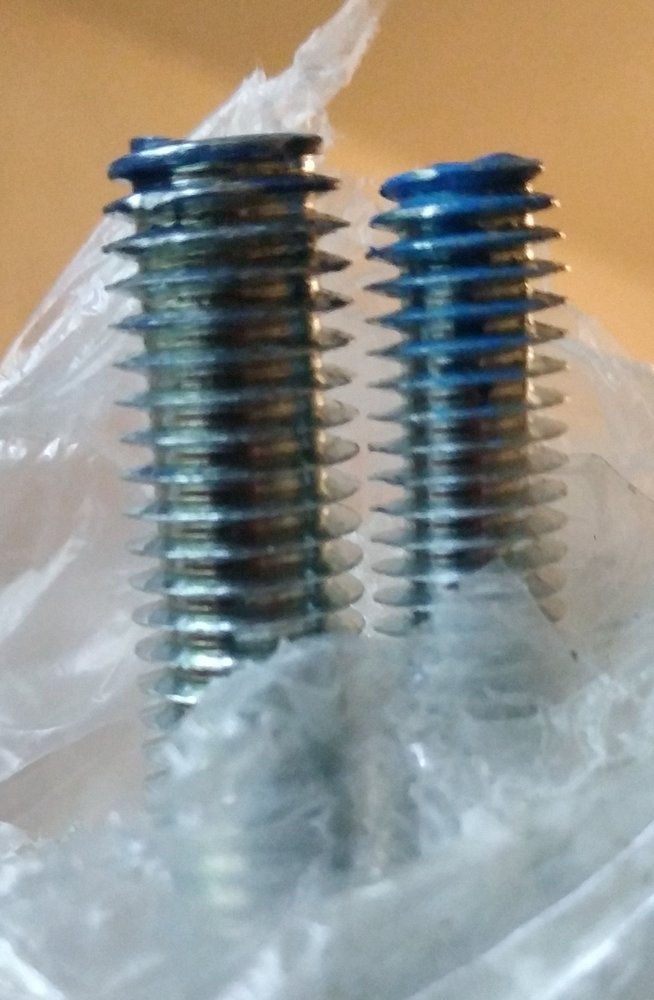

Phoned up toolstation and they sent some more out.. 10 months later it is the same.Long ago aquired some m8,m10 and m12 studding from toolstation. It was cheap and *will* be needed eventually. Today.
Today aquired.. the knowledge that it is poo! A close look the OD is correct, the pitch is correct, but it looks wrong. Minor diameter on m10 is about 6mm, because the thread angle is 15/30 degrees.
Nope, I will not be using that to hold a heavy thing to a spinny thing
Concerning that somone has gone to some effort and stupidity to make/buy the tooling for these, to be made on a massive scale in China, then sold to a big shop (different months and different branches). How much stuff is bolted together with this?

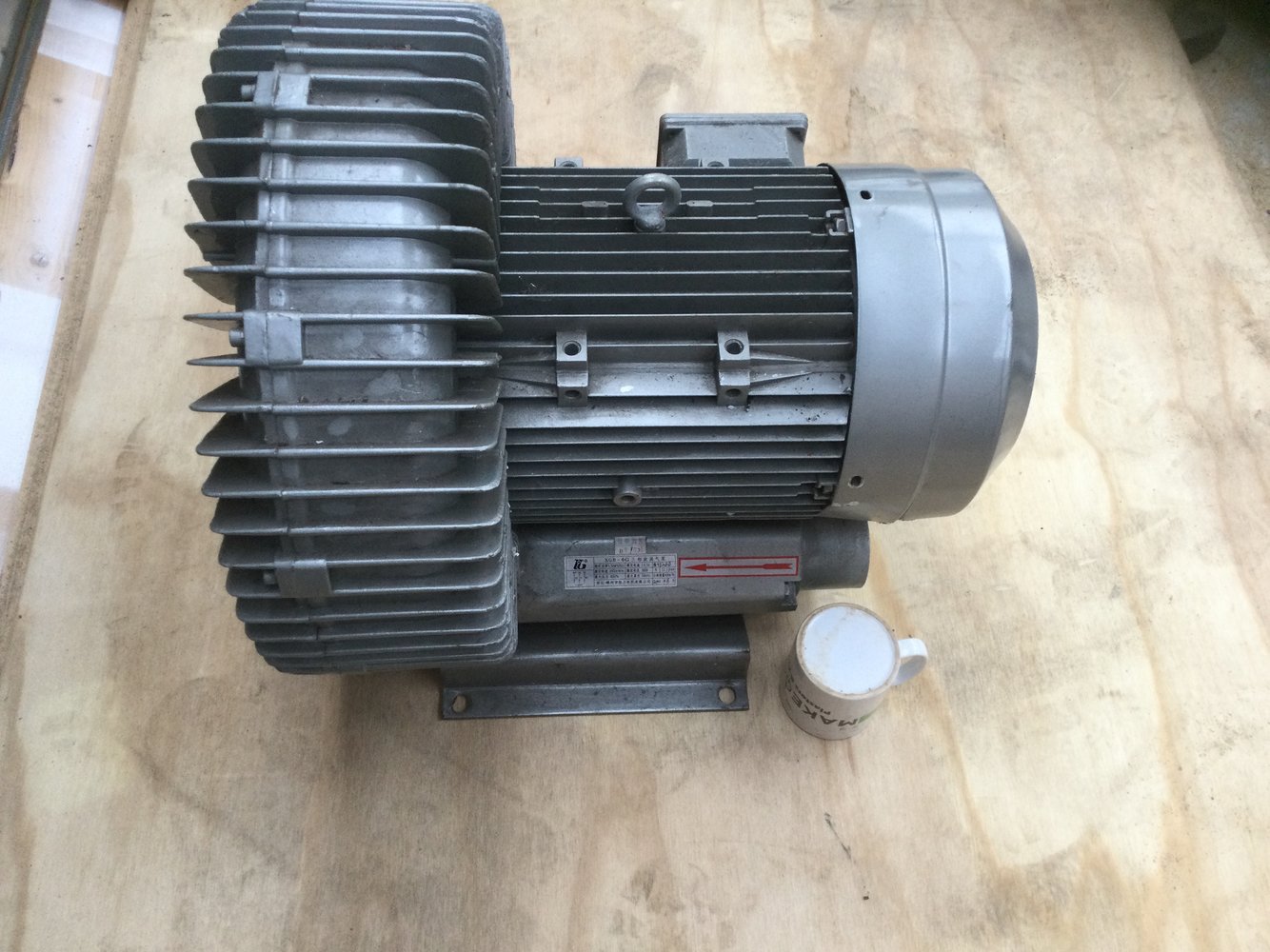

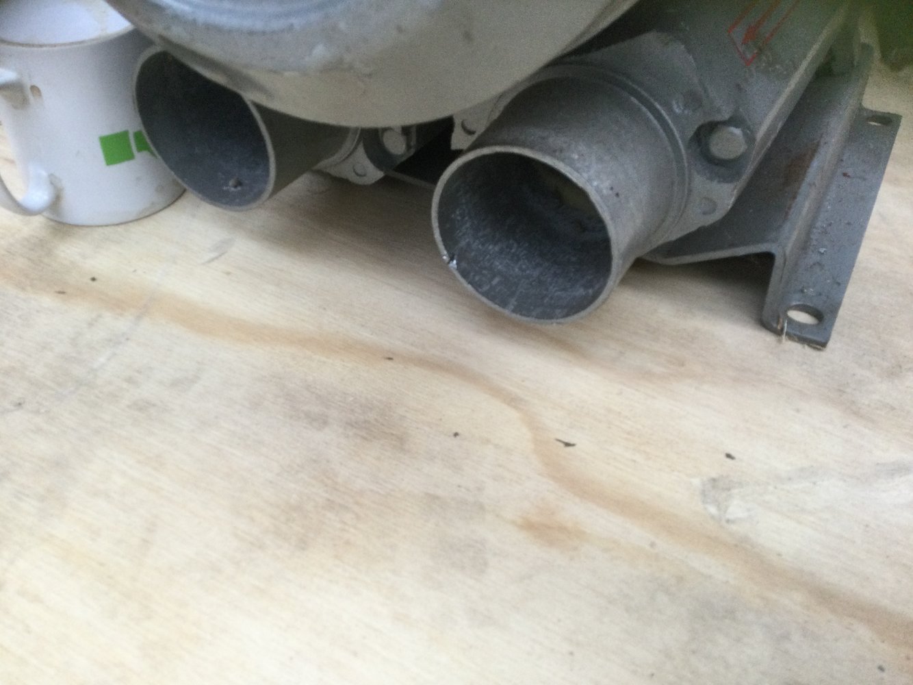

Looks like a Reitschle side channel blower, Part of Gardner Denver now. They are good things but can be prone to seizing if the bearings are a little worn. They are all ally and pick up horribly if the fan contacts the stator. There are foam lined tubes inside the inlet and outlet which act as silencers. These can break up and blow bits of foam out. They are most commonly used as aeration blowers on sewage treatment plants.Today I acquired one of the vac units for my flowbench via a cheeky bid off the bay of thieves
I have some carbide tools on order too, will be interesting to see how they compare, the diamond tool holder tooling is Crobalt, so a step up from HSS.I think you cannot buy just the bearings any more, you have to buy bearings & a new spindle as a set and they're not cheap!
