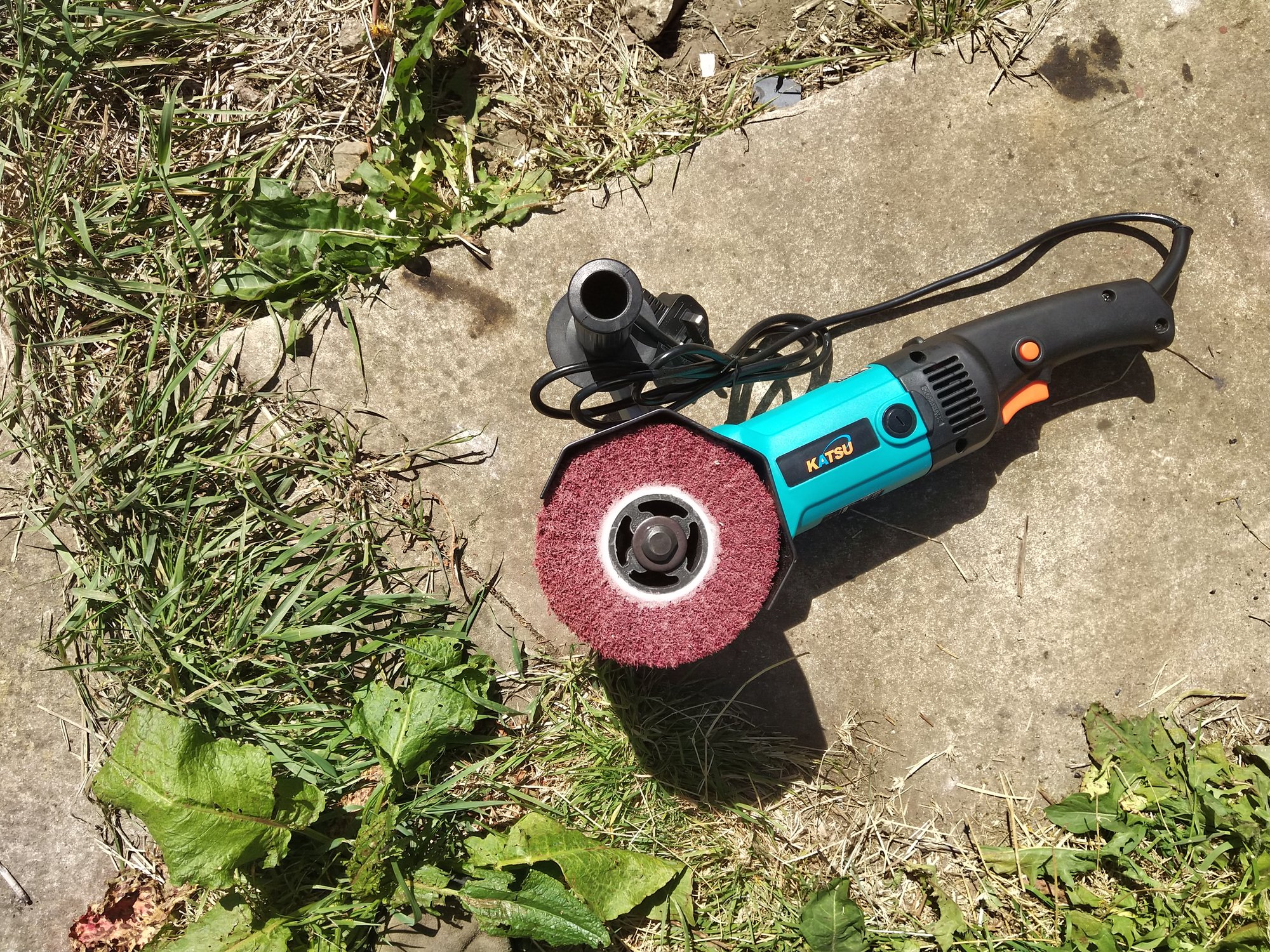

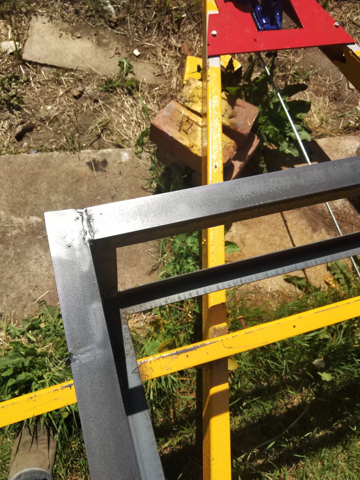

Katsu "wide burnisher"
£60 off the bay, and delivered overnight.
Heavy and seems well made.
Its bigger than i thought! More like a light 9" grinder, than a 4.5".

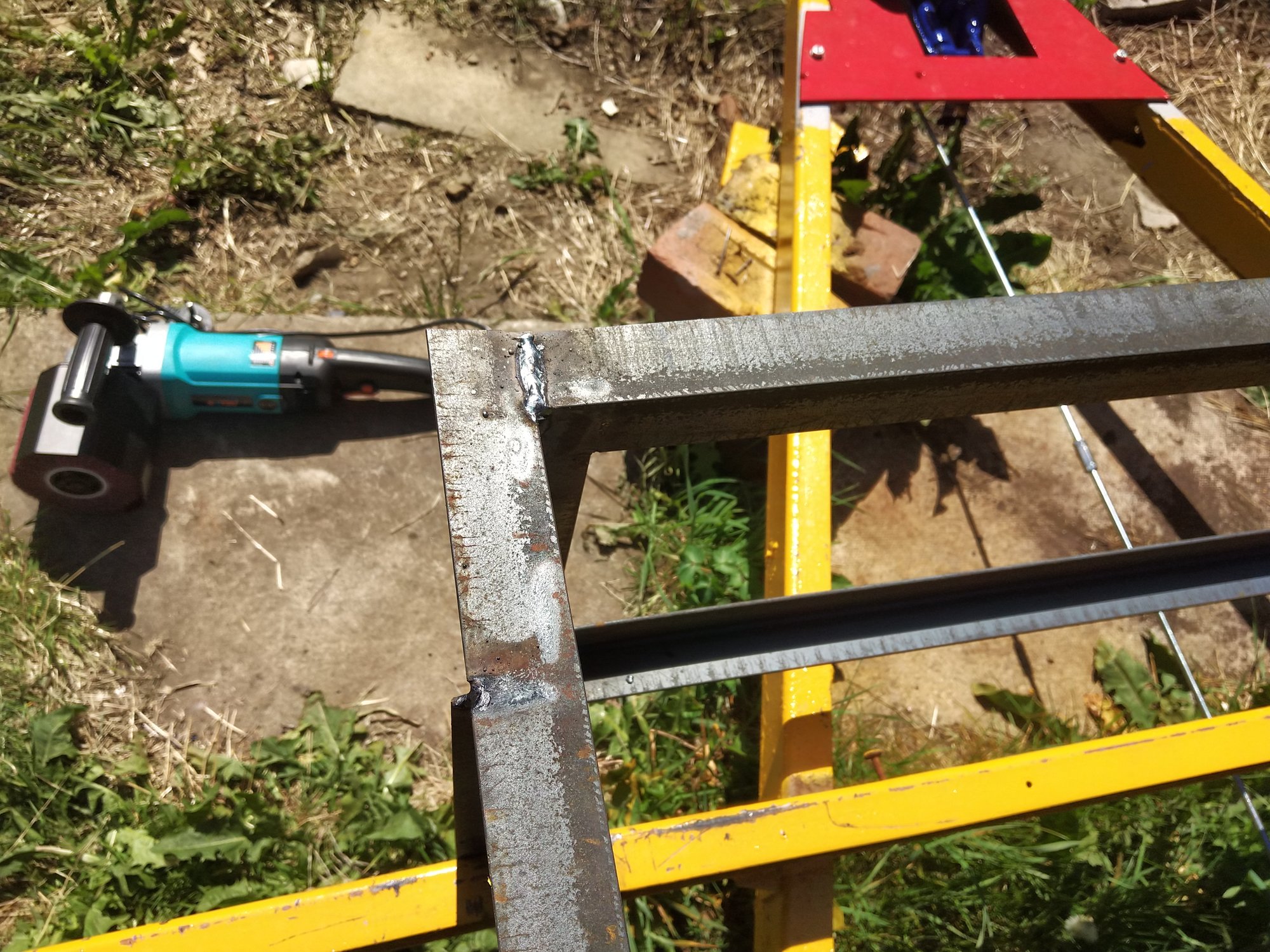

First run.
Before
After:
Cleans off mill scale and light surface rust, but it won't clean weld slag or even paint off - and the wheel wears down quickly if you catch an edge.
I reckon that i'm going to need a new wheel by the time i've finished the trailer.
Much faster than a polydisc or wire wheel within those limits, and it could be a factor of the supplied wheel.
