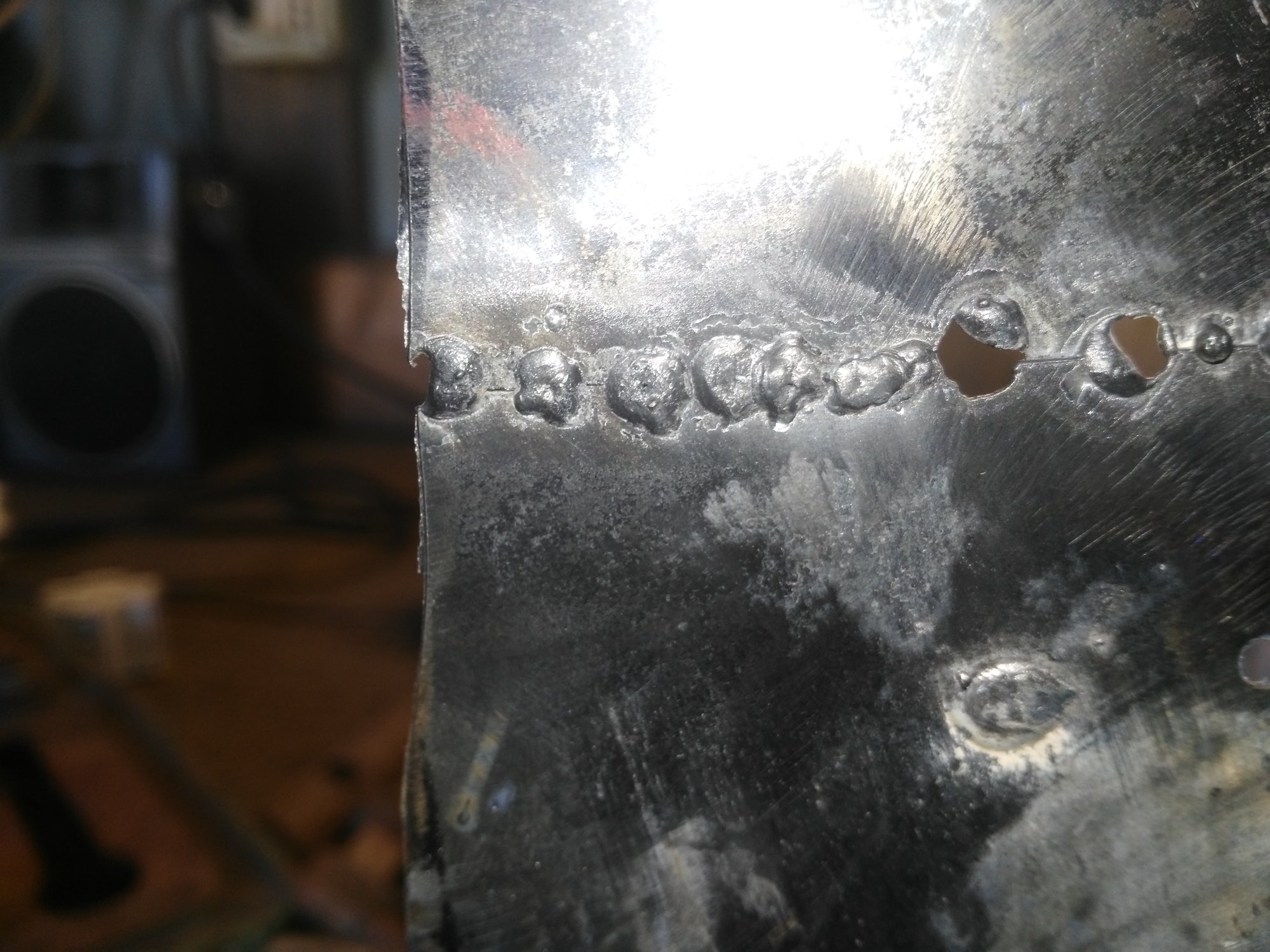

With this "dimmer" you have been able to solve the problem of coarse 2- or 4- step switched power ranges, and provide a low-end MIG welder with fully variable welding power control starting at a low level, making it suitable for use on thin metal.

As the next step, adding an inductor in the return cable after the capacitors is highly recommended. It will provide a smoother arc with less spatter, and will also reduce the surge loading on the rectifier and the capacitors.
On your machine, power for the wirefeed motor and the speed control circuit is supplied by the main welding transformer, so if you use the "dimmer" to reduce power in that transformer, it will also affect the wire speed. To solve this, you would need to add a separate stabilised 12v or 24v motor power supply.

Additionally, as Memmeddu requests, whenever you can please post some photographs of the weld results.
