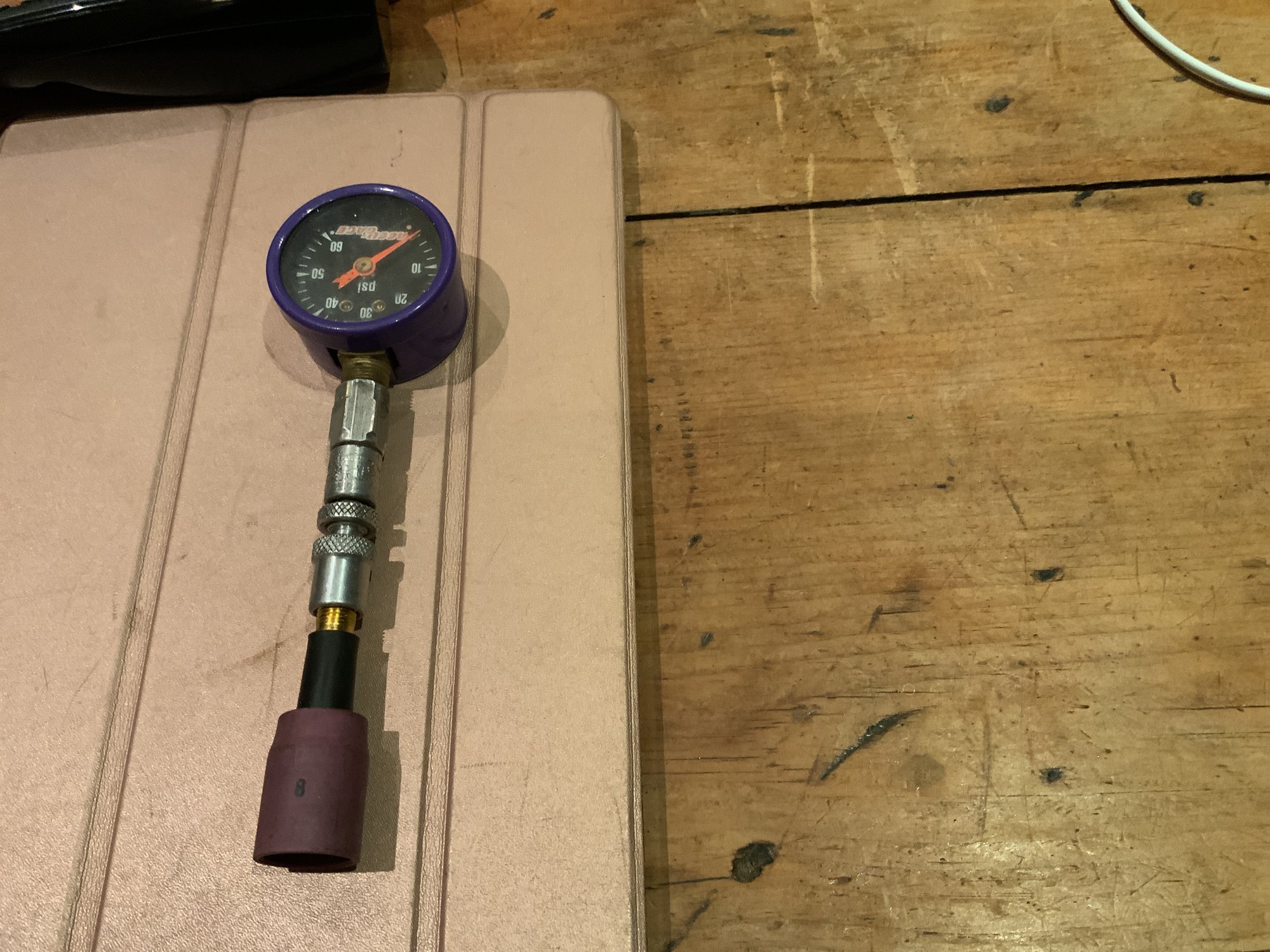

Not always easy to find a leak. I built this a while back to test
It’s just a tyre valve pushed into a no8 cup, with a pressure gauge

Duff bottle of gas? Can you borrow one?
You have the earth clamp in the right place ?
That really does look like a gas issue (ie not 100% pure argon),the label having argon plus on it is ringing the alarm bells here.
What is happening with the tungsten? fizzing and burning away?
Looks a gas issue or gas leak. Get a known good machine and a piece of stainless or titanium and do a gas spot check.
Don’t worry about tungstens they’re not causing that issue.
