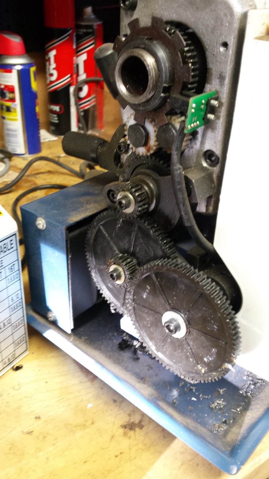

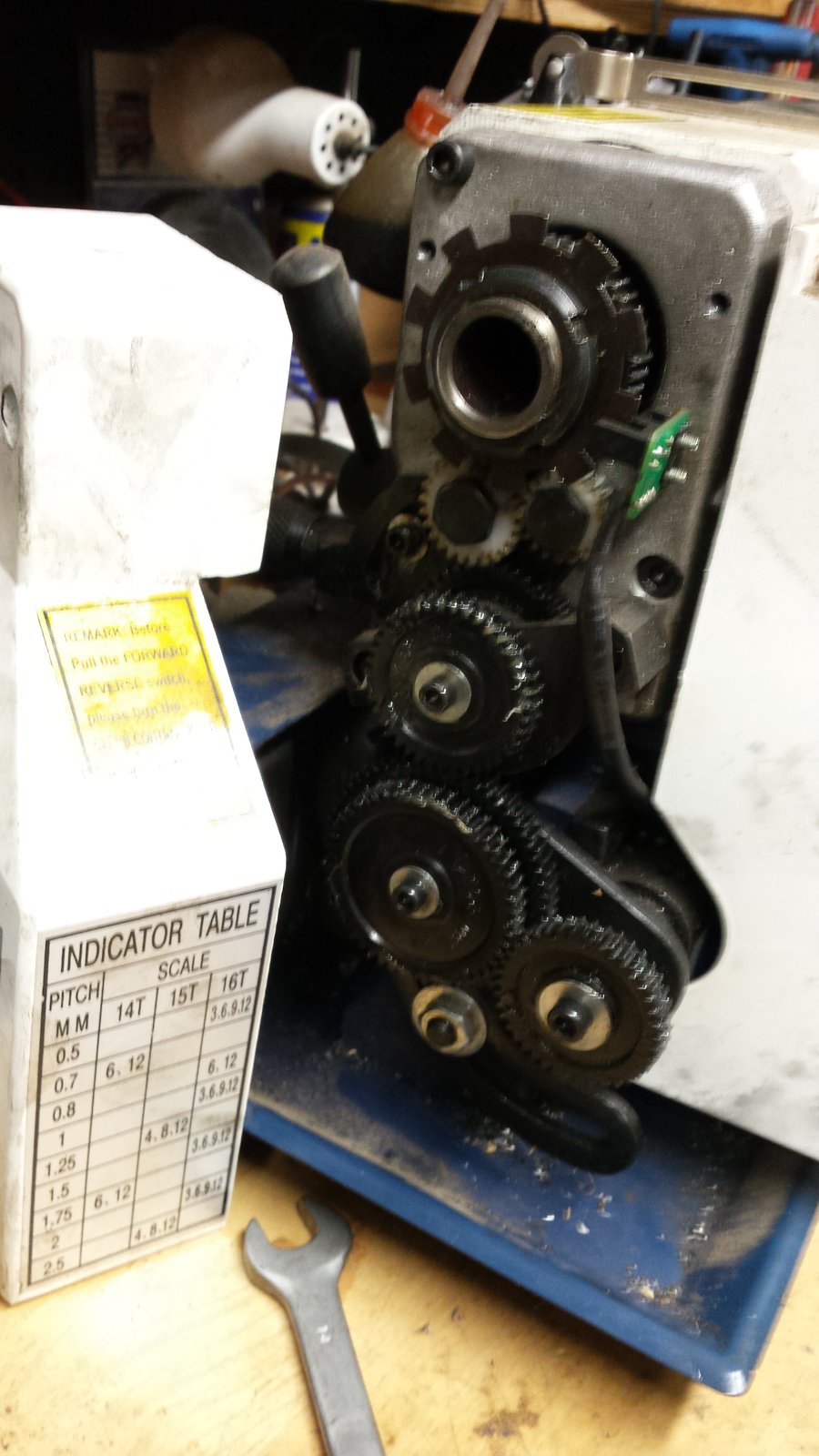

Haven't cut a thread yet. Missing most of my changewheels.

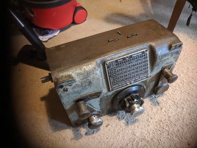

Next year's project is gutting this and making a case to fit it on my lathe.
View attachment 203692 View attachment 203693
Precisely why I'm going to try and retrofit.I wish that my lathe had cogs like that, I have to unbolt/change mine over, looks like it's going to be a pain in the rear end.
What's your lathe? What does the change-wheel area look like?
Sometimes some fairly simple modifications can make swapping gears a lot easier (see for example the one I made for my mini-lathe: https://www.cgtk.co.uk/metalwork/minilathe/threadingbanjo). It'll never be as nice as a gearbox of course.
Interesting link, my lathe is an Amadeal one, very similar I guess.
In that case, open up the change-wheel housing and take some photos and some measurements of the distances between the first change-gear shaft and the leadscrew shaft. If it looks like it's the same as my SC2, I'm happy to post you both of my home-made threading banjos (as shown in the pictures on the website). I've got the M250 with its gearbox now, so I can't imagine ever wanting to cut threads on the mini-lathe again.

The blanks in the indicator table are where it won't work...
There had to be a mathematical relationship between leadscrew pitch, thread pitch and indicator gear (14 / 15 / 16 teeth) for the indicator to synchronise the leadscrew with the spindle and tell you to engage the halfnut in the right place.
