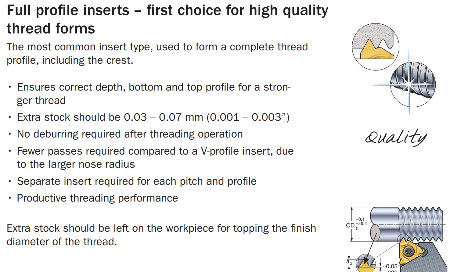

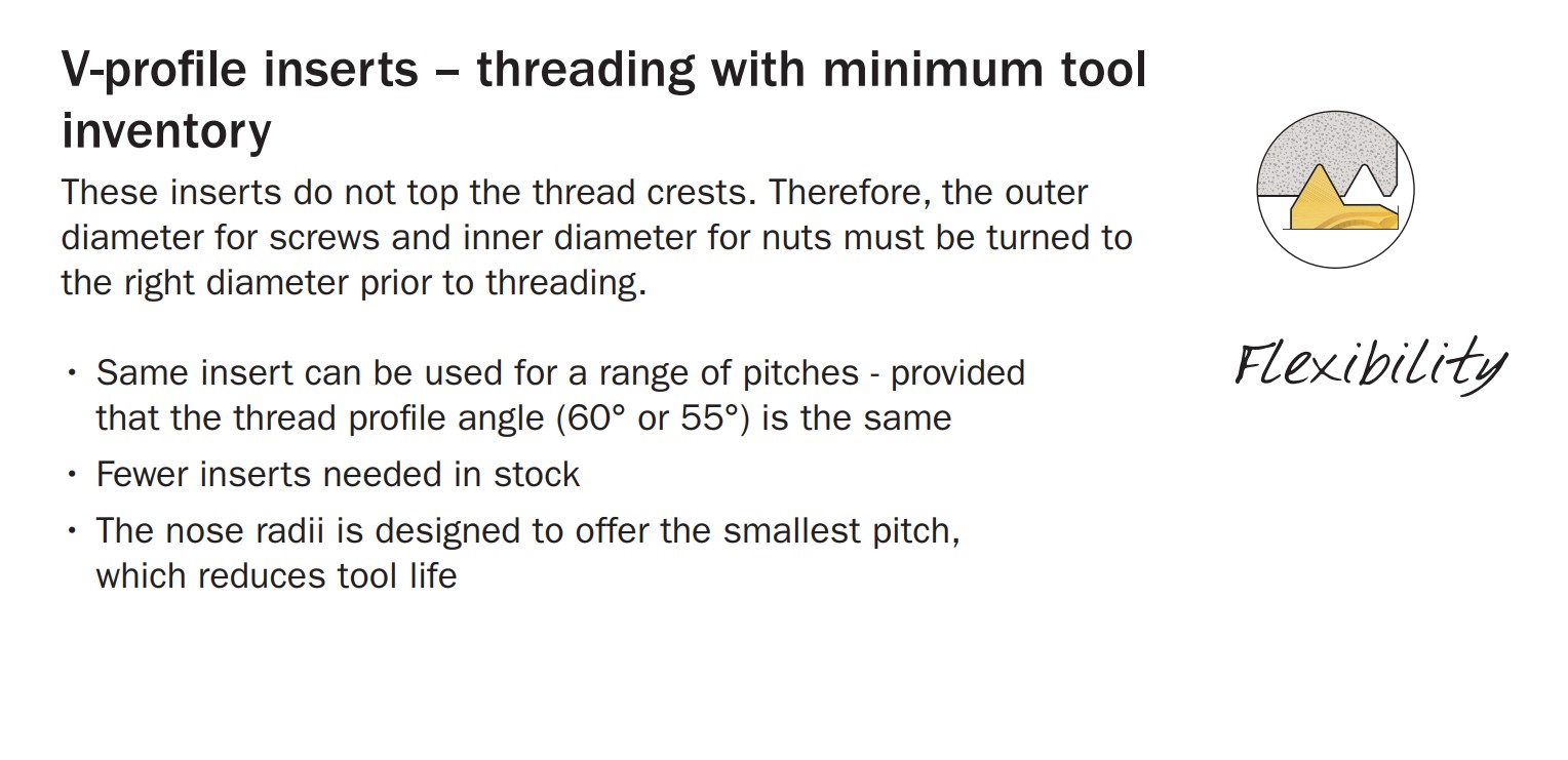

You have not really been using either although probably closer to sharp tipped.
Sharp tipped I will assume refers to the likes of a ground piece of HSS. they can be used for different pitches but will not properly form the root or the crest.
Full profile refers to a carbide insert (although could be fully ground HSS) which has the full thread profile and will form the root and crest profiles correctly, they are limited to a single pitch.
The ones you have are partial profile, they will cut any pitch within the range, say 0.5mm to 3mm , they will cut the correct root profile only on the minimum pitch they are designed for and will not cut the correct crest on any.
From that Sanvik PDF I linked to earlier.
Full Profile
Partial Profile.
Looks great, but I have a question,...... what's the difference between a full thread form tool and a sharp tipped tool? And which one have I been using??
Sorry but sometimes more information poses even more questions especially for us novices.![]()
