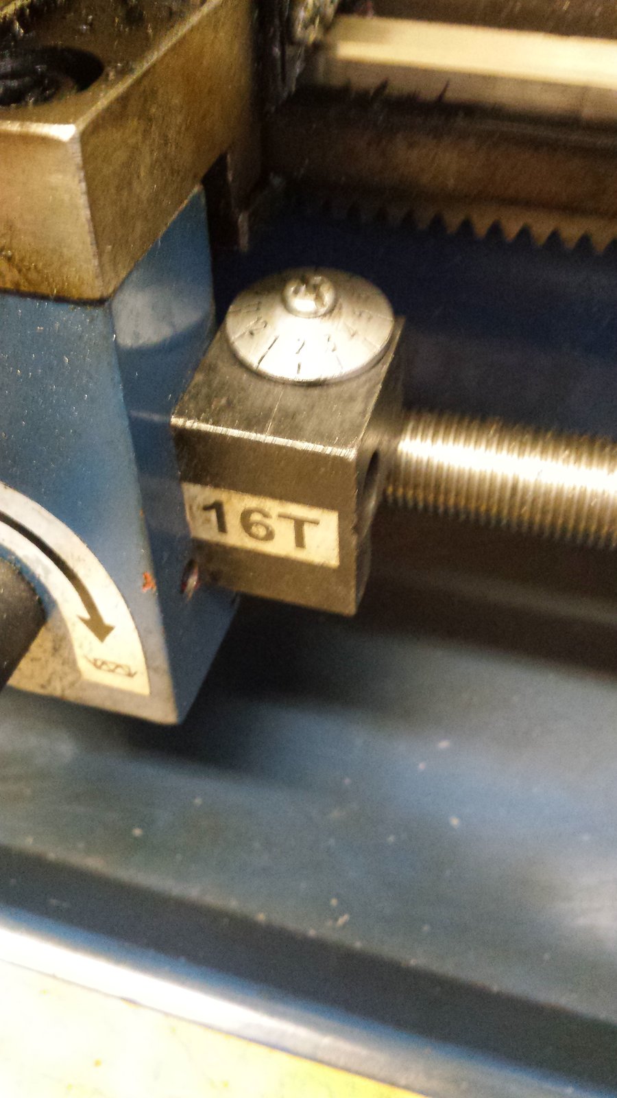

    While we are on this subject, my lathe came with the thread cutting dial slightly away from the leadscrew so it wasn't turning, is this normal,.... do you only adjust it up when you actually want to cut threads or is it OK to leave it engaged all the time? Maybe it could create excessive wear on the leadscrew I guess??

    they just twist of the lead screw normally when not in use

    Yes that is normal and as you guessed it is to stop wear.

    Yes, just a twist and a nip on the allen screw holds it there, thanks chaps.:thumbup:
