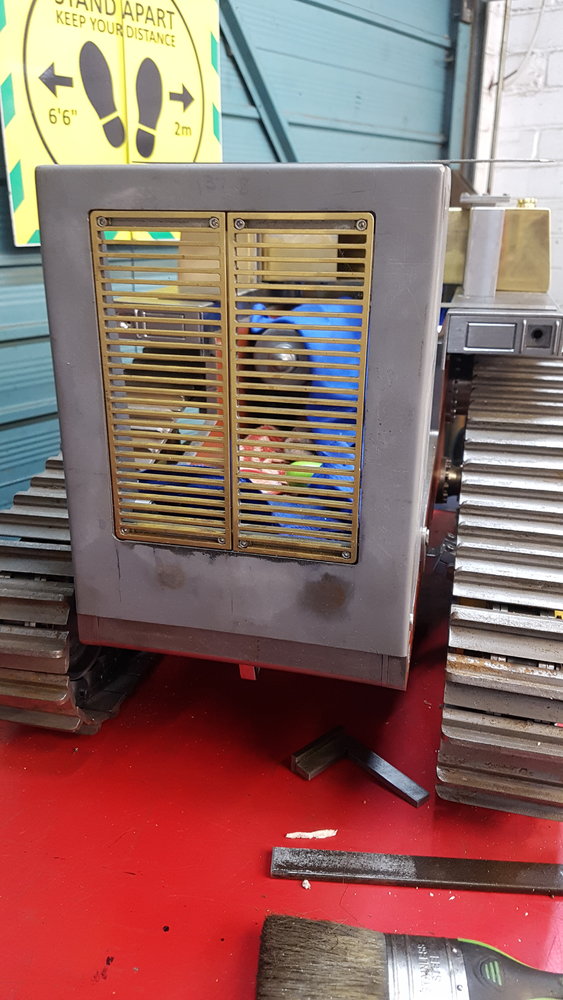

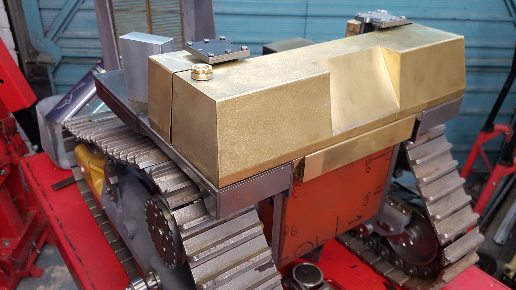

The fuel tank and grill. Did you braze them or solder them. Fantastic work.more to follow if anyones interested

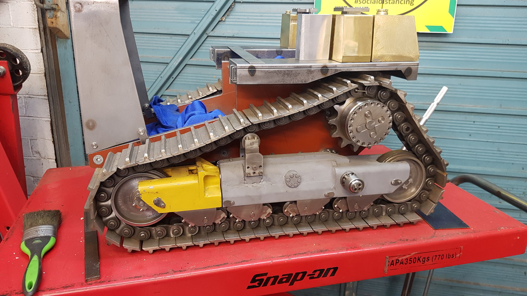

the chain is one inch pitch half links with one track plate per link sprocket is not strictly correct it should be two teeth per link i won't tell if you don'tThe track plates and chain. Were they custom made? The chain looks like all half links
