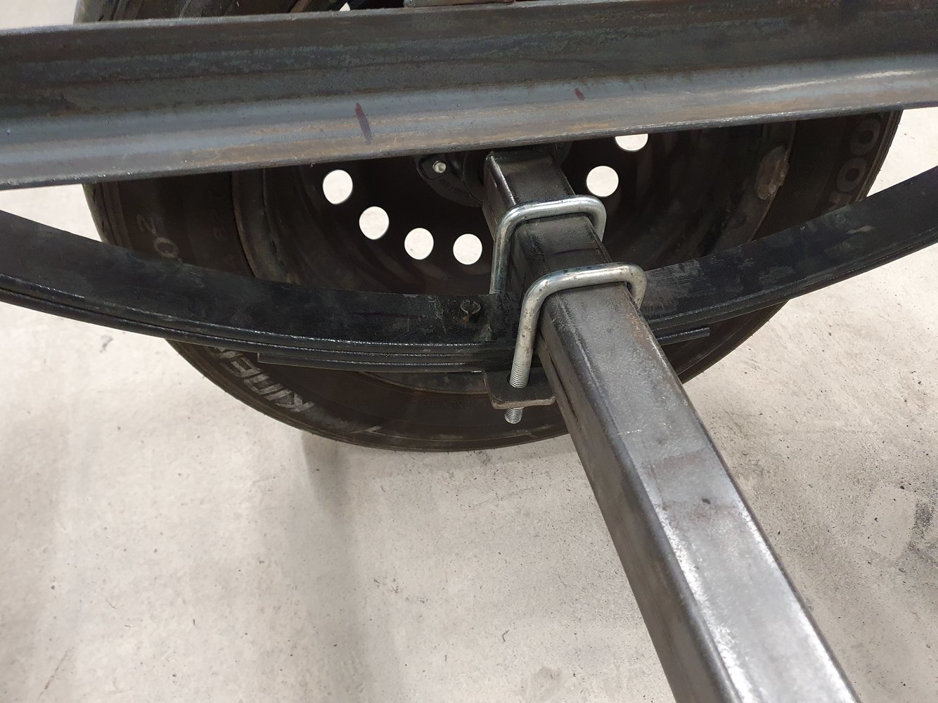

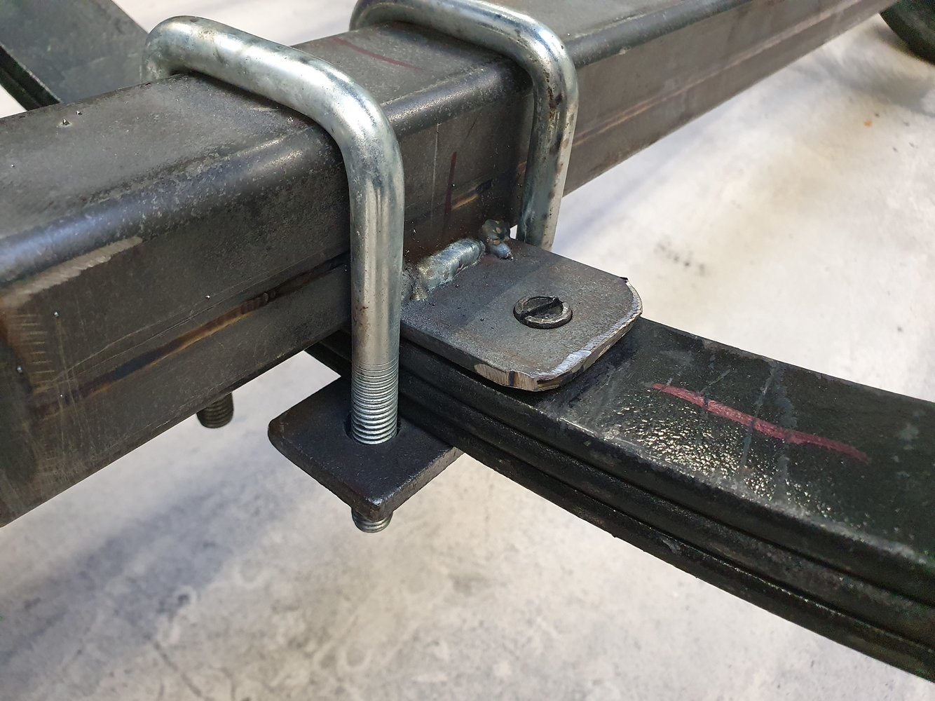

I See what you mean. I put it in its current location with holes in the axle to locate on top of the bolt going through the 3 leaves to locate the axle and prevent any sideways movement. I did consider not using them and simply put the axle at the bottom of the springs as you suggest. Hopefully it won't be an issue.So not bottom as in under the springs but bottom as in at the lowest point in the curve.
