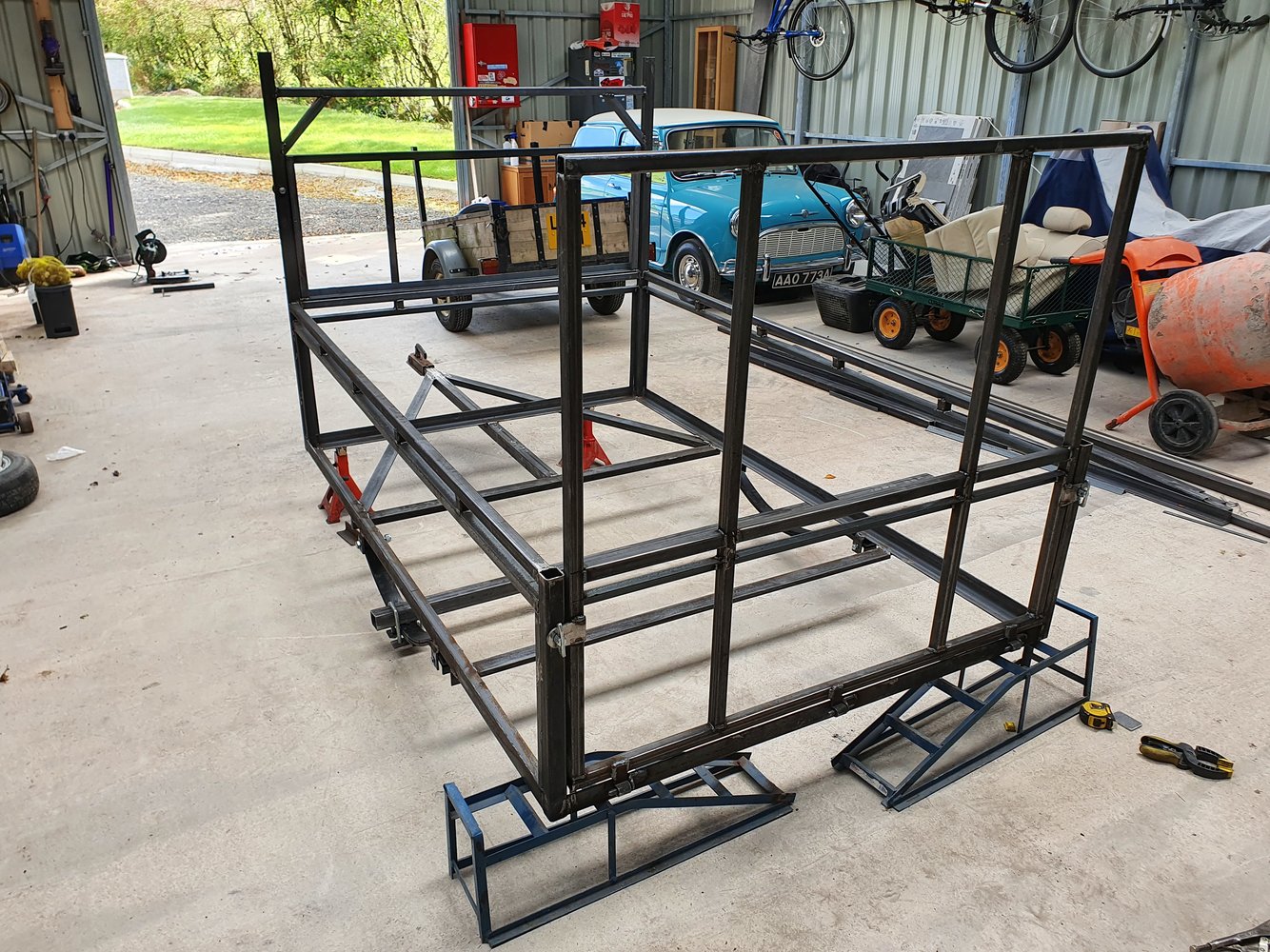

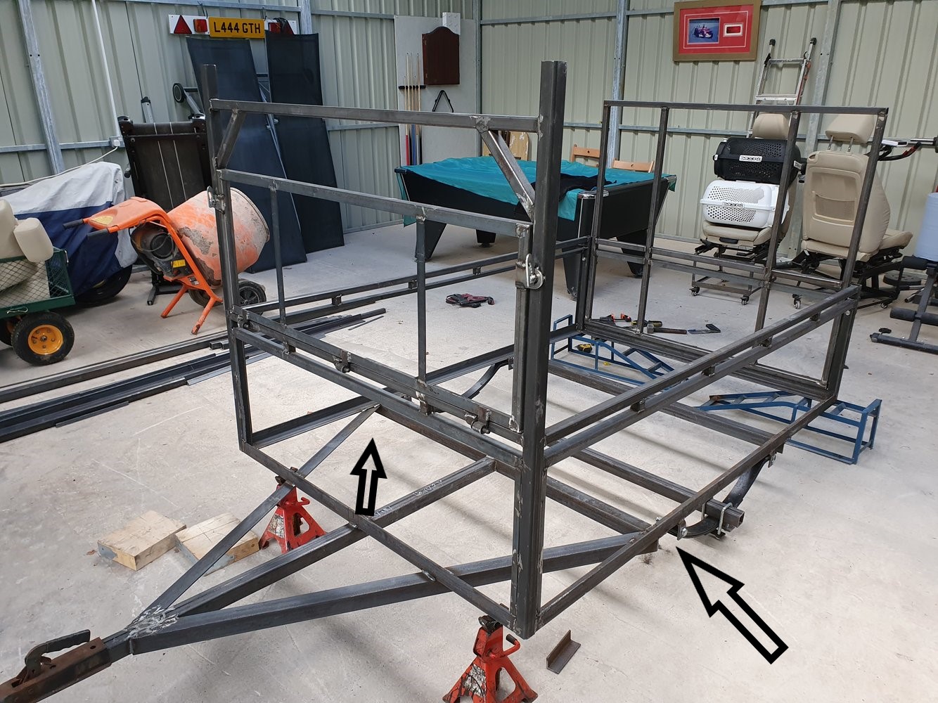

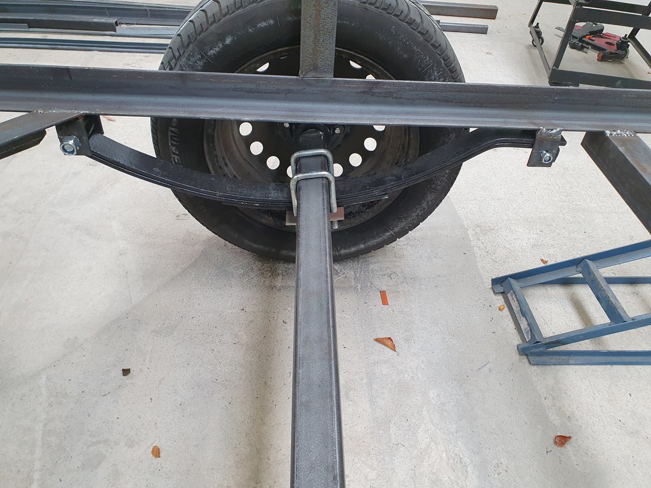

I have an Erde 5x3 or therabouts and its best trailer i have had and wont get rid so for carrying larger loads instead of sitting them on the top of the box like i do i will be making a frame from 25x 25 mm SHS. On this trailer the new frame can slot down into the corner posts so its also removable then. an 8x4 sheet will just go on nice without the sheets hitting the tail gate of the car.
Be easier than making a trailer or spending out on another bigger one as trailers dont come cheap nowadays.

i did shotblast and etch prime it and a few coats of enamel but they still go rusty
I've a set of rope hooks waiting to be fitted when I get around to doing a light refurb on the trailer.
