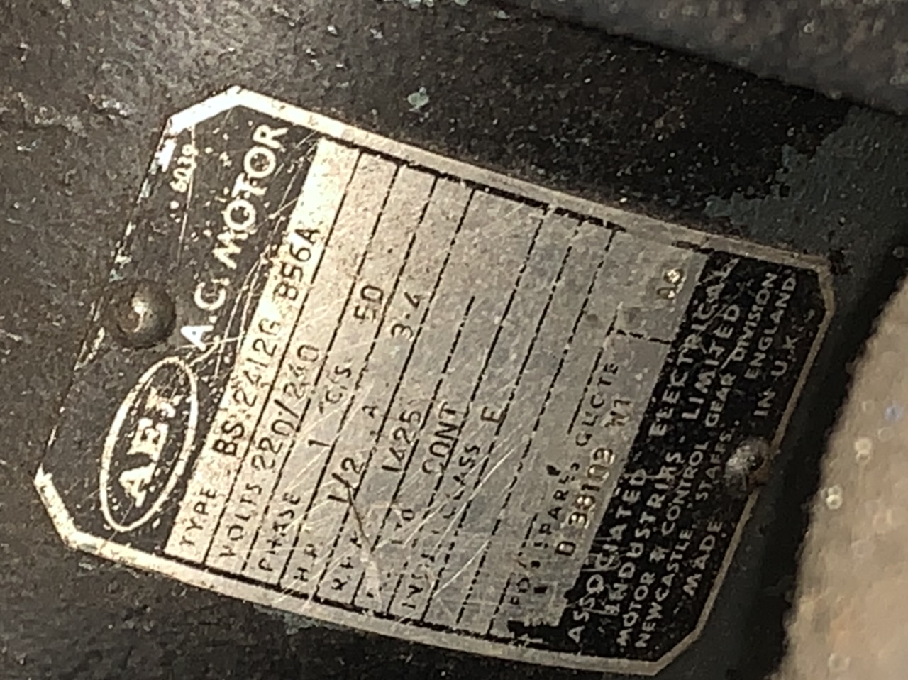

It’s basically referred to as a no volt coil or under volt relay. A direct on line starter which is basically a relay that when you lose the supply you need to re-evaluate-energise it to use.

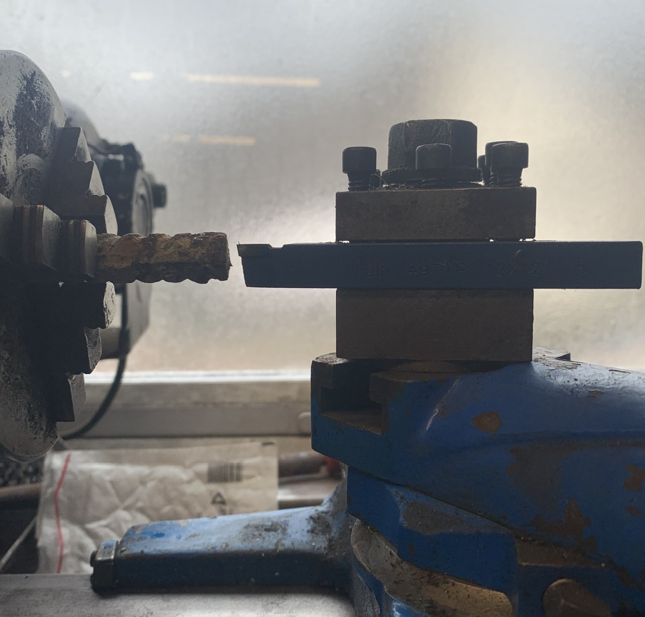

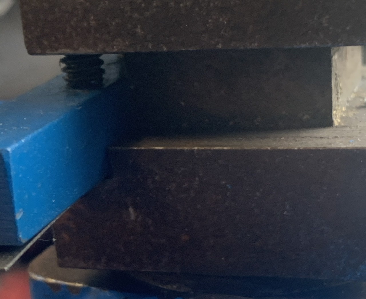

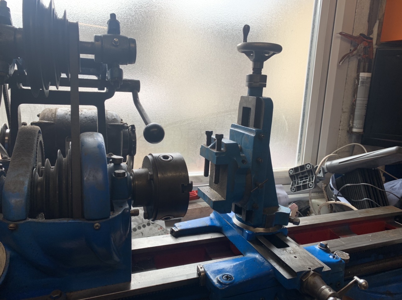

So roughly 1/2" inch. The older small lathes like mine and yours would have used 1/4" or 5/16" size bits in respective tool holders. To get your 4 way tool post working you would have to grind or preferably mill the shank of the bit to lower it, or use a smaller size bit with shims to bring the cutter up to centre height. If you have access to a mill, the 4 way tool holder could be modified by milling out the slots to allow 1/2" tool bits to set lower.
I'll have a look in my storage unit as I think I have some smaller bits you can have to get you started.
