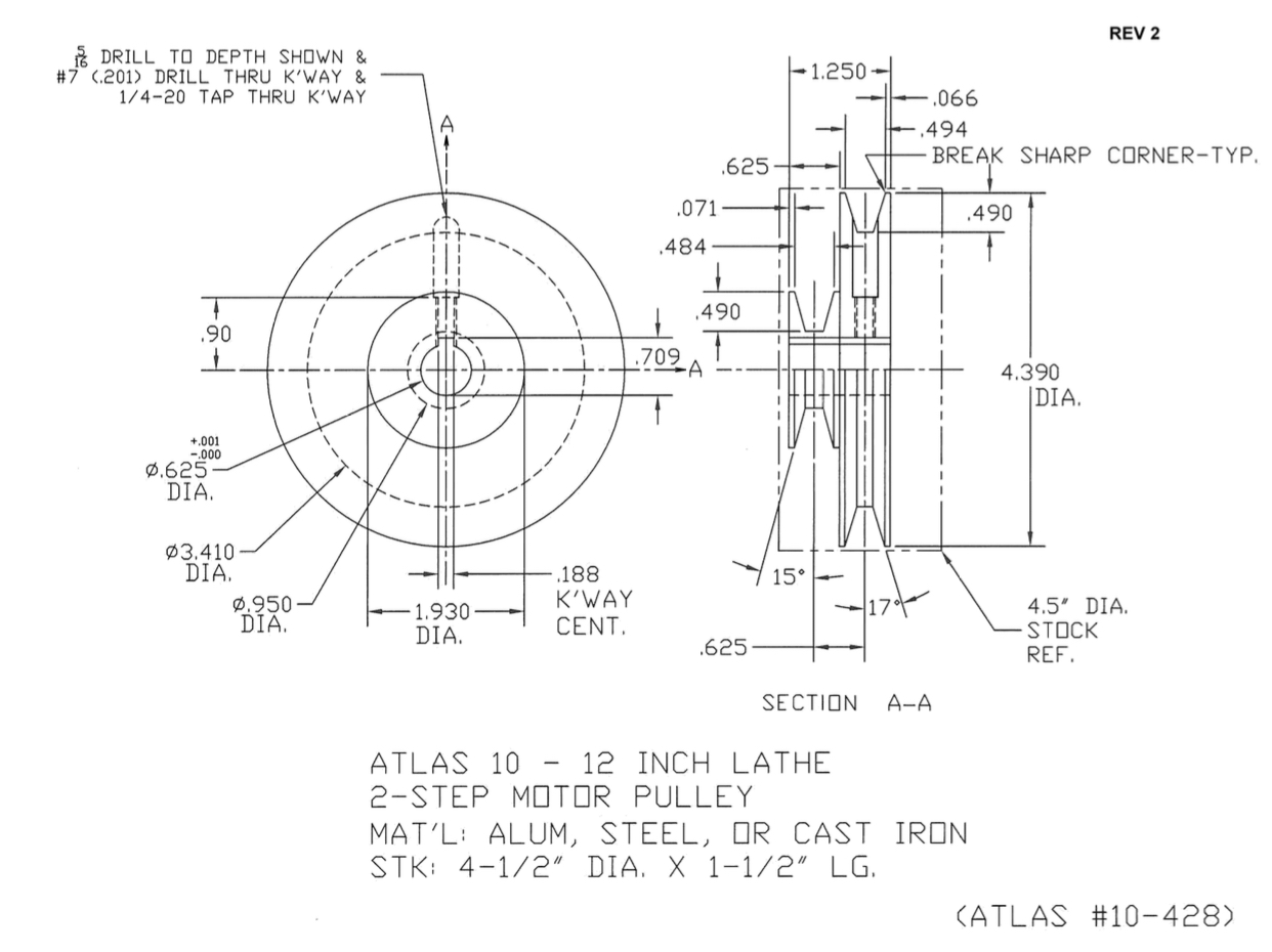

Got ya... didn't realise.But it must be meant to have a 2 stage pulley @spencer 427 as the head pulley has the second ring.
One thing stands out is the small pulley has a tiny OD for an A section belt, if the drawing is correct? This may give problems unless the opposing pulley is quite large or far away - even so you'd want an XPA style belt. The minimum recommended in a couple of belt manufactures design guide is ~63mm pitch and yours looks like 38mm pitch?

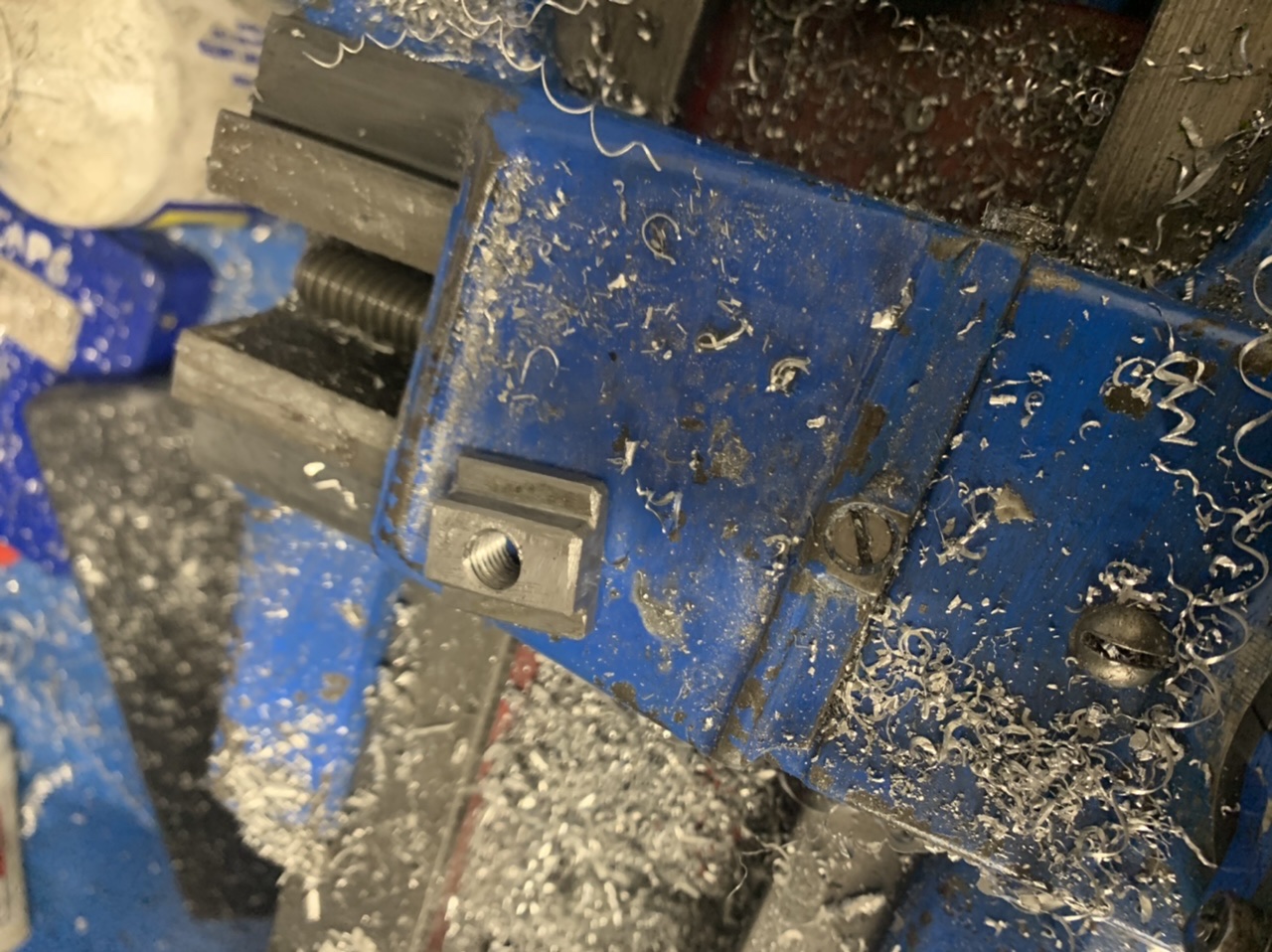

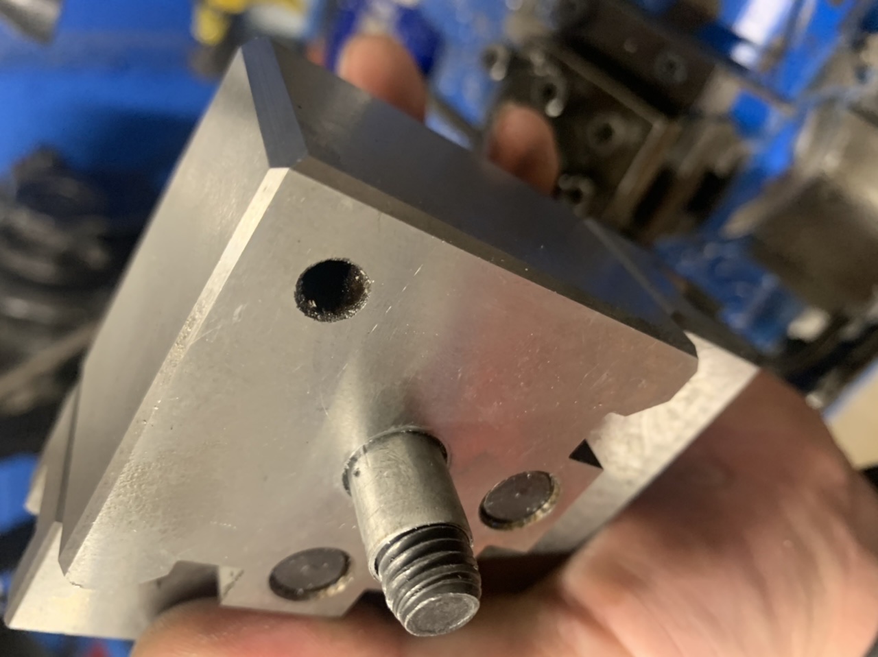

I'd make that tee nut longer if I were you. It's a bit short and would be more likely to rip the tee slot out if you get a dig-in.
