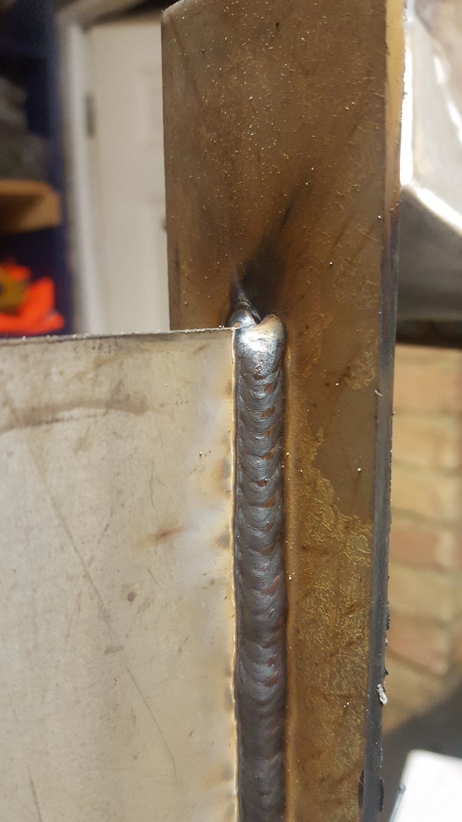

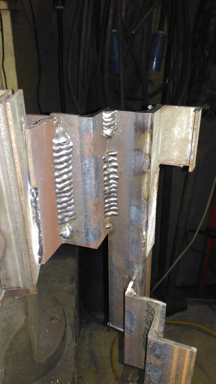

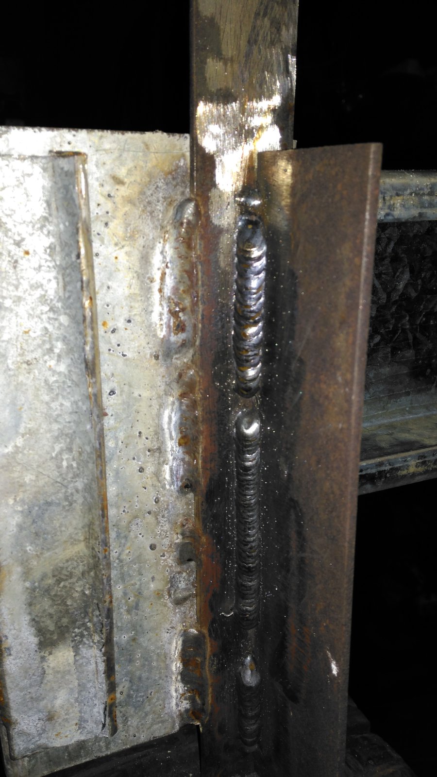

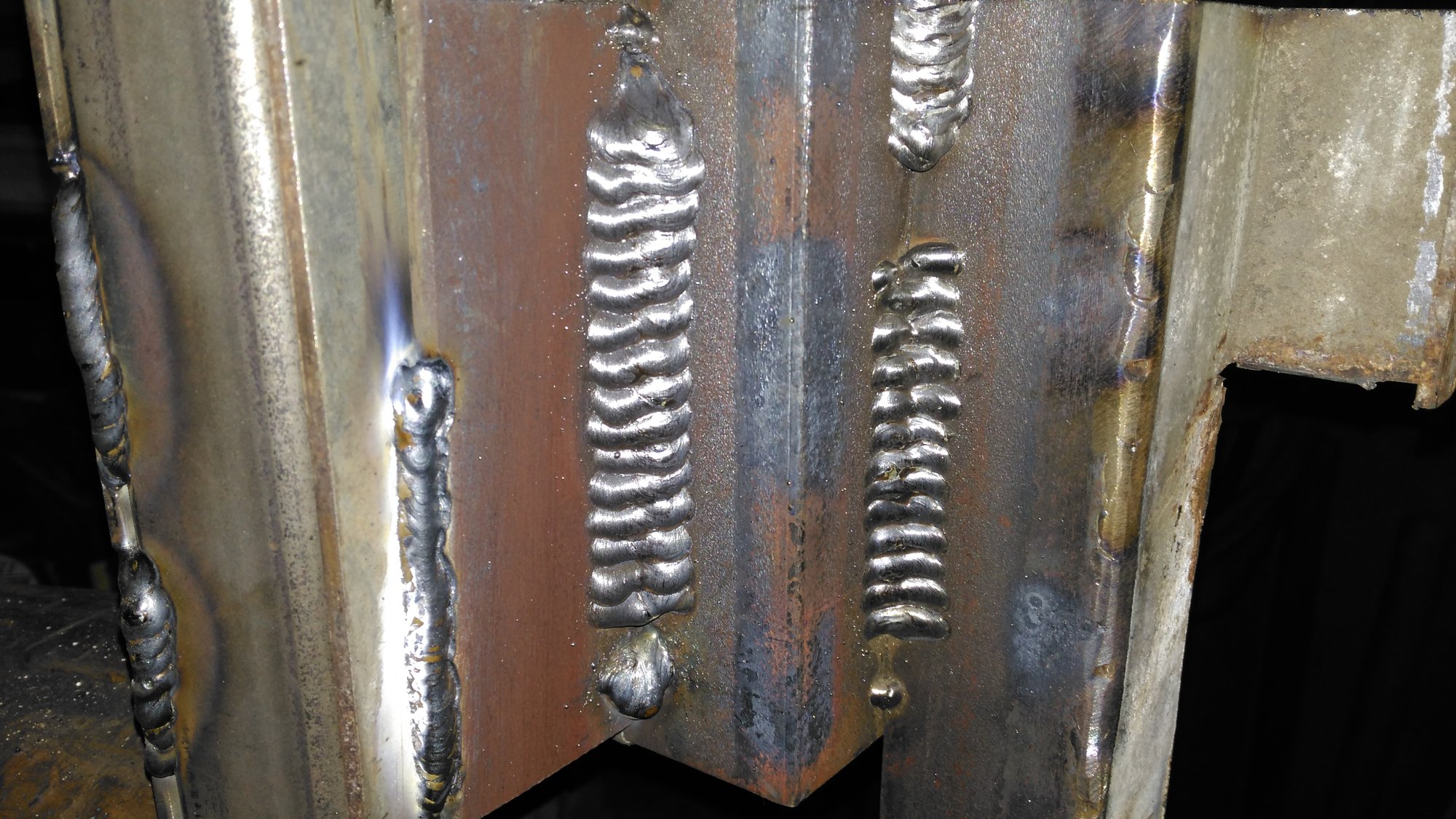

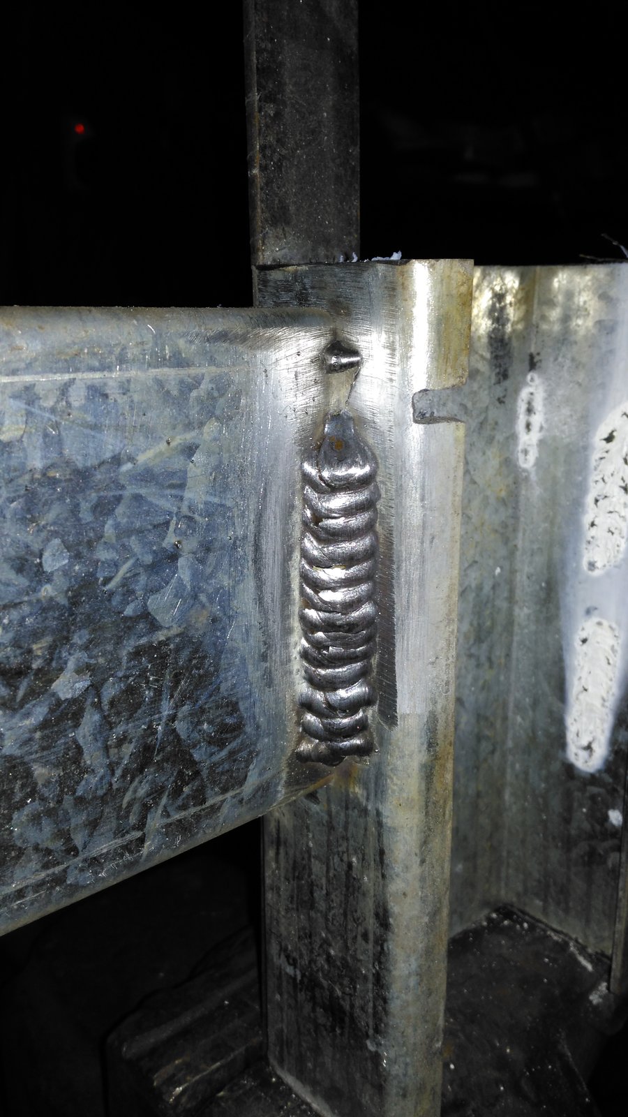

Very neat. Got that dialed in i would say
Get a nice setting in the flat of 100-120A. Then do your vertical.Cheers, think in past I spent far to long fiddling with settings, with bit more time under the hood with mig, I seem to be able to get in ball park without thinking. Paying more attention to what happens in the weld pool than what's on the display.
Don't move up as far when you are moving across the weld face, you are verging on getting lack of fusion between each pass
