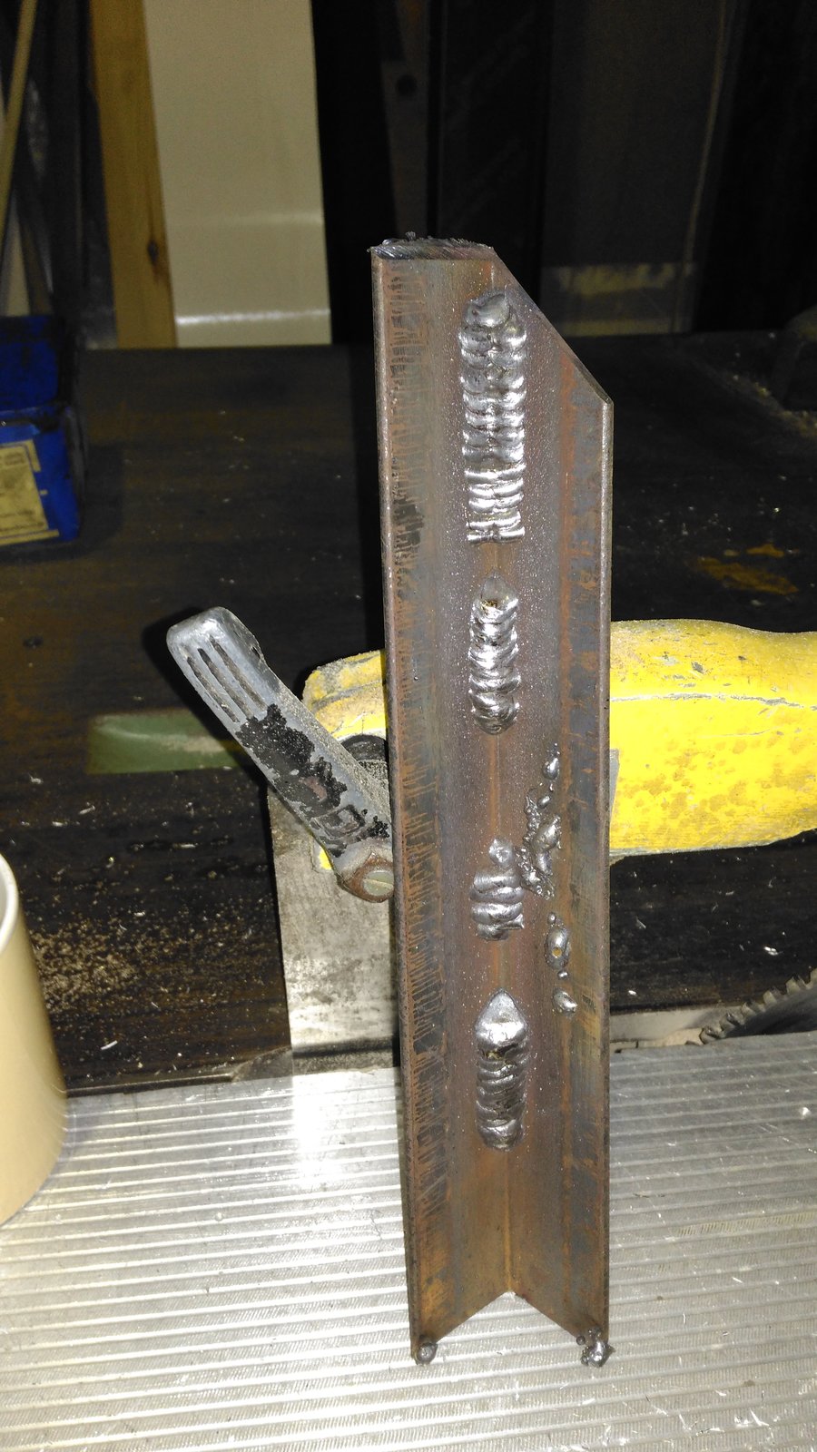

  1. Better but pause longer at the sides and move across the middle quicker. Get into the habit of counting to 3 at each point of the triangle and get a regular rhythm going

    I turned down the welder but maybe need to go even lower?
    the bottom weld I was aiming for 2-3 secs but it ended up much bigger than the thickness of the angle..maybe just moving too far between points? I tried moving less the one above
  3. It's one of those things that it's far easier to show than try and explain, have a look at the instructional videos for some pointers

  12. smashweld Member
    Messages:
    566
    Location:
    Central Scotland
    Tried with setting 2/1.
    Was easier to see/control the pool with it not bubbling up so fast.
    Thoughts?
  13. That's a lot better, particularly the top section, you are starting to get a steady rhythm going, don't travel upwards as quickly so the runs blend into each other a bit better

  14. smashweld Member
    Messages:
    566
    Location:
    Central Scotland
    Cheers.... The one at the top I was moving/weaving further out to the sides..if I hadn't posted/read on here I'd have thought the bottom one was the most solid looking!
  15. The throat thickness is way too big on the bottom one, usually down to travelling from one side to the other too slowly
