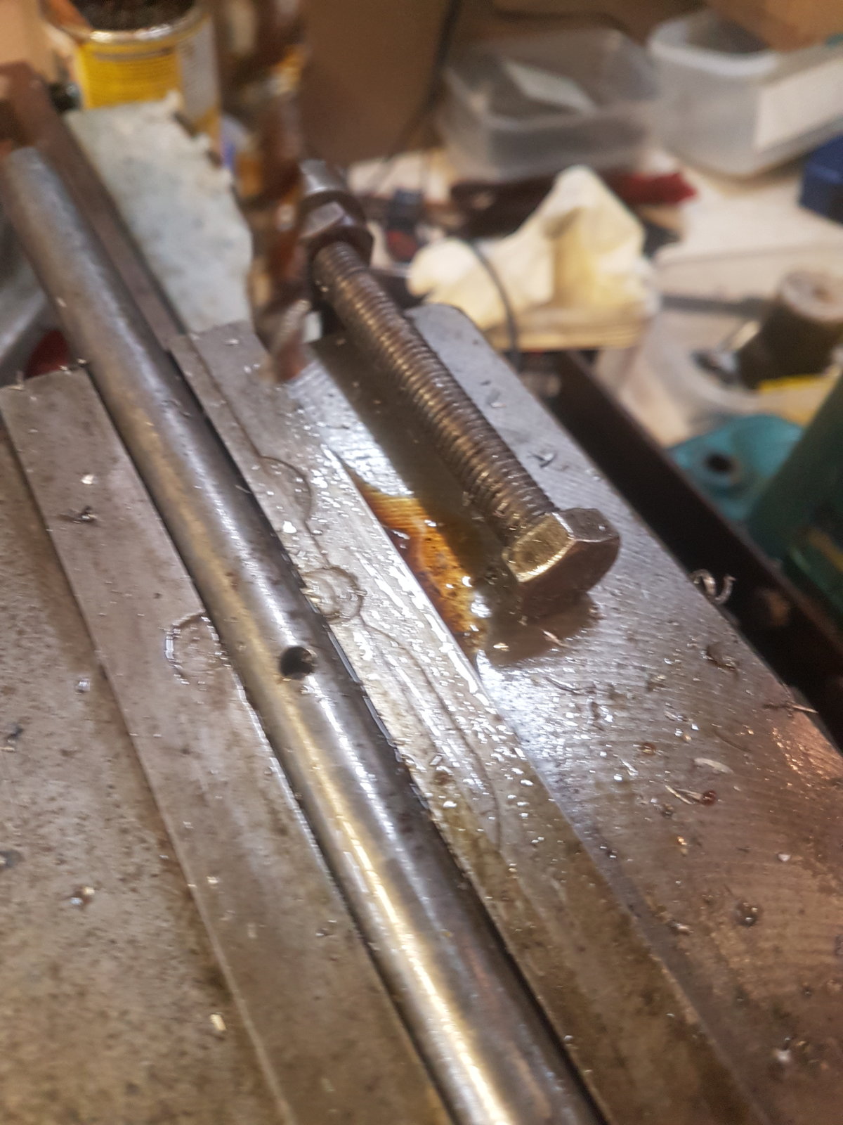

Mines a through hole. No reason it needs to be blindNo I was milling down large T nut the cutter snapped because it came loose due to me not having a spanner to tighten the arbour. I would use the thinnest cutter I have I guess 4 or 6mm, a slight rounding in the corners should be ok I am making a handle for the machine vice

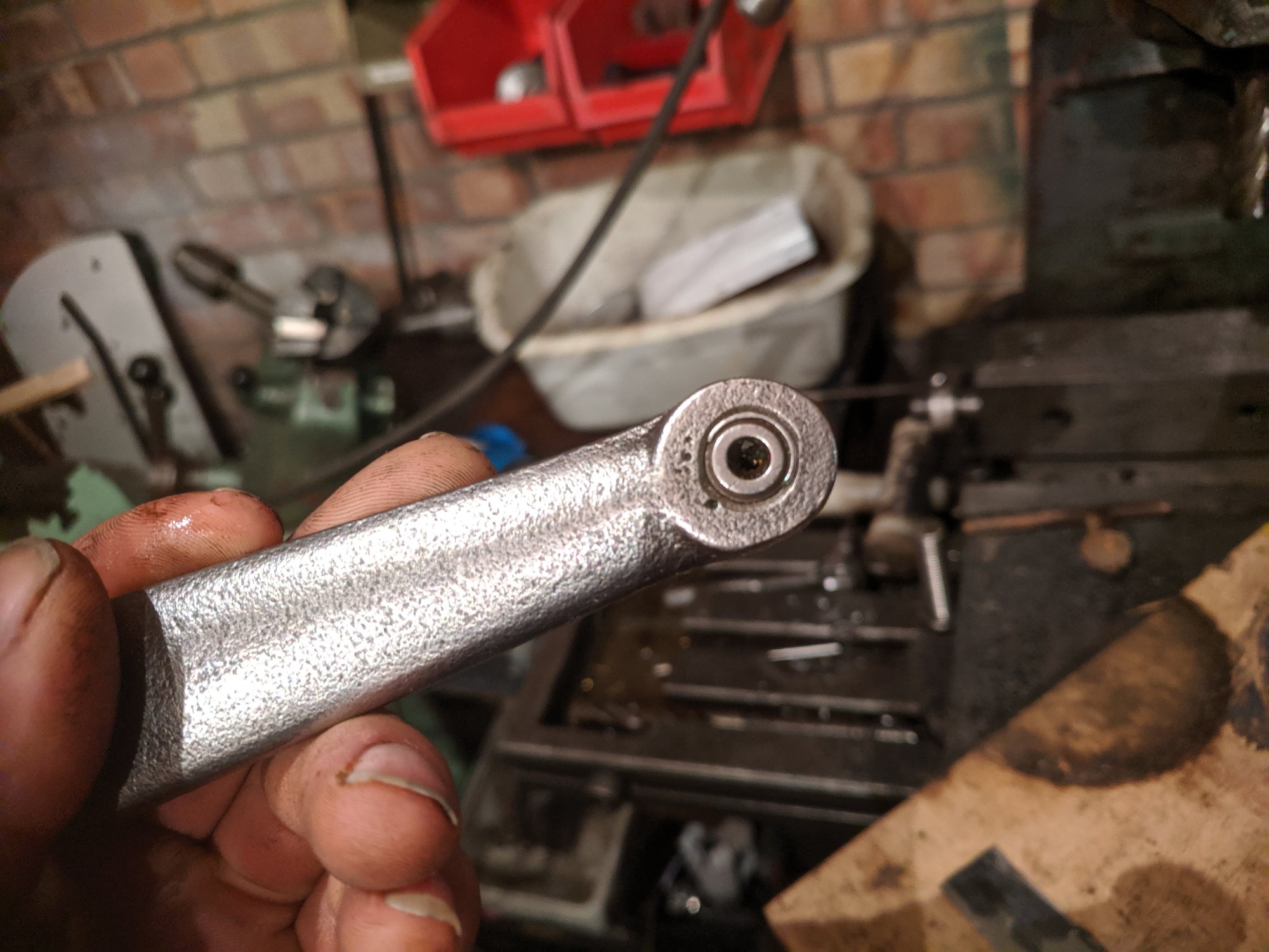

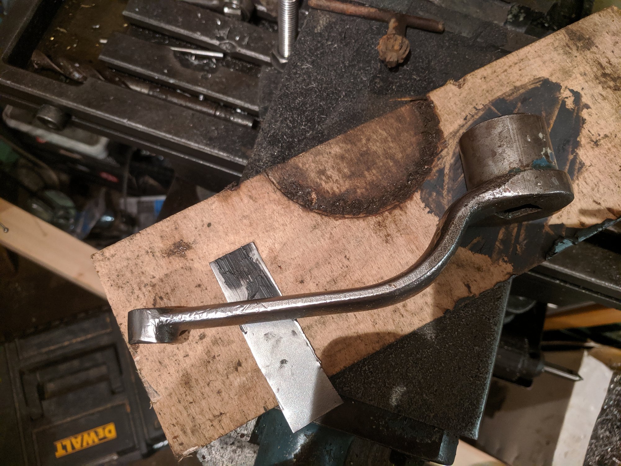

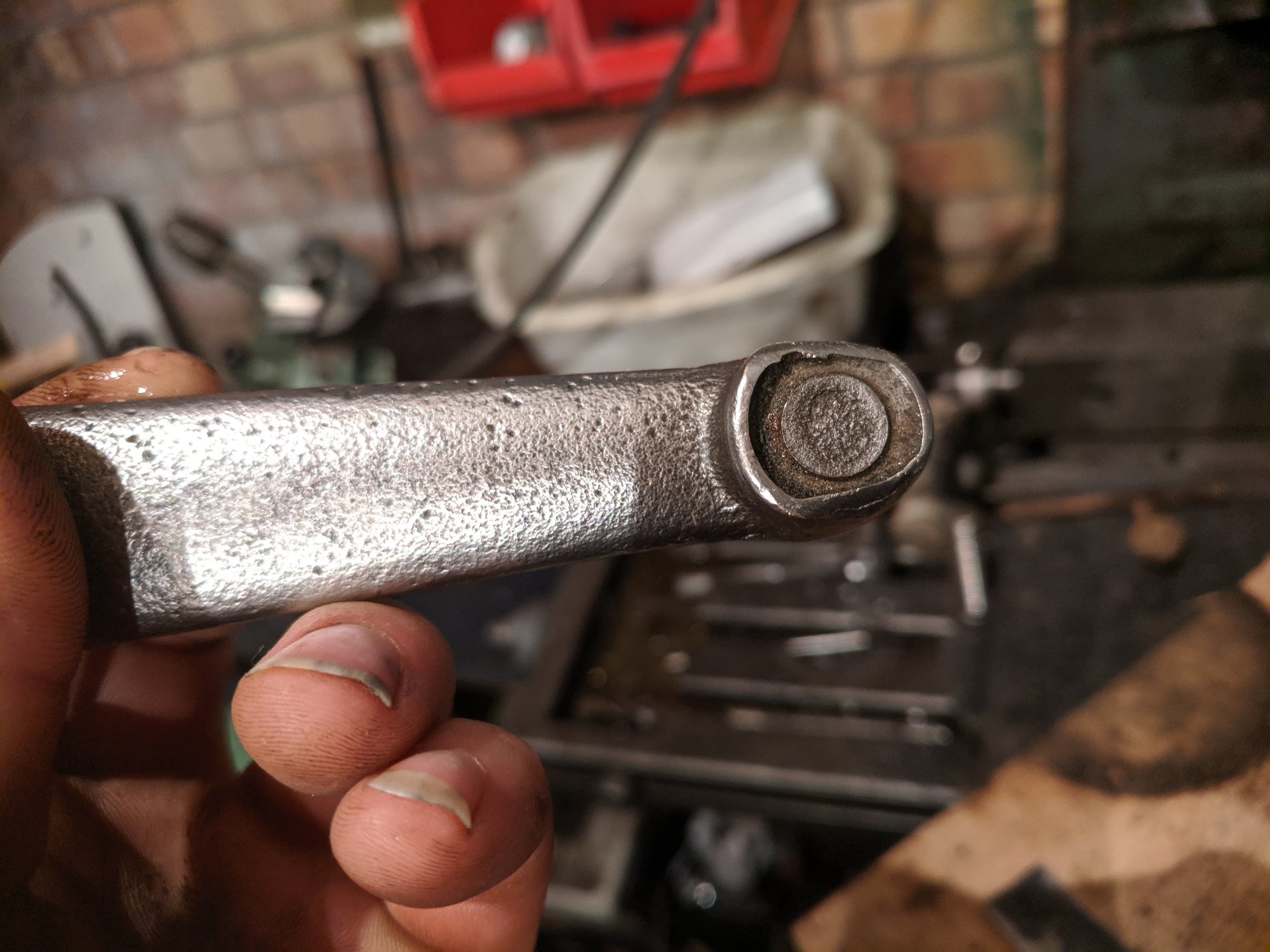

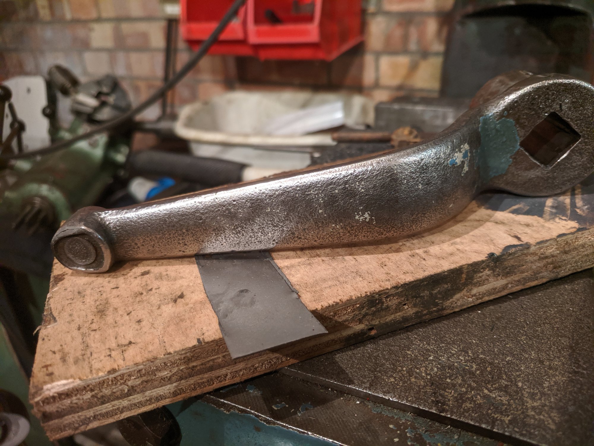

Mines original if you want picsno it does not need to be blind at all. I can easily make it a through hole then square it off
Need to go turn the vfd off anyway. Will post here.yes please mate no great rush my bed is calling.
