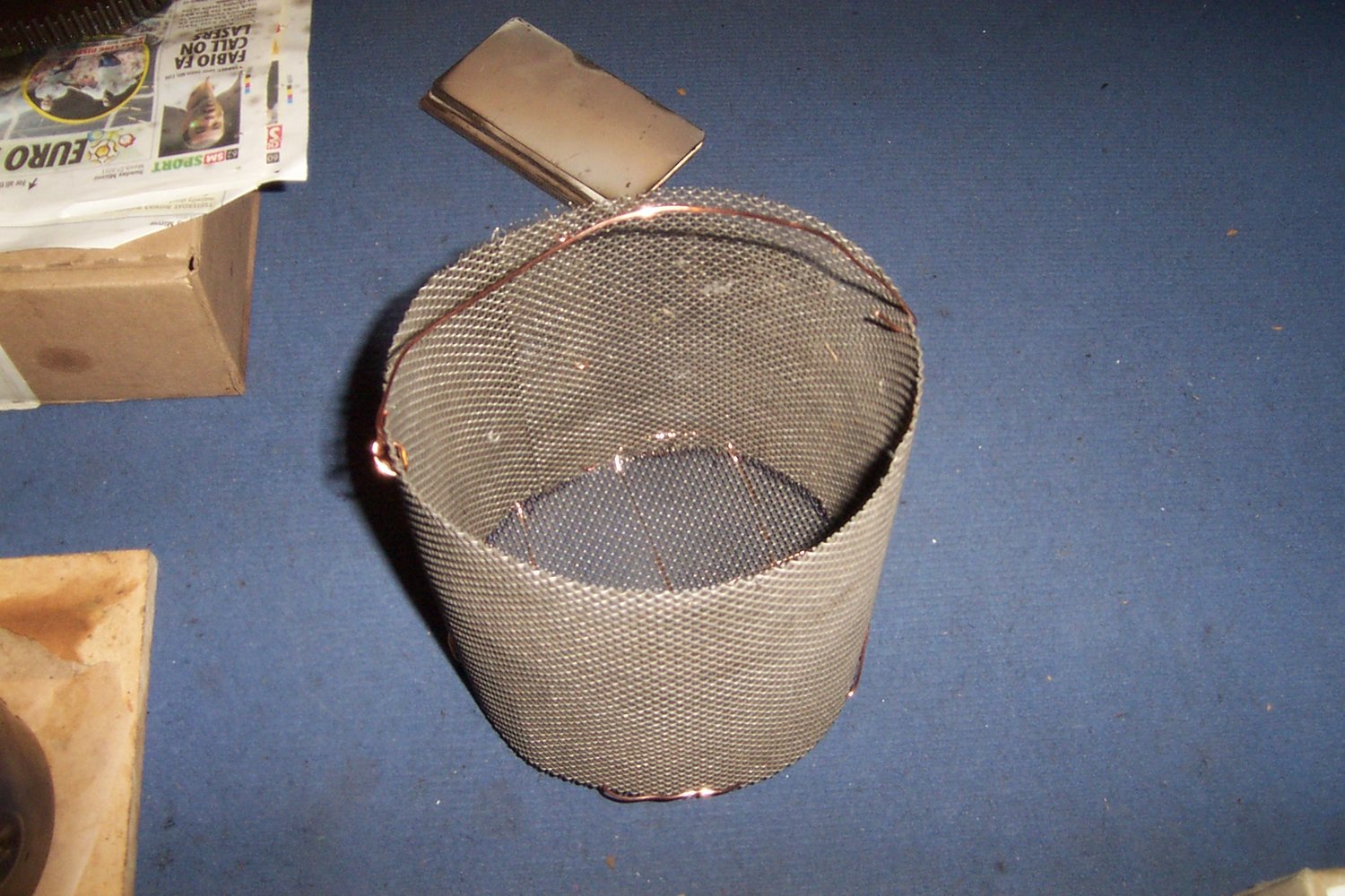

What's your method for electrolysis of numerous small objects like that? I've made a bath with carbon electrodes all round, but only tried it on single large things suspended from the top.
Do not use stainless as an electrolysis anode as you'll be making hexavailent chrome and poisoning yourself.Cast iron anodes, (old sash weights are a good source), & a metal mesh basket holding/containing the taps & dies.
That mesh bucket looks more like stainless than cast iron?I know.Never did, never will.
I found cast iron the best general all-rounder. Lasts much longer than steel, & close enough in type to most things going into the vat.
The rusty parts go on the annode, + positive connection, where rust and then metal will be removed.
You can use anything on the cathode and it will be plated with whatever ions are floating about in solution. If your taps are on the cathode, they will be coated in mess.
