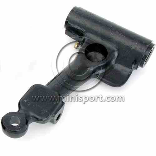

What you're trying to do looks, imho, pointless. You'd be better served looking for a compact coilover unit and mounting it more conventionally. You're going to have forces going all sorts of places that they needn't otherwise.
I'd reconsider, but hey, it's your design.
My current car (well, one in the garage) makes use of a composite monofilament leaf spring transversely mounted, front and rear. Many people who want to get away from this arrangement merely fit coilovers in place of the damper, although there are queries over whether the damper mountings should be strengthened.
