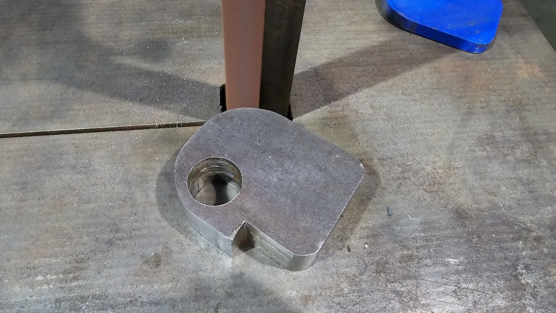

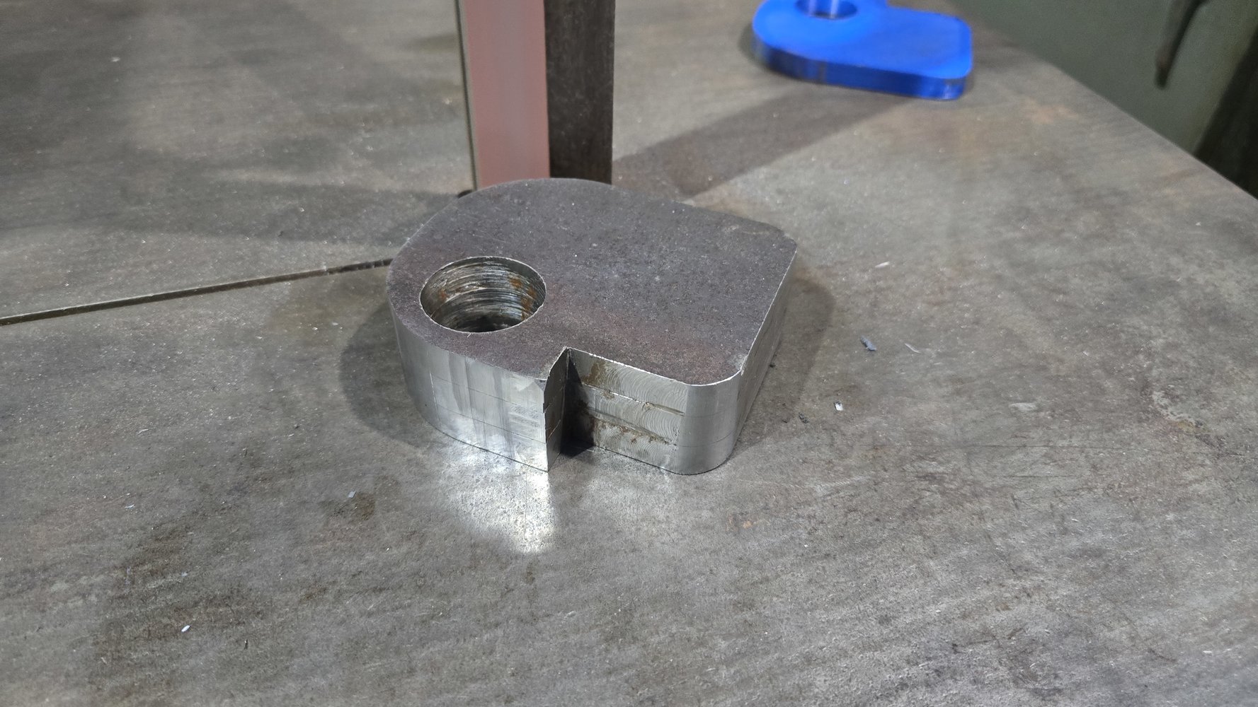

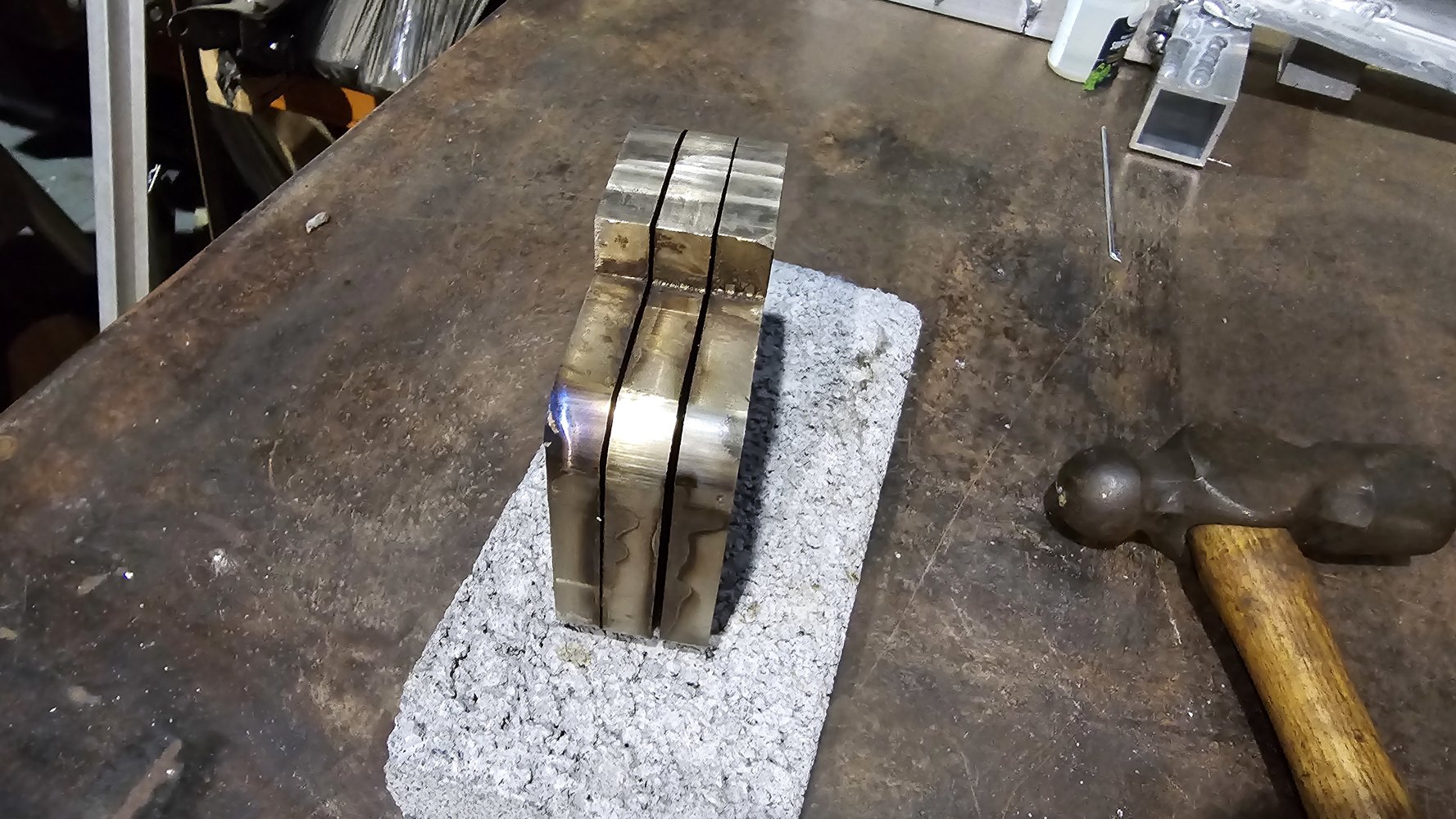

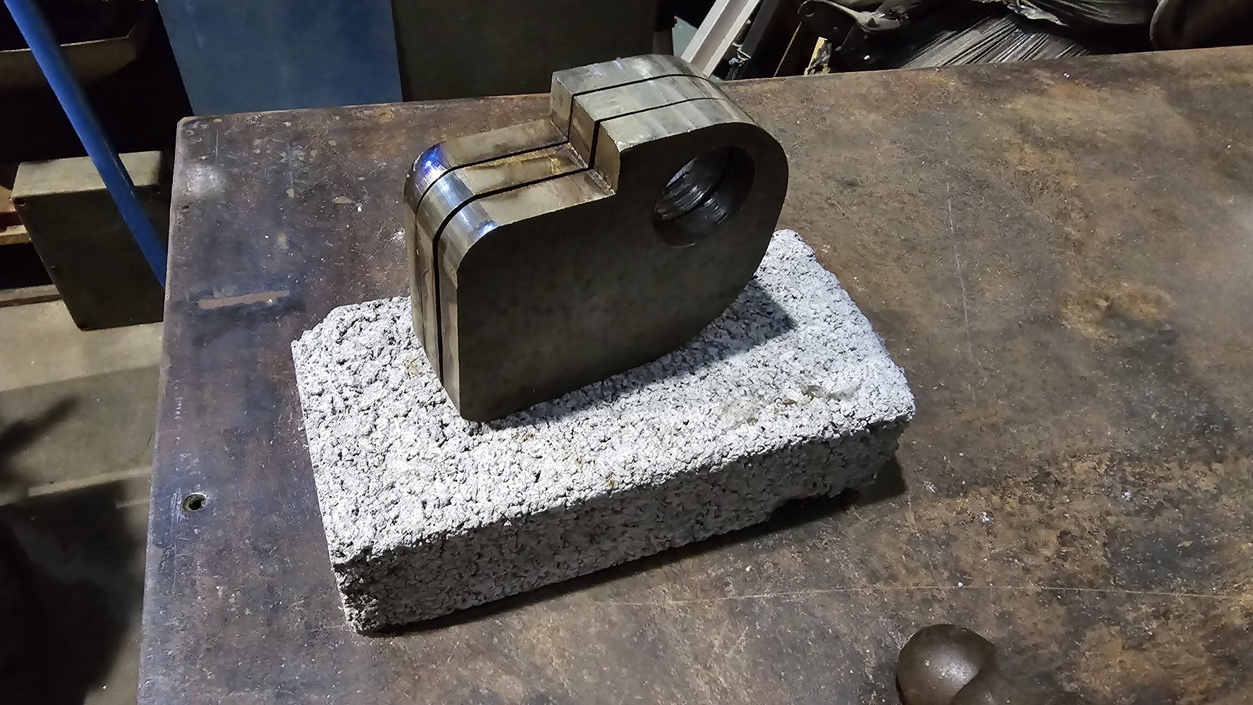

Have you a photo of the bottle?Used one by Permabond to stick 3 bits of 12mm steel plate together before milling and linishing. Incredibly strong.
I was concerned the heat from the linisher would break the bond.
No chance! It took 15 mins with a blow lamp to heat it enough. I had an infrared thermometer. Needed 220c before it let go!

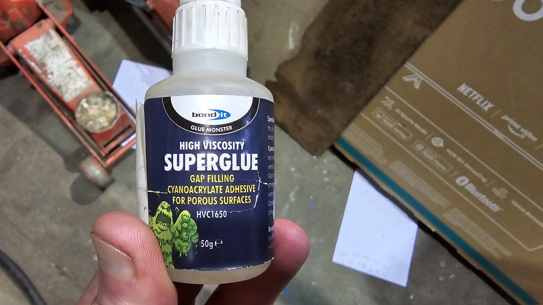

This open bottle is about 3 years old. My warehouse is like a fridge but occasionally it can hit 30C. Doesn't seem to have effected it.Superglue has supposed to have a limited shelf life, but it can be greatly extended by keeping it in a freezer.
Have you got a label??
