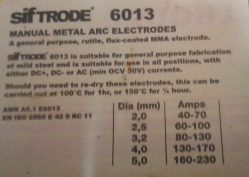

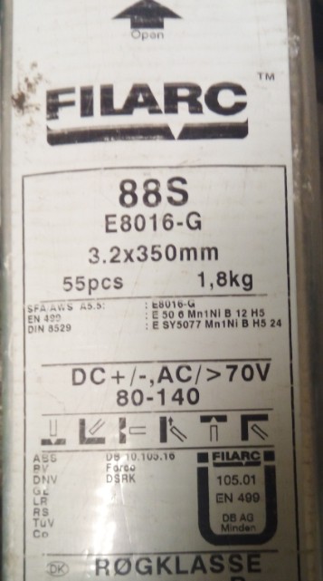

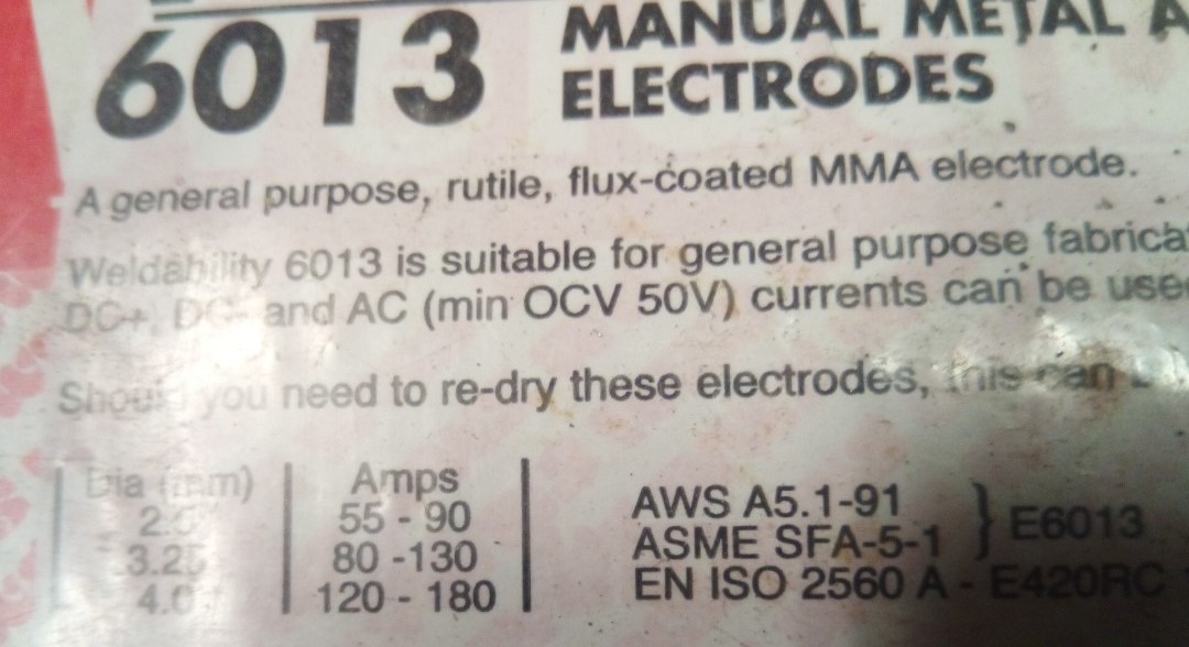

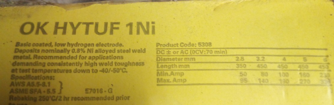

Thats the range i have been using recently, that little box burns rods without blinking. I keep meaning to see how low a 4mm will run.The rods will really determine the current range. For 3.2mm rods which I would be using on 10mm or so then in the range of maybe 90-120 depending on position/type of joint.
