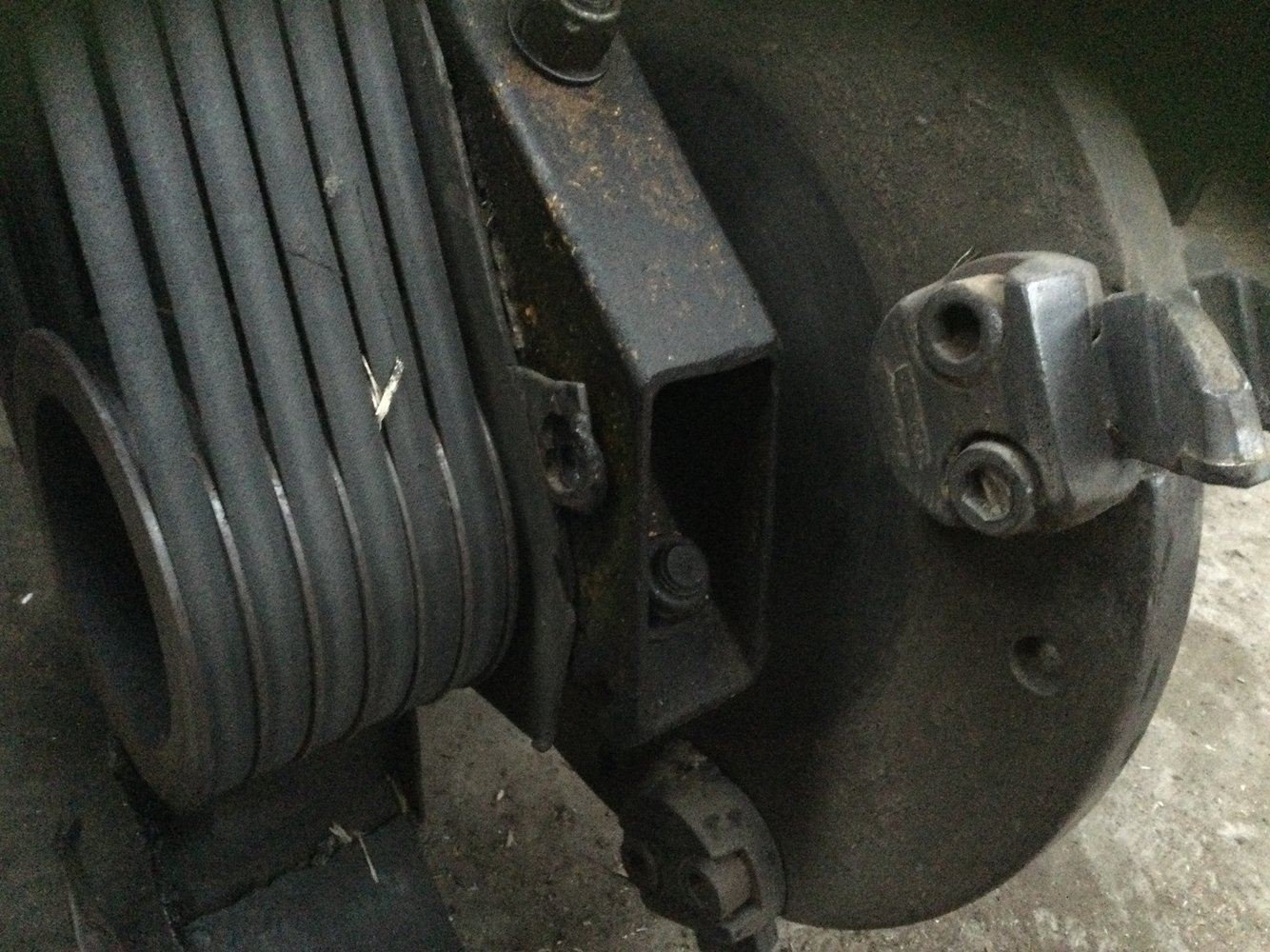

Have you got a fixed steady for your lathe ?

Pull the shaft out from the chuck so you can clock behind the disk where the bearing runs. Set where the other bearing runs true and support it with the steady. It will be running then as it does in the machine and any run out on the worn area can be measured , and the same setup used to re-machine after welding.You may find it helps to centre drill the end after welding and support with a running centre.I've got one of everything.

1610 taper lock bushes go upto 42mm. So, I'd turn the pulley seat down to 22mm or as much needed to get round. Make up a 42mm OD, 21.93mm ID sleeve from a decent grade steel. Cut a crude keyway in it with carefull use of grinder. Assemble machine and shrink fit it on. No way it can slip.
Itll come off easy enough with heat and a puller if needed. The bigger diameter will give the bush and easier job.
Or if the pulley is small Id make up a pulley instead, shrink fit straight on.

I agree, clocking the shaft next to where its welded into the rotor is less than ideal, truing up between centres would be a better job
Bob
In fact, I suggest the ideal solution would be to hold the rotor in the four jaw, set that up to run true and then machine the shaft. If the non machined end of the shaft runs out after that, it's just too bad!

Just watched video.. its not bent just not running true. Clean up the face with the wire wheel and indicate that first.
you should try the round teeth they are brilliant get a good amount of life from themThere is small grinder in the workshop at the moment, this is a typical layout with pillow blocks and multi grooved pulley. You can see the importance of a true running pulley.
very. Even on a small one such as yours there are a lot of forces acting on it. They very quickly find any out of balance or out of true parts and then it self perpetuates.How important is it for a stump grinder to have a "perfectly" running rotor? Compared to say the pulley??
