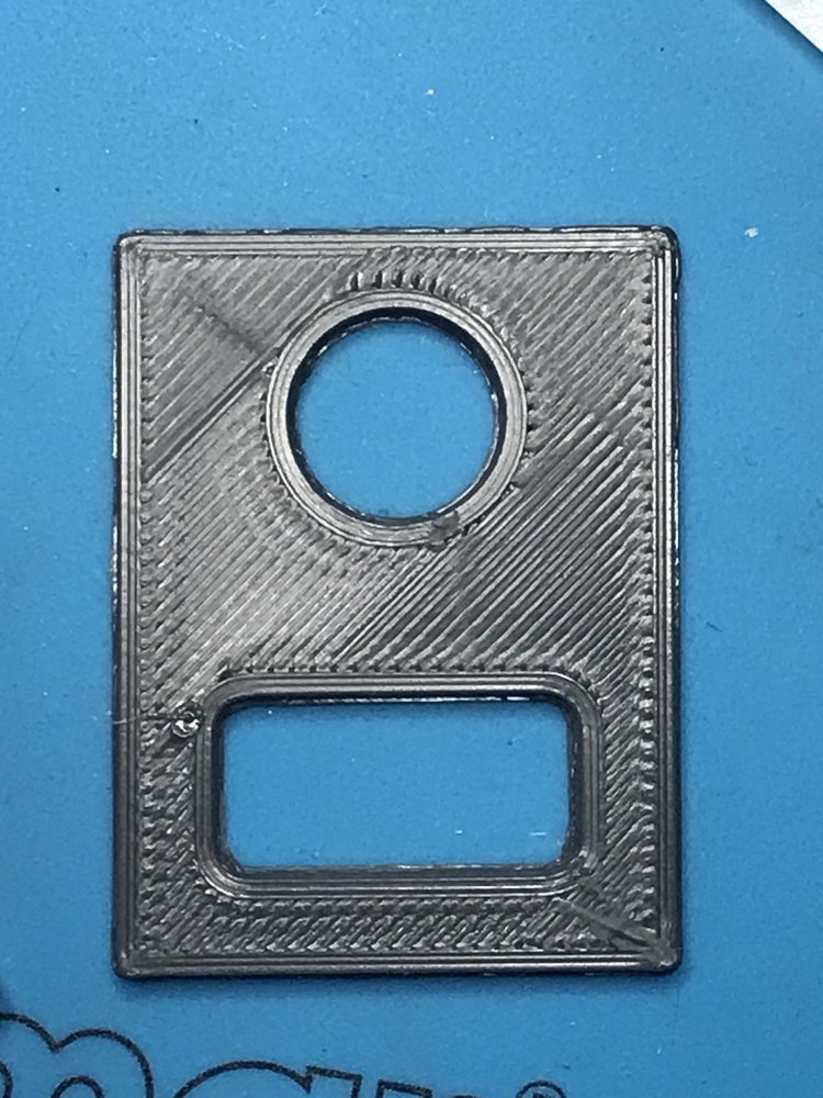

I have created a small test print for PLA. A picture of how it came out. File is later as the original was incorrect format.

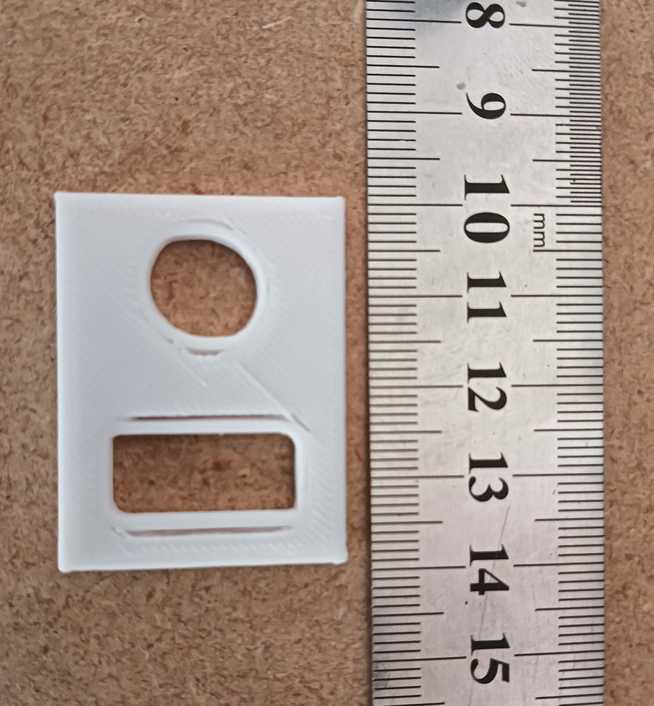

Sorry I missed your post, it was printed in PLA. I have uploaded a test print above.Post the file and I will print one to see what happens on my machine.
What material was that printed in?
I have created a small test print for PLA. Here is the file (I had to change it to .txt to upload, and a picture of how it came out.

The lack of connection between the cut-out section would usually indicate under-extrusion, however the oversize corners would usually indicate over-extrusion.I have created a small test print for PLA. A picture of how it came out. File is later as the original was incorrect format.
Cheers for printing it. I will have a go at adjusting it tomorrow as we are out atm. Yours looks superb!I’ve just printed that, see below picture
As the circular feature in your’s isn’t and it seems to have a diagonal feature in it check the mechanical parts of the printer aren’t binding and causing that problem. If it was an estep problem I would have expected the circular feature to be elliptical rather than what you are experiencing
Cheers, I will give that a go too.The lack of connection between the cut-out section would usually indicate under-extrusion, however the oversize corners would usually indicate over-extrusion.
Before doing anything, I'd give the printer a mechanical check over.
Make sure all the rollers are suitably adjusted onto the extrusions.
Then run an extrusion check. I usually use a steel rule and mark 50mm from a known point, then extrude 50mm of filament, and check that the mark has made it to the known point.

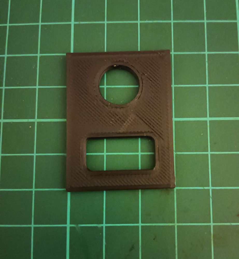

probably a little more adjustment but I am a lot happier with the results!I am using the prusa slicer. There are meant to be 4 but it looks a tad thinI’m not sure what slicer you are using and it’s a little difficult to see on my phone but how many top layers are there in that print?
