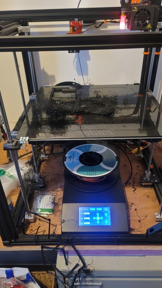

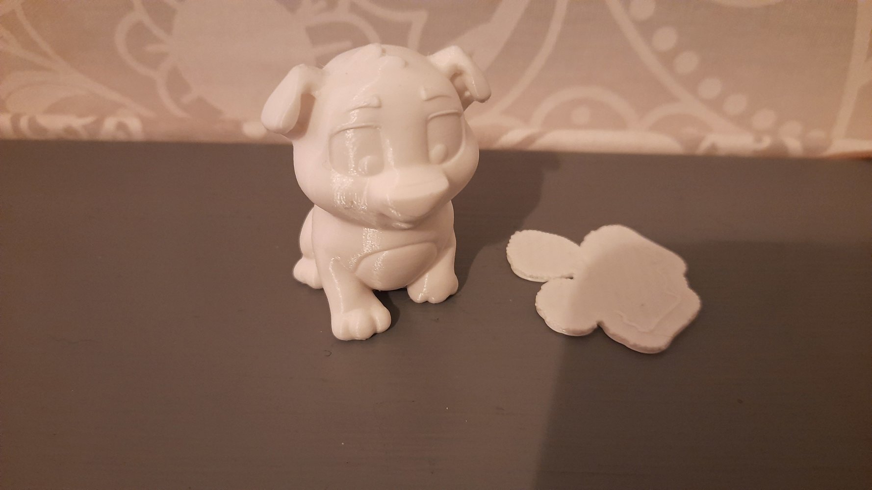

Today I printed a mess
There were 9 objects on the build plate, 1 of them lost adhesion and took out the rest.
Also wiped out the probe on the BL Touch!
If you put it outside at the end of February I'm sure you'll have birds nesting it in by the end of May

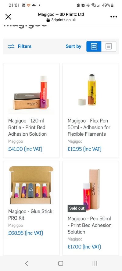

any advice?i had a few early fails today with the print not sticking to the bed, google suggested glueany advice?

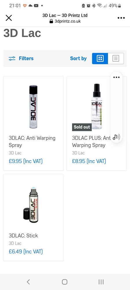

3DLAC spray. Believe they may do it in a rub on stick form now. As above too clean the bed between prints and wipe with IPA.i had a few early fails today with the print not sticking to the bed, google suggested glueany advice?
What printer you got chap?i had a few early fails today with the print not sticking to the bed, google suggested glueany advice?
Yes i used an A4 printer sheetYou:ve checked there isn't too much clearance between the bed & nozzle?
What does the first layer look like, squish wise?Yes i used an A4 printer sheet
I went for an Ender 5 pro, just testing with PLAWhat printer you got chap?
Most newcomers will have too much gap.
If you have got a marlin firmware it will have baby stepping. Which means you can adjust the first layer on the fly.
