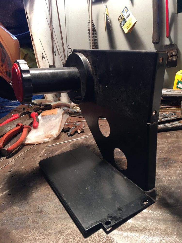

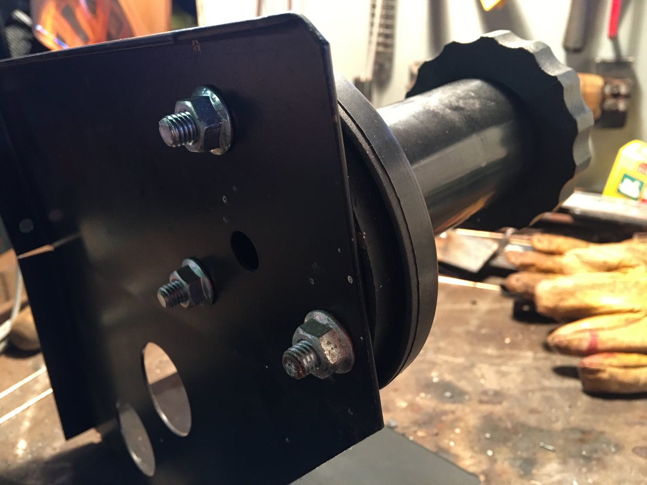

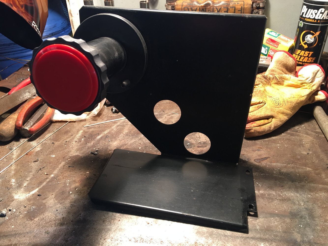

but for now plenty happy as a mechy fitter as well.Hello Damian, Long time no see,Here are photographs of my 15Kg wire carrier, It came supplied by the welding set manufacturer ( Butters/Fimer) and attaches to the rear of the welder with 4 X 5mm bolts, Quite a light carrier but amply strong enough, I still have a 12.5 Kg reel of dual shield that you can pick up next time you are in my area, (Nipon steel 1.2mm AWS A5 20 E 71T 9M-J)Today I made a contraption to see if I can get 15kg rolls to work on my mig.

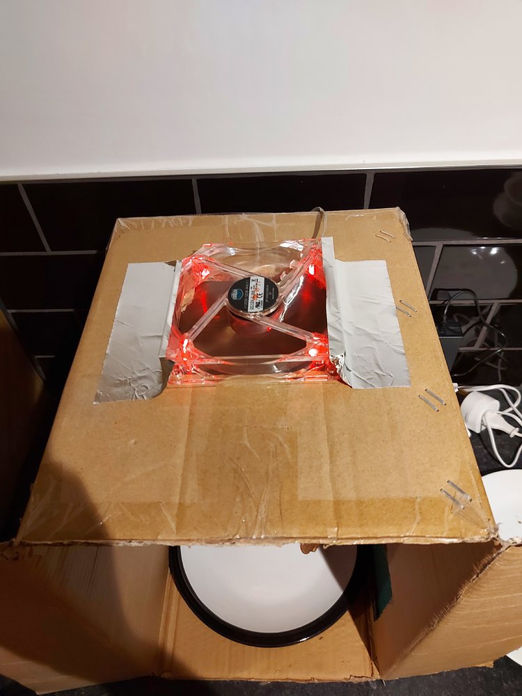

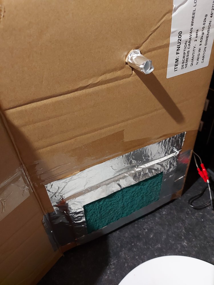

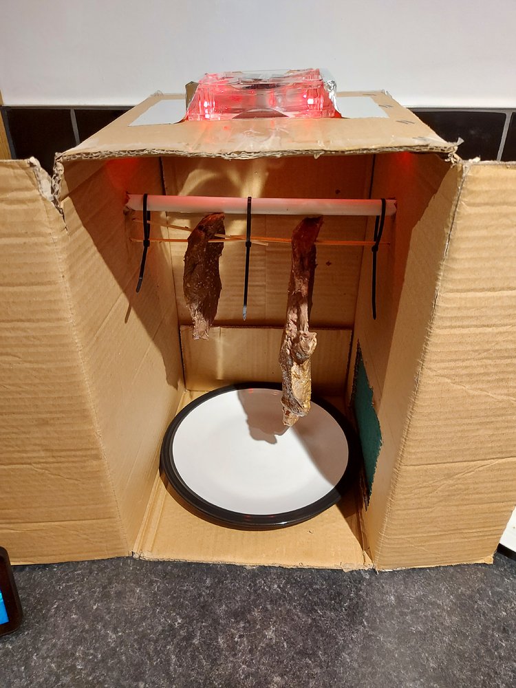

A ghetto biltong box. Fancied some biltong for a while and in tesco found a great lump of rump steak in the reduced counter. So old pc fan, 12v power supply, cardboard box, and some aluminium tape later I have this beauty in the kitchen.
View attachment 317266View attachment 317267View attachment 317268
House is a nice steady 18-22 degrees so no need for additional heating, heating would speed up the process but you risk drying it too quickly, you can get a much more even drying and have a wider window to catch when it is getting too dry. If this was to be left in a colder area I would have made it from wood and put a light bulb on a temperature controller in with it. I may well build a more permanent box with a similar set up, thinking something along the lines of an old countertop wine fridge with fan, heating and cooling on a microcontroller to get more control over the drying conditions. Can branch out into salami and other dried meats then.Did you have a heat source as well or did you just use the fan to dry it out?
View attachment 317512View attachment 317513View attachment 317514

Is that cabling on the RH side of the middle picture the power cord for a low wattage heater bulb placed below the saucer inside to assist the speed of drying ?A ghetto biltong box. Fancied some biltong for a while and in tesco found a great lump of rump steak in the reduced counter. So old pc fan, 12v power supply, cardboard box, and some aluminium tape later I have this beauty in the kitchen.

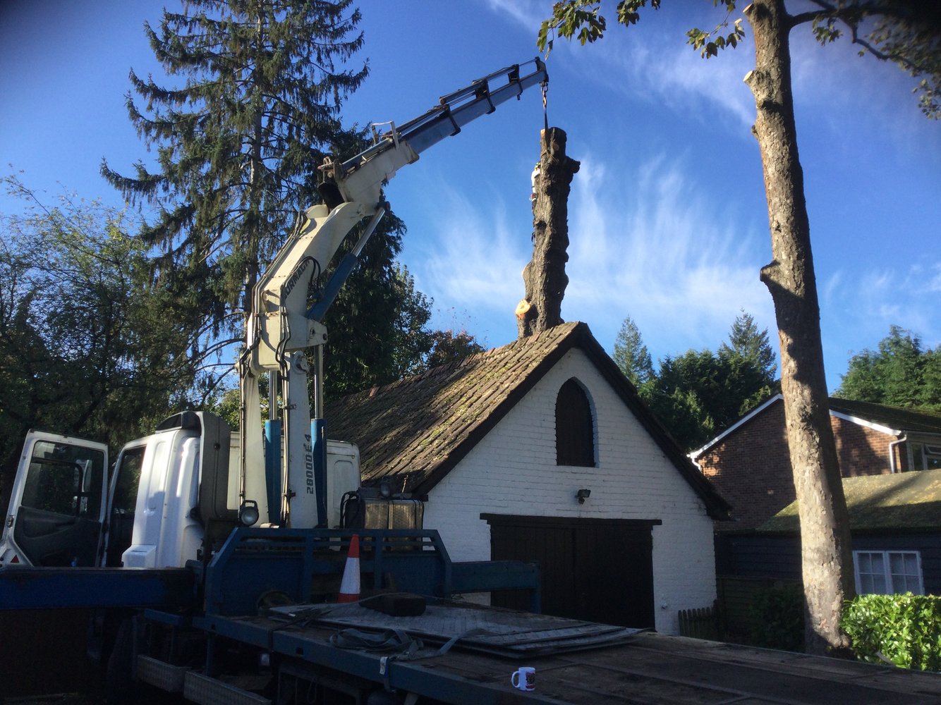

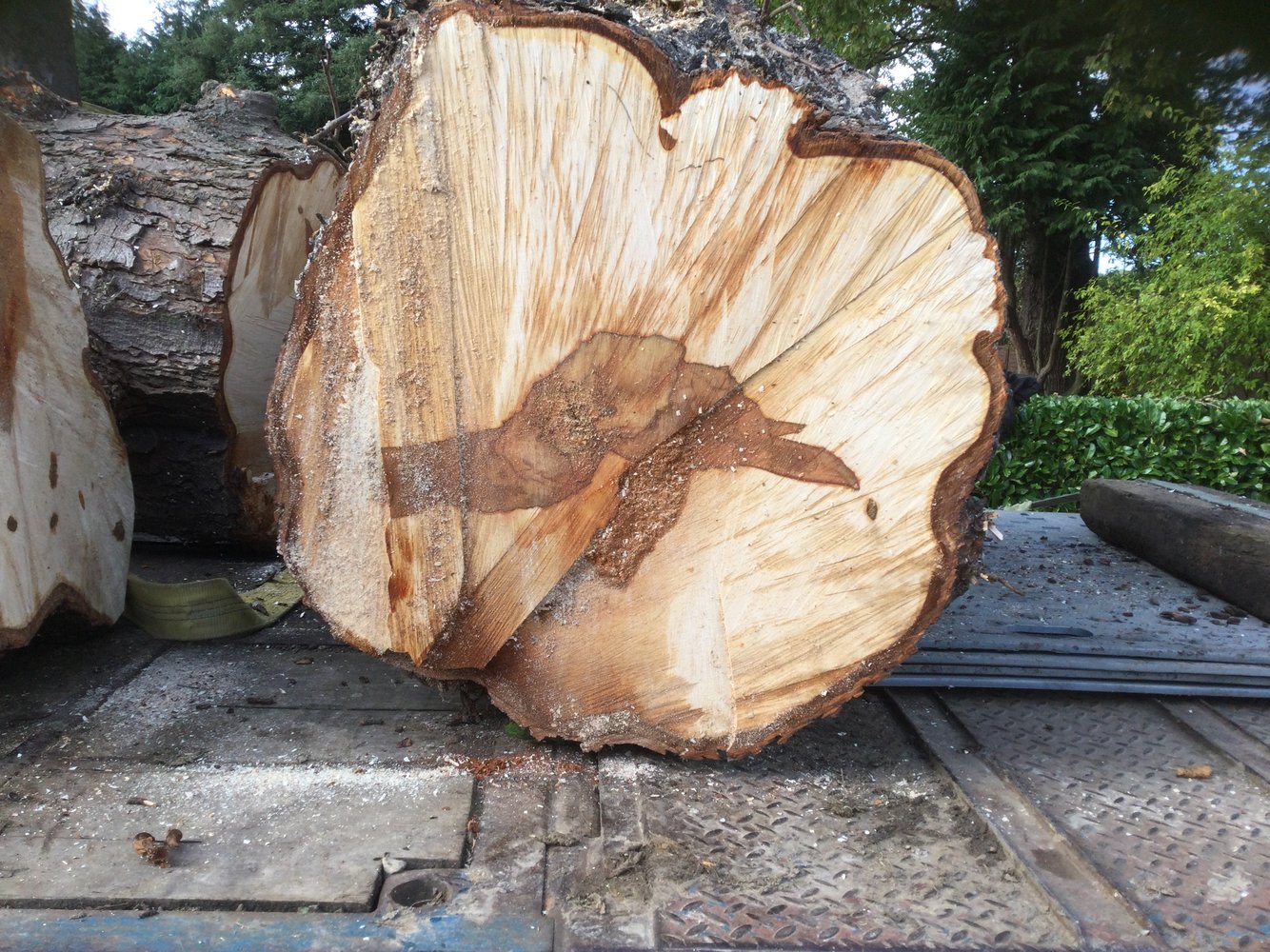

The spalted area infected with fungus adjacent to the rot is a valuable section of wood , if you can get it cut & air dried off the ground as quartered timber ..it's great for turning patterned rods , bowl's, lamp sticks etc.Today I helped our lads make an old Chestnut disappear. They had already stripped it out so I trollied along with the truck and lifted the stick out for them.
Bit tight in there so kept it small
Interesting shape in the rot
View attachment 317393 View attachment 317392 View attachment 317396
