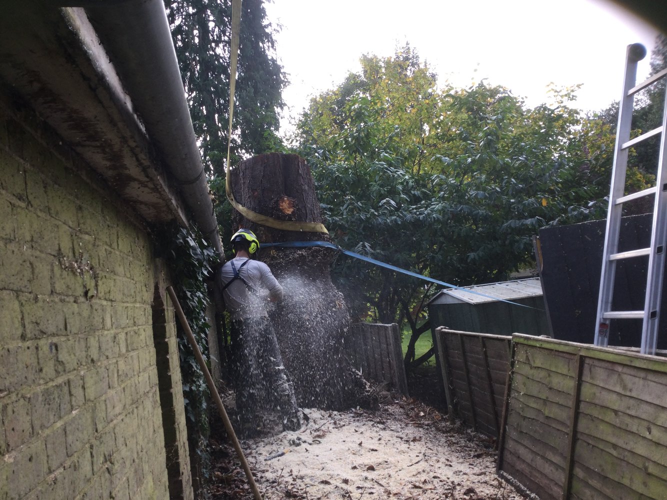

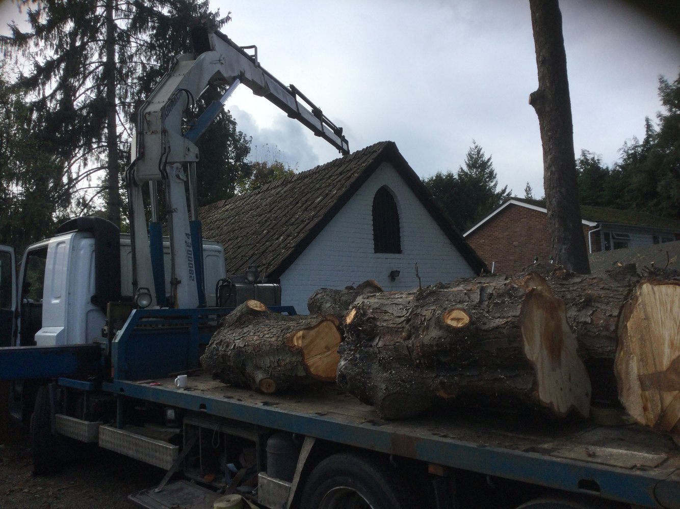

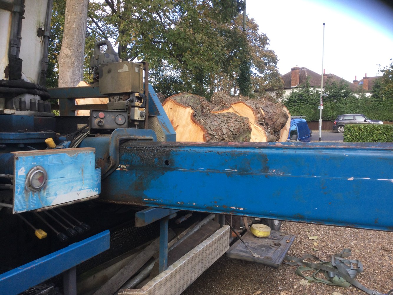

Dont tell greta but that burns nice doesnt it?!Today I helped our lads make an old Chestnut disappear. They had already stripped it out so I trollied along with the truck and lifted the stick out for them.
Bit tight in there so kept it small
Interesting shape in the rot
View attachment 317393 View attachment 317392 View attachment 317396

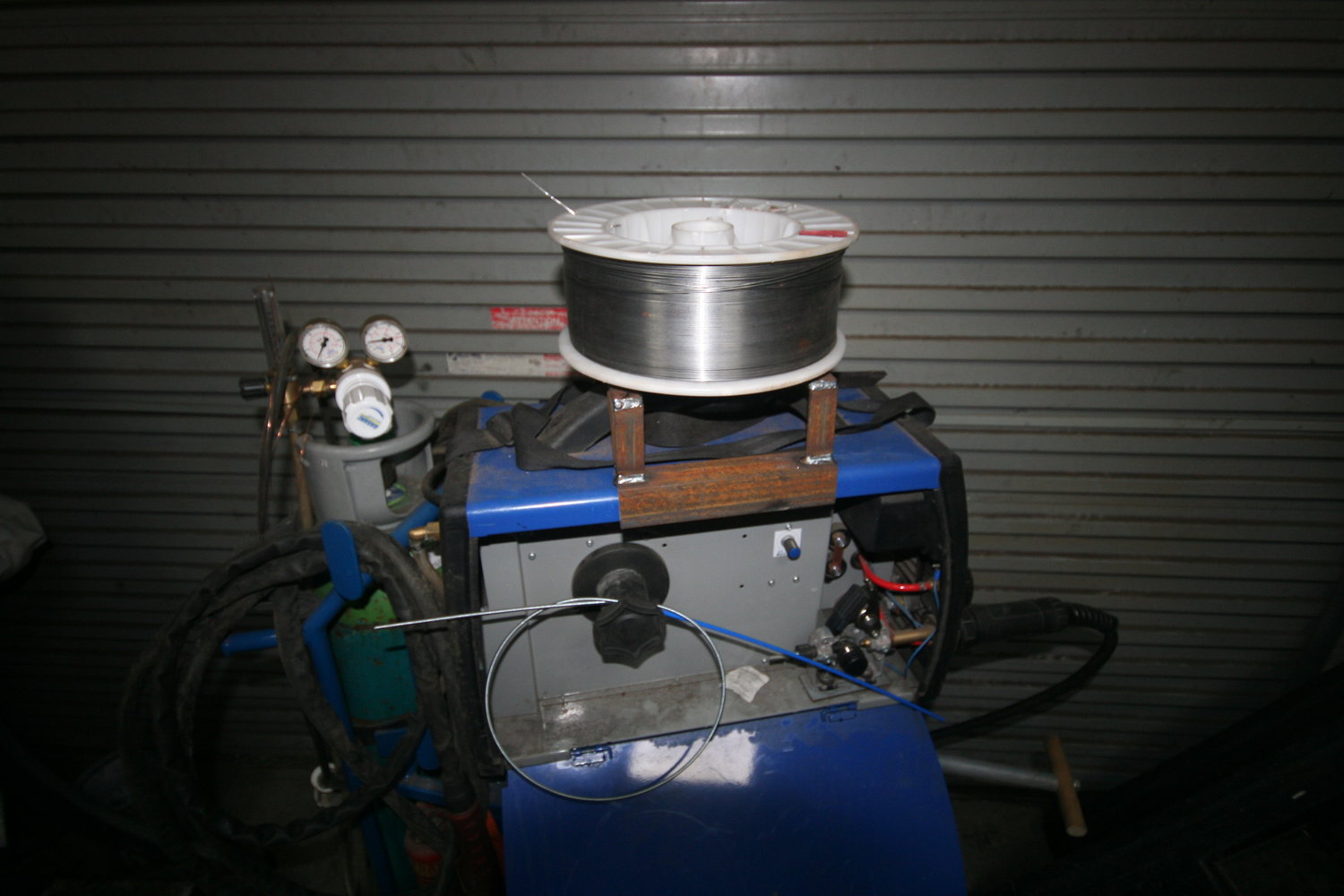

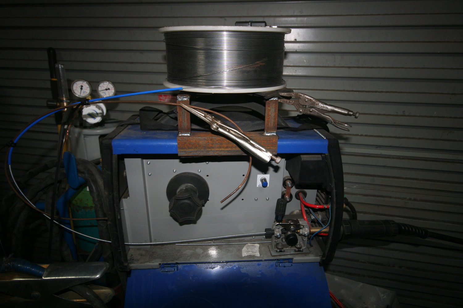

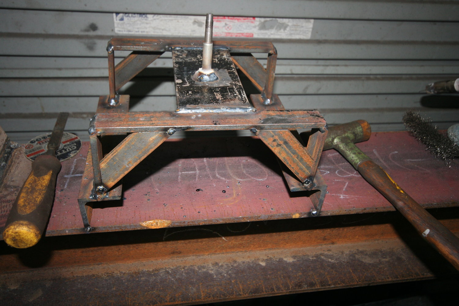

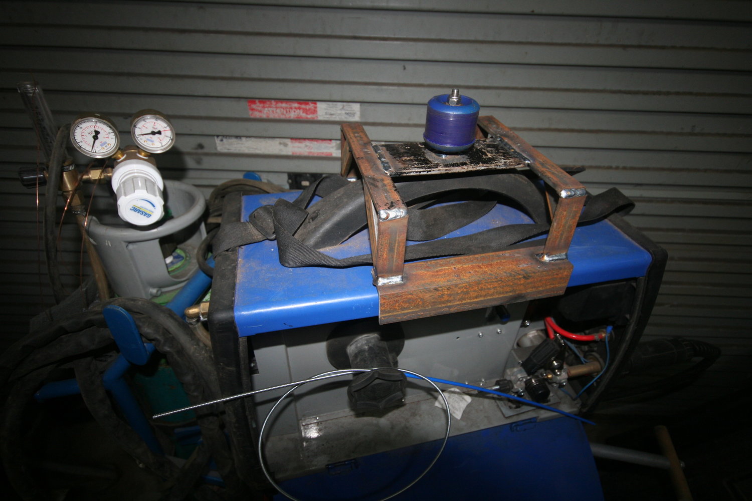

Today I made a contraption to see if I can get 15kg rolls to work on my mig.
The idea came from @gordon stephenson who has something similar on his mig. (I think)
I've an Rtech MTS250 and it takes 5kg rolls of wire.
It's a 250 amp mig and can burn a 5kg roll in short order.
Also I wanted to try dual shield mig and I have a few part rolls which are also 15kgs.
This is just proof of concept, because if the feed mechanism isn’t up to it, it's not worth pursuing.

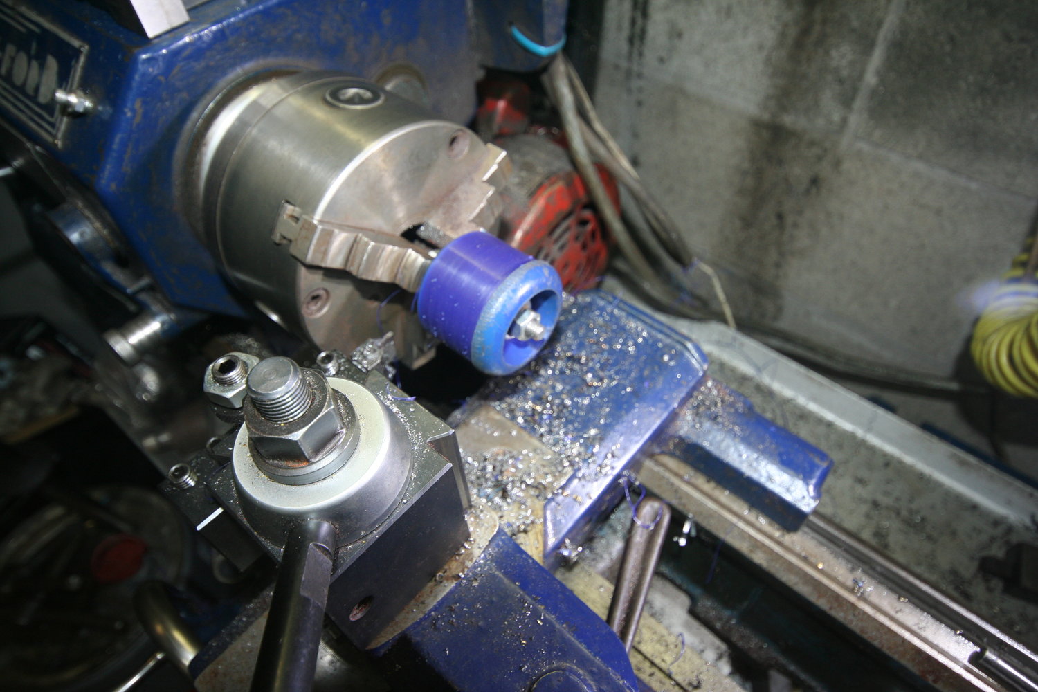

Started with couple of bits of 40mm angle and flat bar.
Turned down a 10mm bolt and an old skateboard wheel to preform axle duties.
Then fitted to the top of the welder with neoprene packers.
An off cut of torch liner, some 5mm bar, more neoprene for back tension, a couple of vice grips and a few cable ties complete the "thing"
It seems to feed wire ok, I will see if it welds tomorrow before I waste any more time on it.
Good point and not something I had really considered.That torch liner might arc on the casing where it passes through the back panel. Have you got a grommet on there?

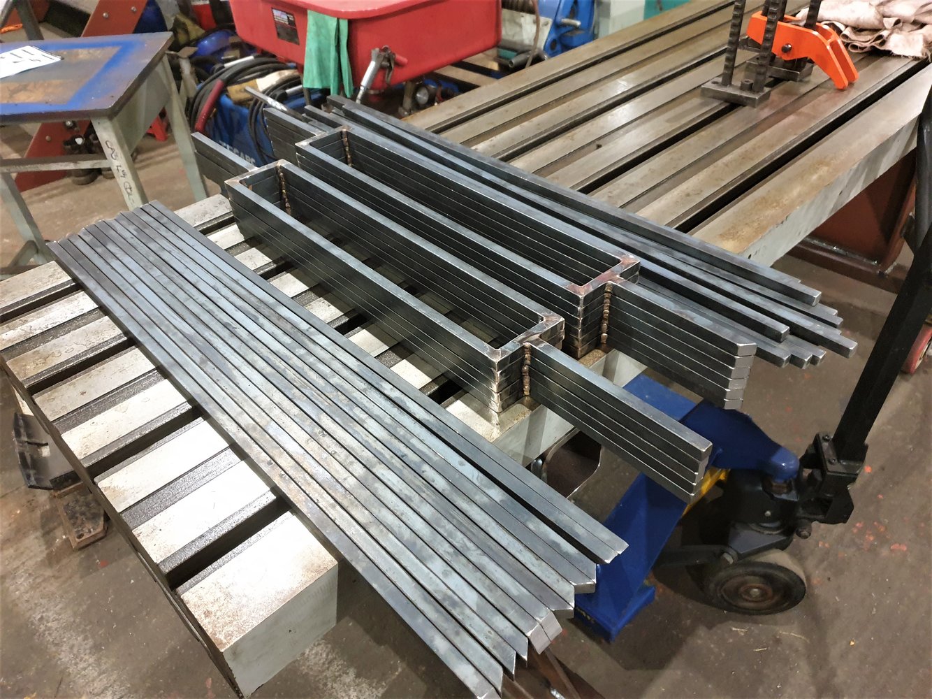

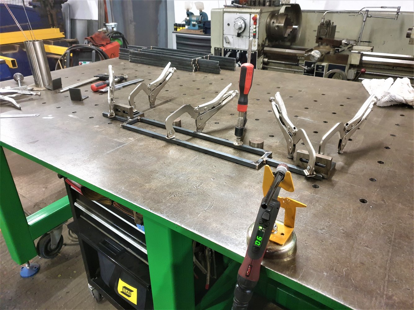

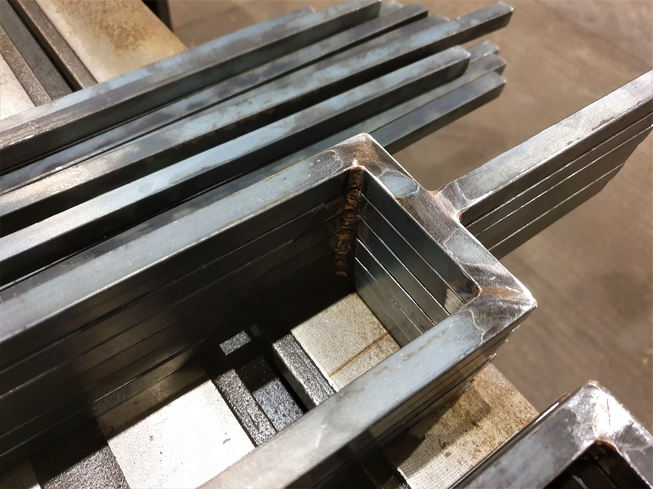

Are you full time now?A small job making some handrail spindles for a local joiner. Quite satisfying to TIG braze them, they're only 12mm square bars so quite fiddly.
View attachment 317498 View attachment 317499 View attachment 317500
Nah not yet. I've a few more things I want for the workshop first before I make the plunge.Are you full time now?
