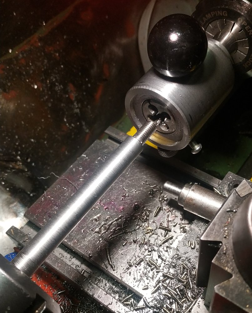

I did that but forgot to fully tighten the nut down before deciding where to put the bar on . marked it in marker pen welded it up .. fully tightened up at three fingers tight the bar went across the work to 7 o'clock ... Back to the drawing board & angle grinder .An m8 thread for the knob
Which will become my toolpost handle. I have been looking for this peice of en24t for about 2 weeks!
Will be an excuse to try the welding magnets tomorrow to tig handle onto nut.
Another style I tried was some easy turning hex off cut nearly 2 " AF this time after facing both ends I tightened the hex down with a big spanner , re faced the bottom end to get the flat at right angles to the centre line a couple of times , marked the position , then welded a small nipple on the opposite side to give me an angle when it was in the drill vice . Tapped it through to the middle , threaded the bar then turned the top into a cone shape leaving a good 35 mm of hex below the cone put a flat on the hole & Loctite'd the bar in . It was OK most of the time .
I've now reverted to having a big double ended offset open jaw spanner that fits the securing nut the QCTP , with the smaller end being ground out to fit the tailstock securing nut . Keeping it handy by using a strong magnets glued into some plastic that's screwed the table at the RH lathe end .
