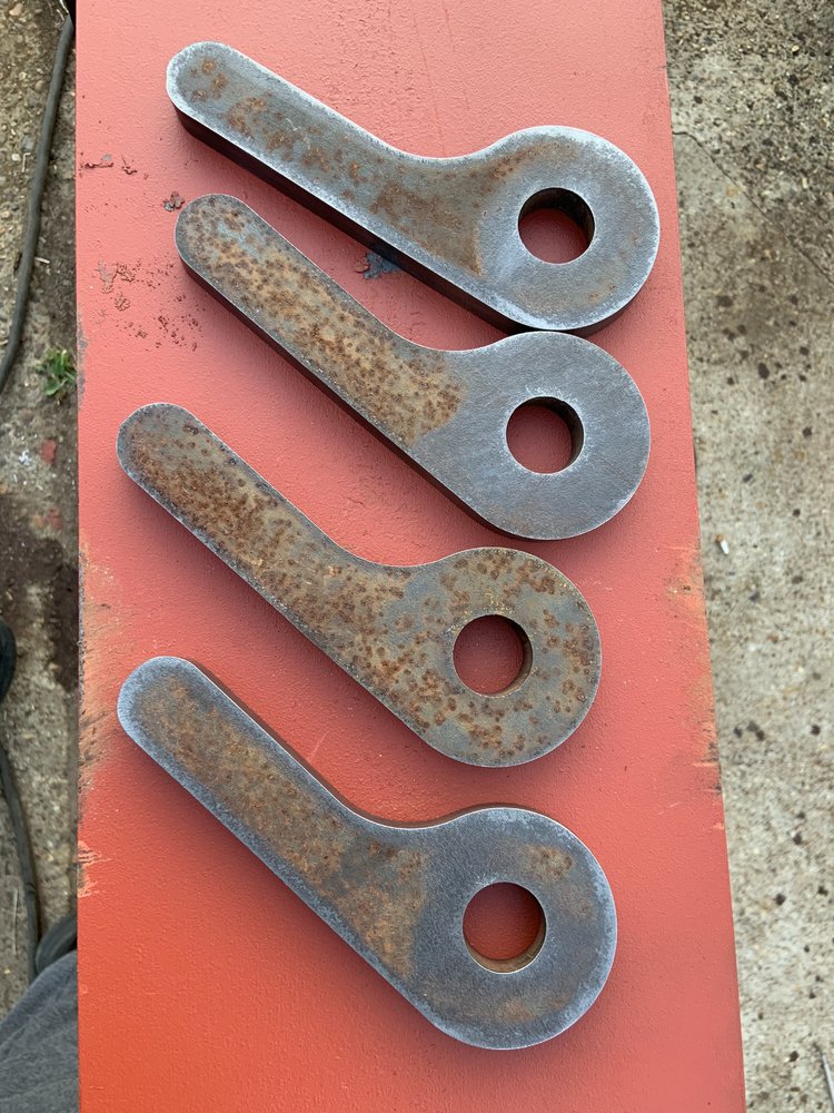

Plasma table working atm? Did you ever get any sensible reply from them?
You've got it cutting well again?
Could do with a price for a 305mm disc in 15mm actually. Also I pmd you on insta a while ago about another grinder rack.That's 15mm plate
I did see your message mate I've just been in a very low, unmotivated place to be honest.Could do with a price for a 305mm disc in 15mm actually. Also I pmd you on insta a while ago about another grinder rack.
I know that feeling. Having a very hard year tbh. Keep at it mate, if there's anything I can do to help just shout.I did see your message mate I've just been in a very low, unmotivated place to be honest.
Me too...I did see your message mate I've just been in a very low, unmotivated place to be honest.
I know the combine a friend's farm runs weighs the yeild then adjusts next year's GPS sprayer

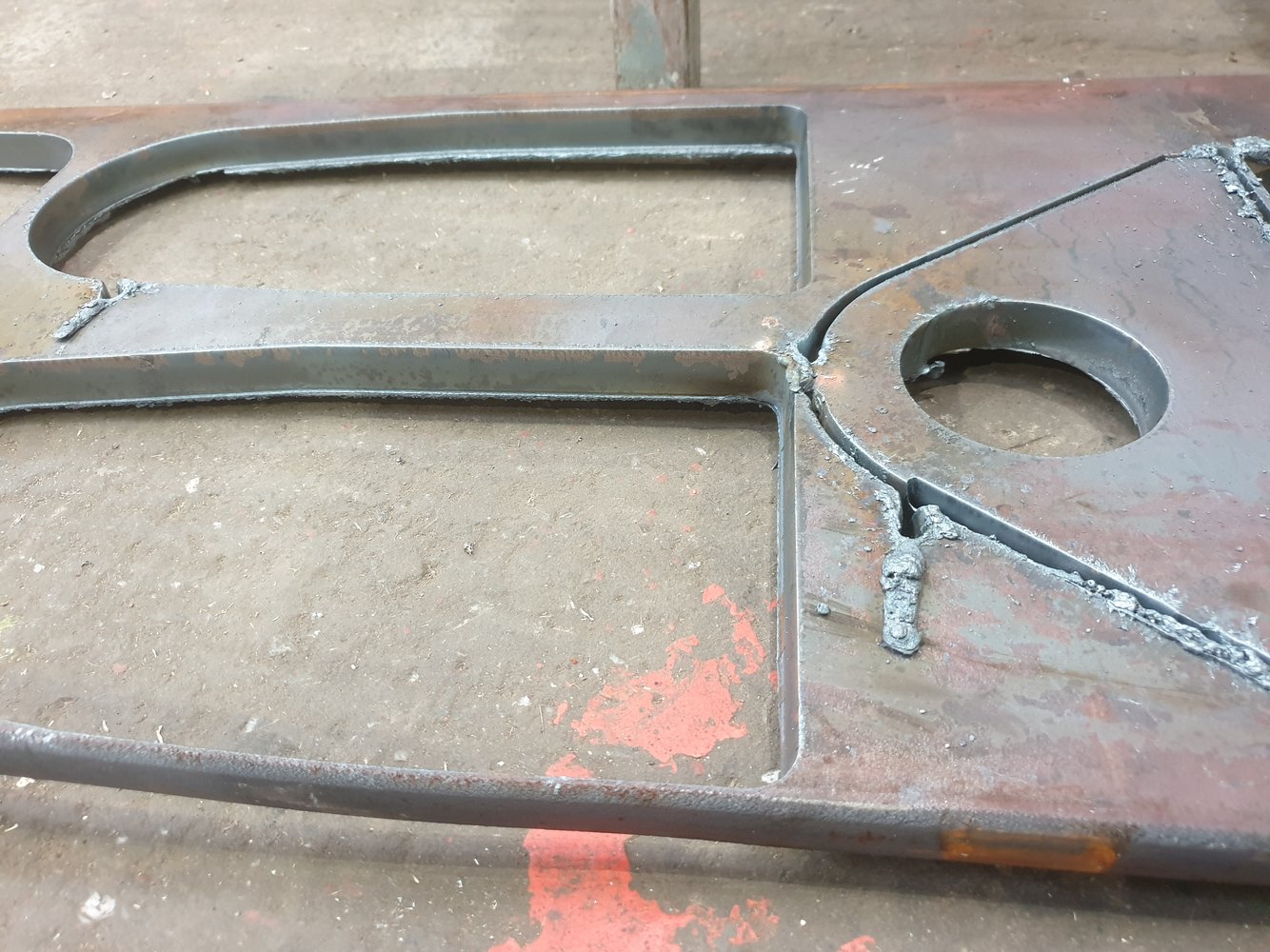

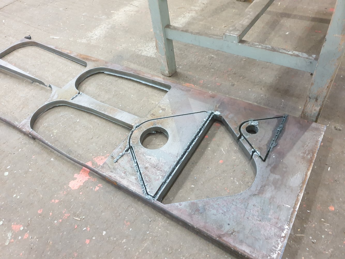

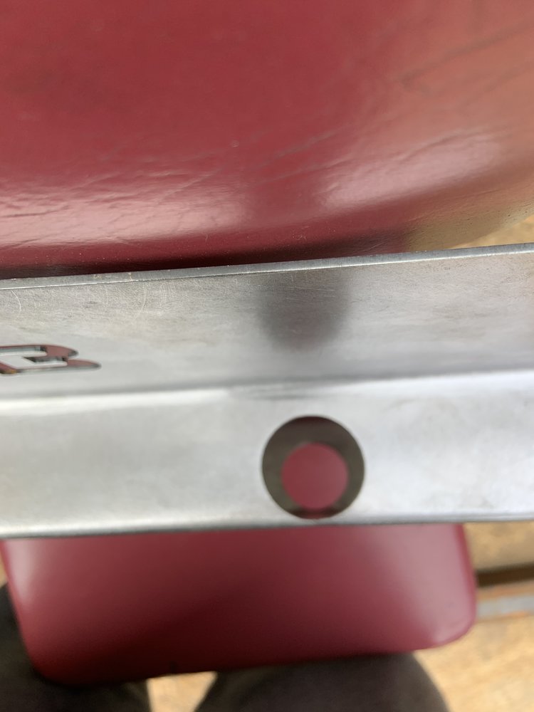

Those holes look just great and also the edge finish. We can all assume that the problems of the past are off the past?
Sorry to hear that. I have been cutting 10mm 316 s/s with the new nitrogen generator and have been experimenting with settings and holes, the taper inside the holes with nitrogen is much greater than with compressed air at the moment, but hoping that i can improve it.Unfortunately no. The hole taper is still terrible (pat is going to bore these out so no bother)
15mm only looks good because travel speed is at a snails pace (bear in mind they slowed the machine down)
6mm, 8mm absolutely crap.
3mm with new fine cut consumables, okay. Not the best but workable.
What are they doing about it. Well they sent me one sample piece their machine had cut, it had as much bevel as my machine. Our machine used to do 10x better cuts than what they sent. They think there is nothing wrong.
I thought it was the lip alignment gauge for your D bit grinder at first, hard to get an idea of scale.That's 15mm plate

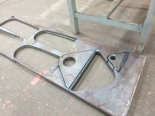

It looks pretty darn good to me, all things considering! You should see the taper on the 20mm parts off an old Messer table i got the other week, look at the skeleton edges in the first pic:Unfortunately no. The hole taper is still terrible (pat is going to bore these out so no bother)
