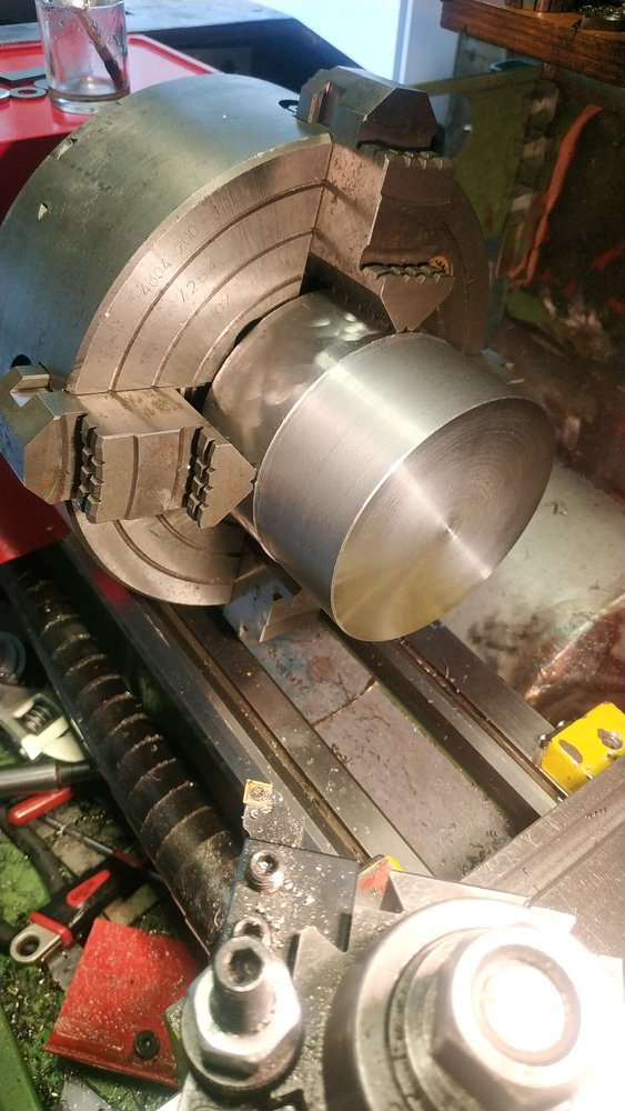

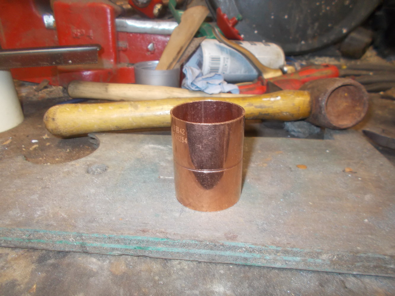

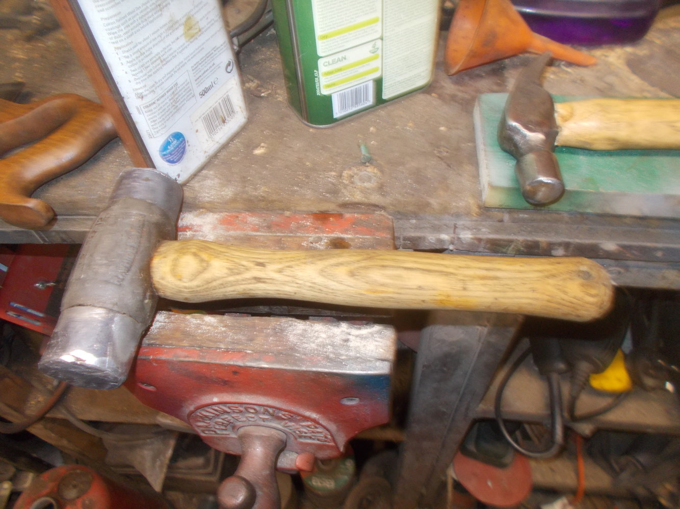

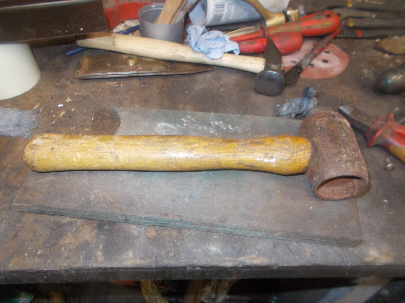

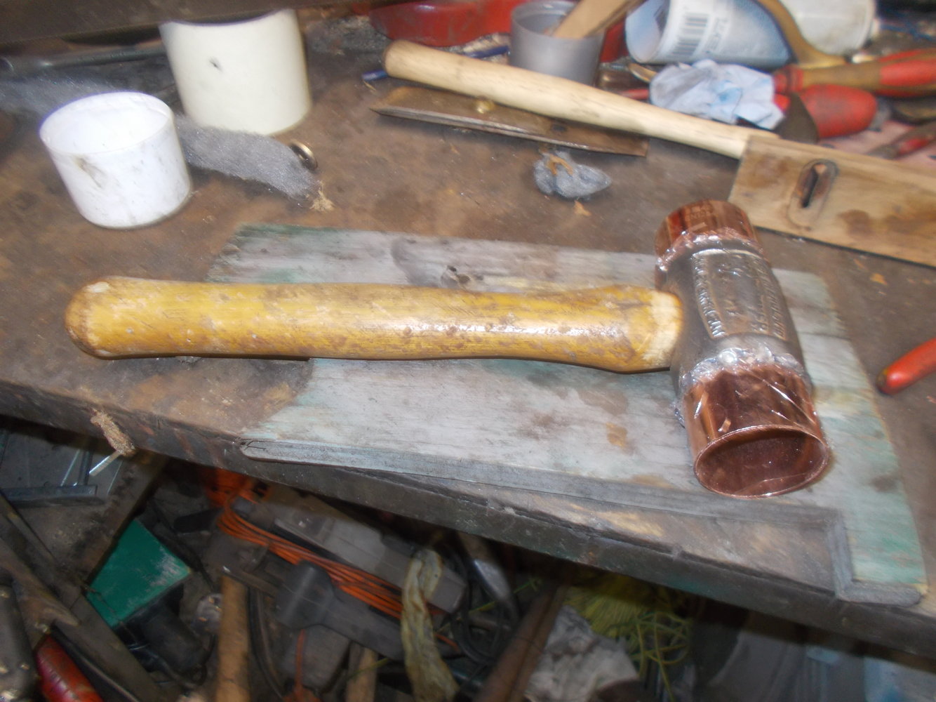

Can't be arsed with the constant toolpost repositioning.Browsing YT last night and I quite fancy having a go at this, he faced it with silicon bronzeI was given this Thor hammer the other day.
Replacements heads are available, but can be a pain to fit.
So I brought this.
That will help make new heads.

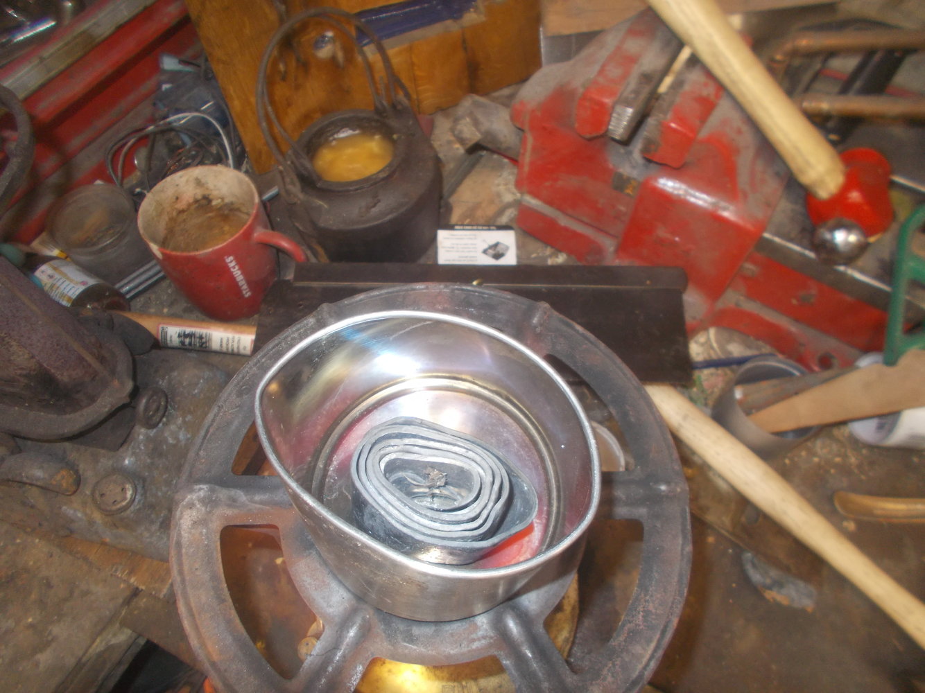

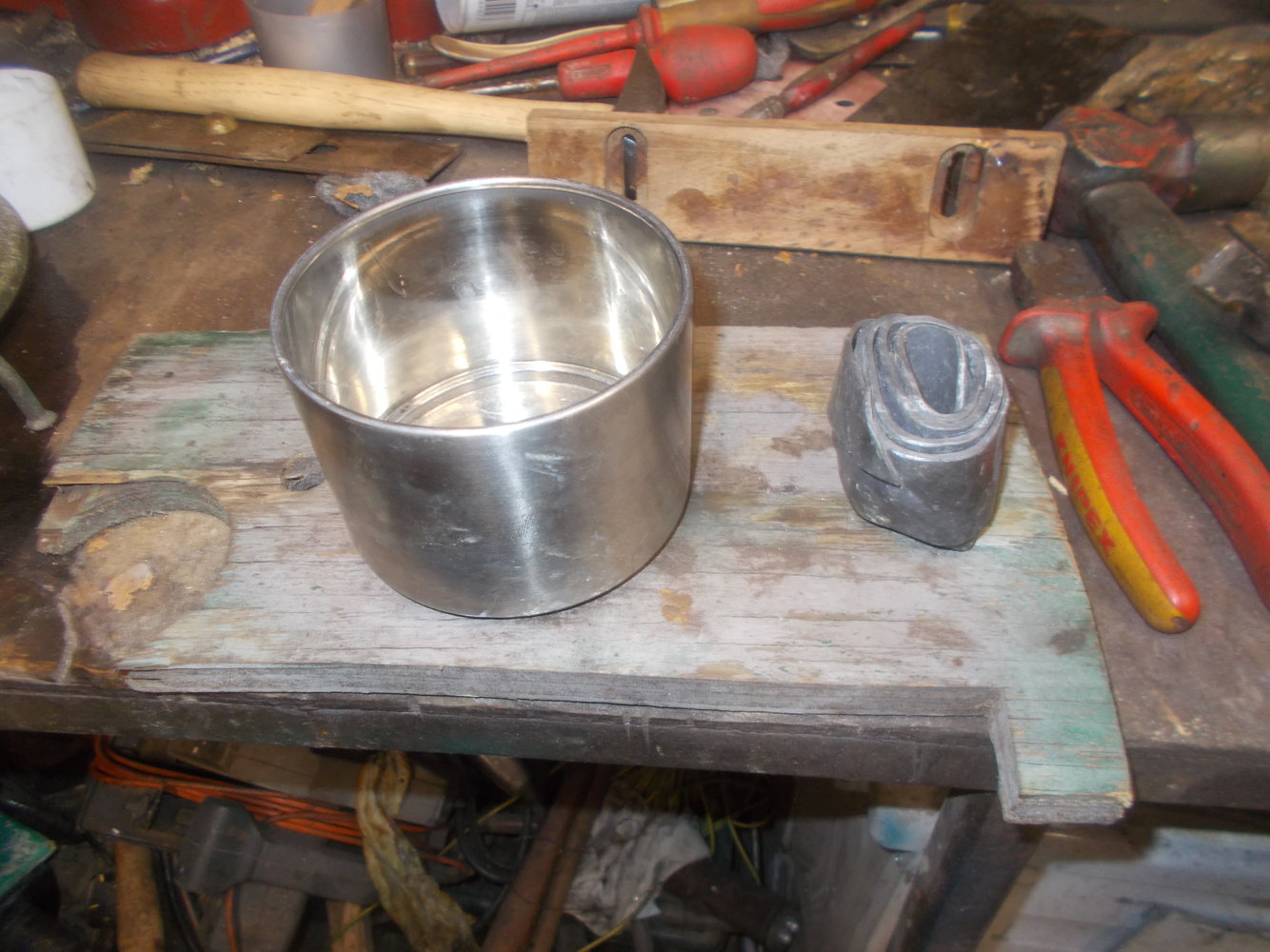

Raiding my rubbish pile, had me some lead.( I had in total 6kg of lead)

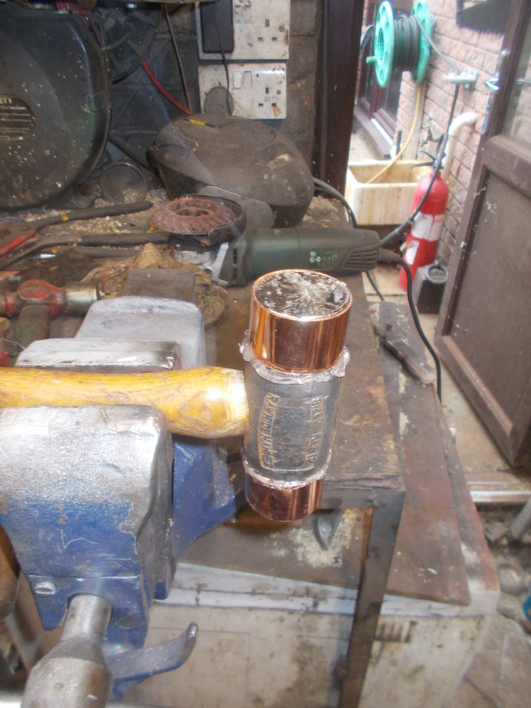

The copper is glued onto the head, to act as a mould,
Melting the lead, the pot was bent to allow an easy pour.
First head cast.
The shrinkage meant that the lead did not stick the copper.
Finished.

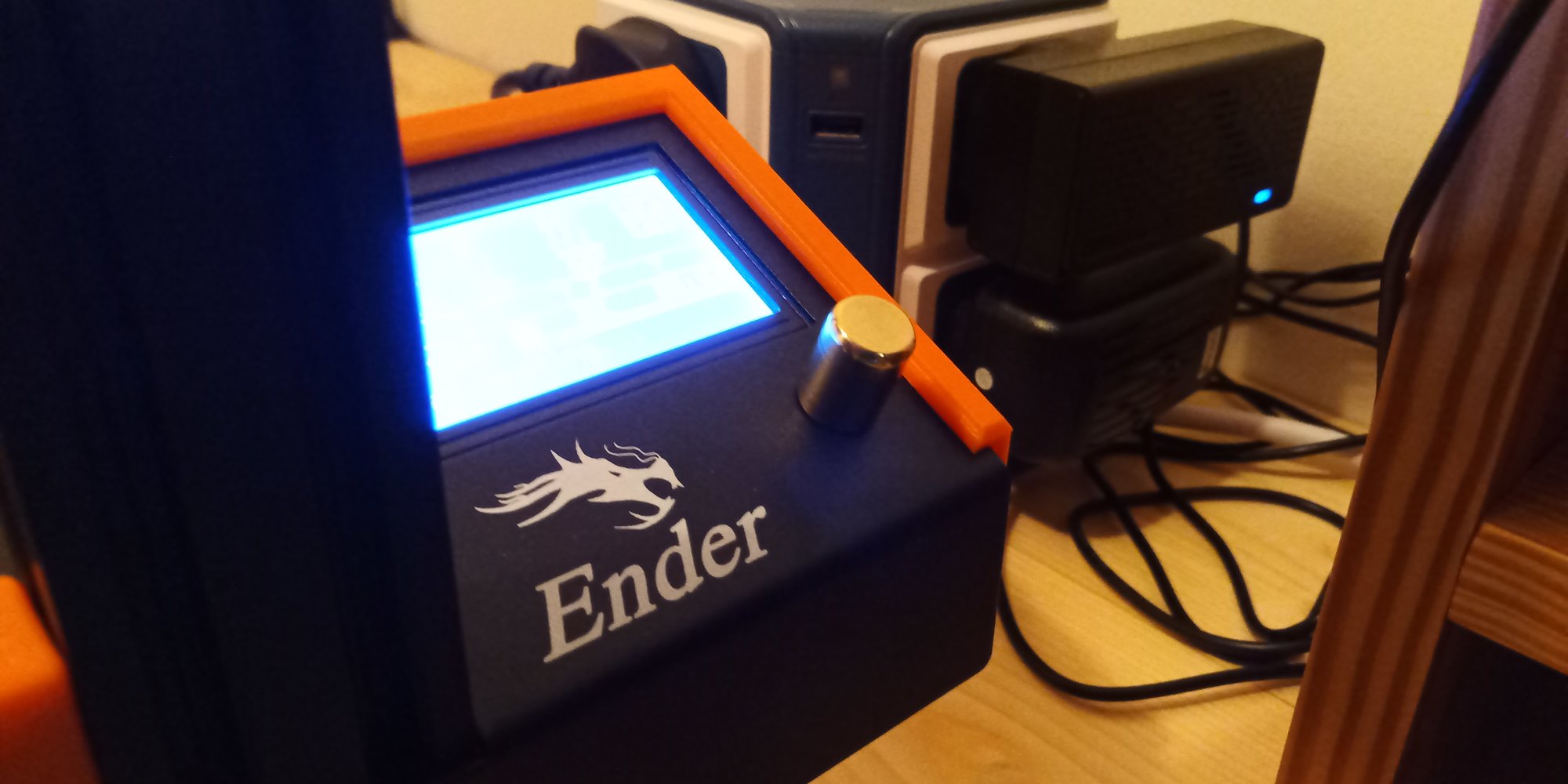

A brass knob. The original just wound me up as it had a pointer on it, when there's nothing to point to.

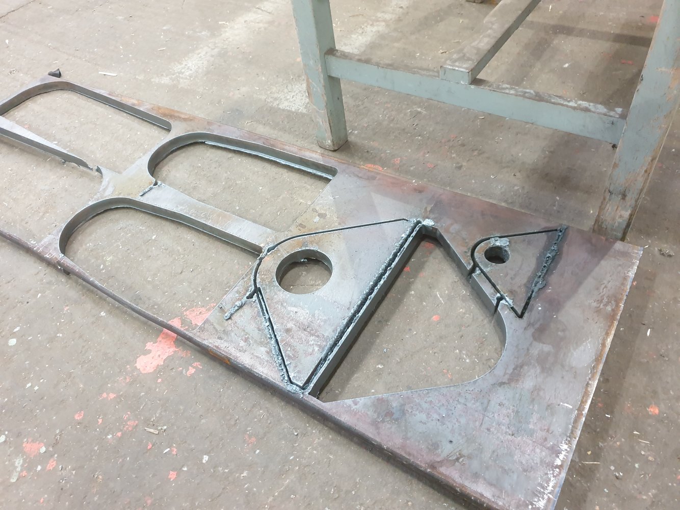

These brackets got a mix of Chlorobenzotrifluoride, Ethylbenzene, Manganese ferrite ,Acetone and some other stuff.
Looks good, have you used that mix before? How does it last?These brackets got a mix of Chlorobenzotrifluoride, Ethylbenzene, Manganese ferrite ,Acetone and some other stuff.
