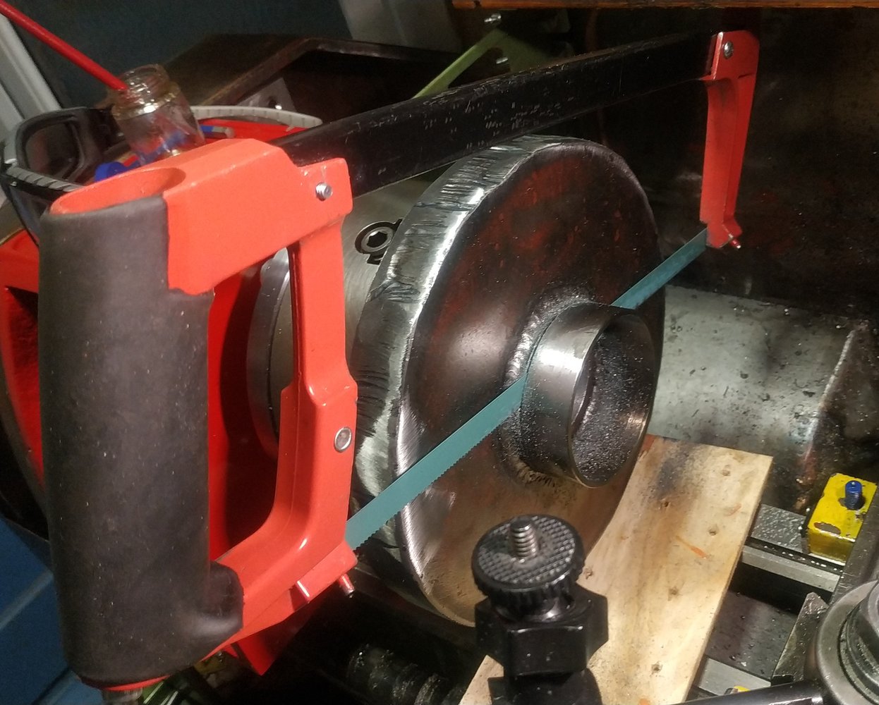

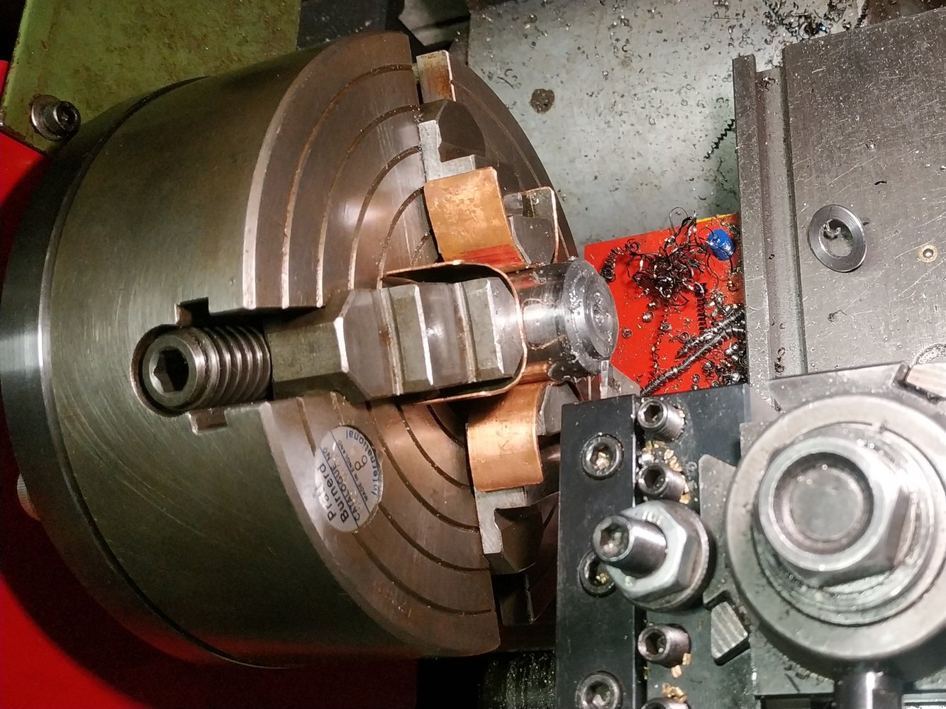

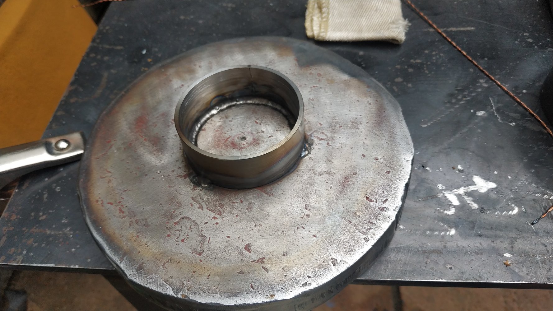

Im not so happy with the chuck today. I wanted to test it on something the lathe struggles with - en19/708m40. Chucked a 30mm bar and needed to make a 21.5mm x 12.5 x1.5mm washer. It kept moving until I added the copper shim. Parting was a massive pain, and had to swap the iscar tool which doesnt normally work well for me.
Im not sure its the chuck, but Ive parted this bar held in collets, chinese inserts and 3-4x higher rpm without much problem.

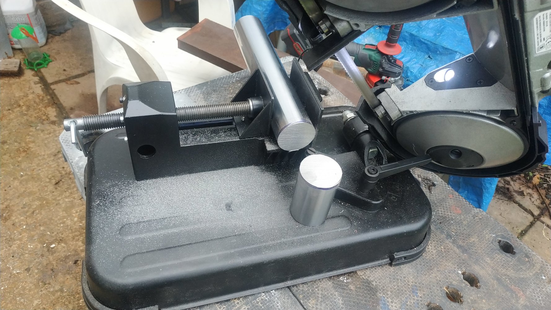

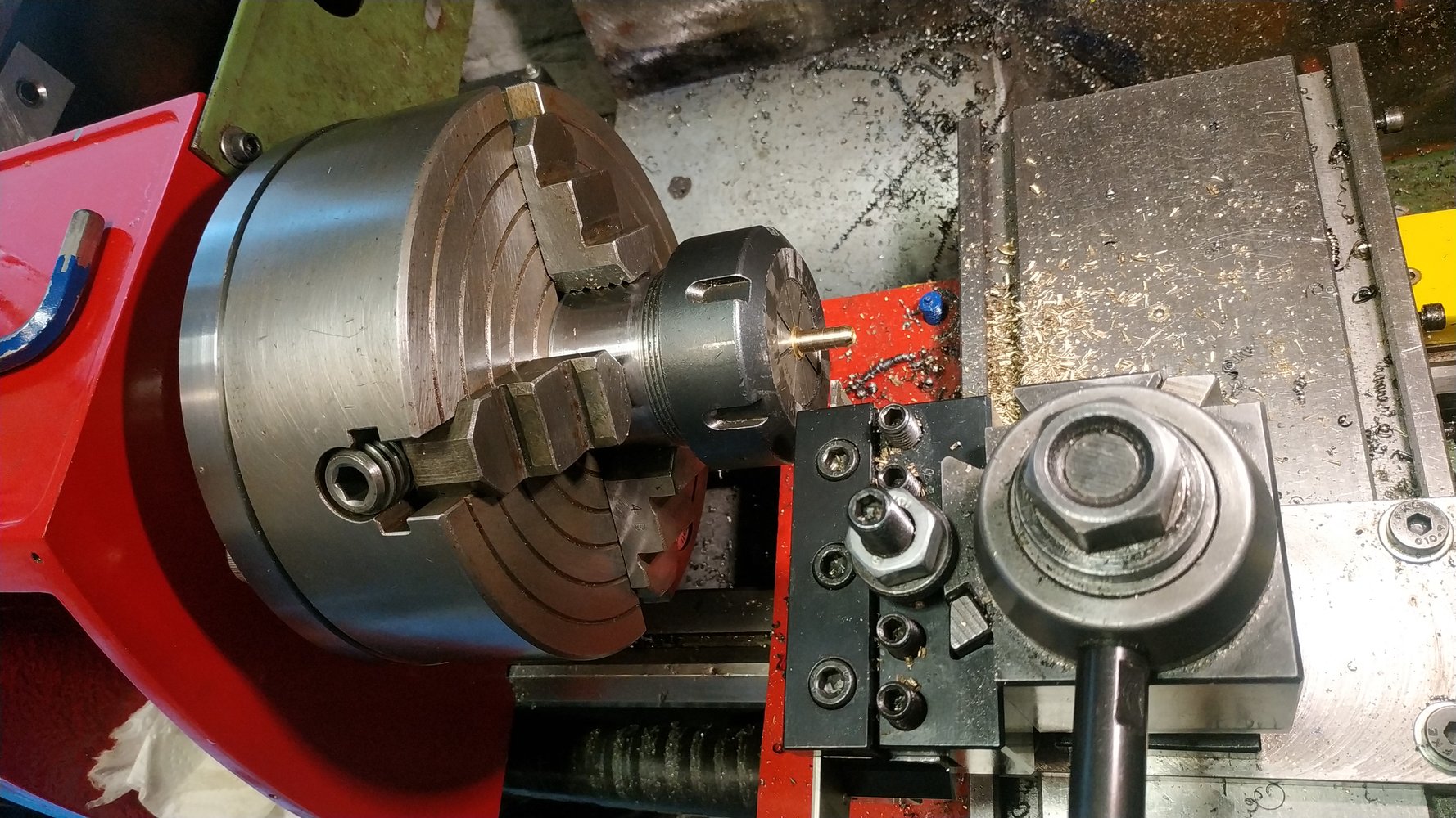

I then needed to male an m12 nut. After doing the washer I wanted something easy, used brass. Reassembled the aldi bandsaw vice with the new parts.
