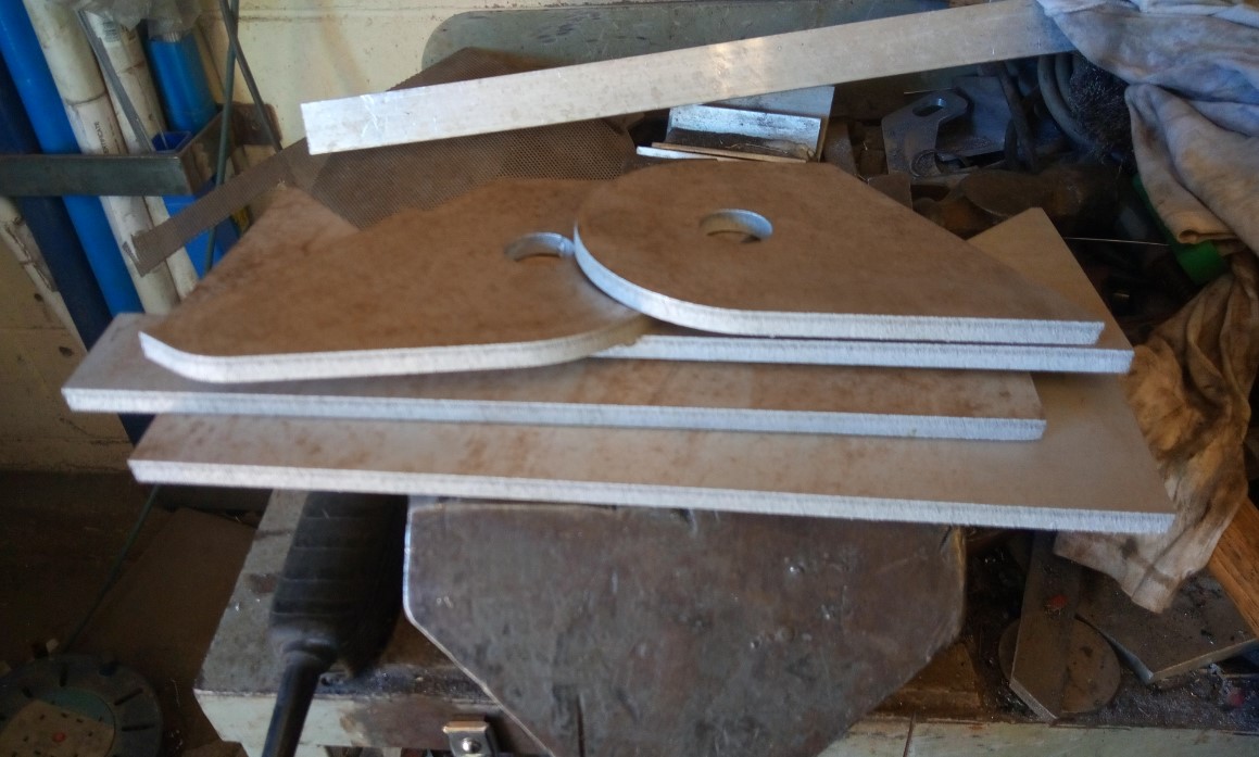

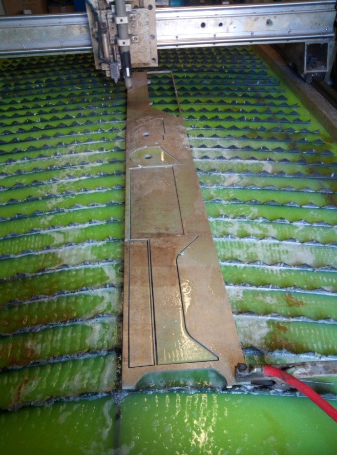

Yesterday I cut some 8mm stainless on the plasma.
I was a bit annoyed as I had made it oversize on the OD and undersize on the ID as I wasn't sure how it would come out. It cut way nicer than I expected so I could have saved myself some machining.

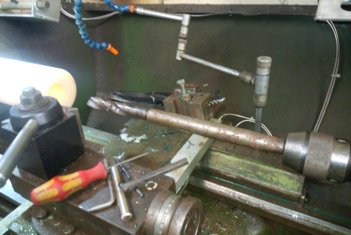

Got the OD and ID turned to size and some 8mm holes bored in it and then welded it to some 2" NB pipe.

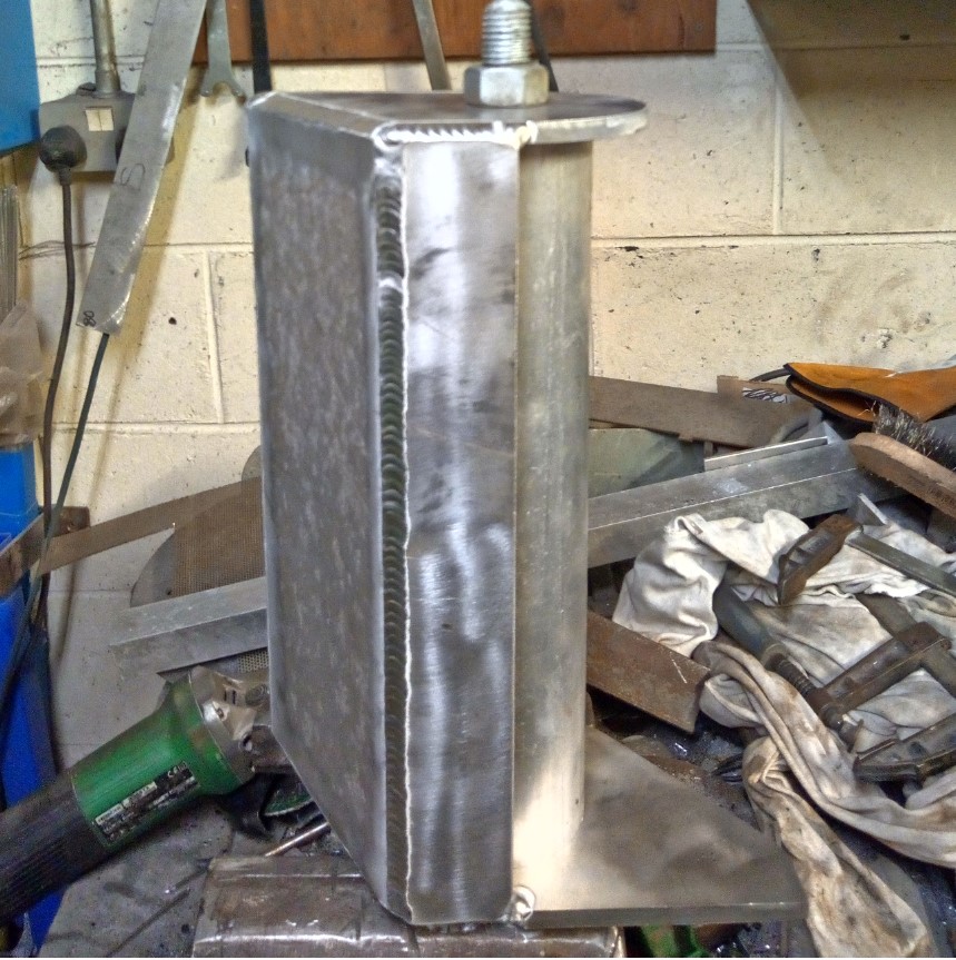

Also got the rack for the Capto holders sorted, yesterday I had forgotten about the tailstock lever and it was fouling the rack so today I slid the ordinary tool holder back on the shelf, chopped the front box off and rewelded it 100mm further back then fixed on the capto rack and it is now good to go.
