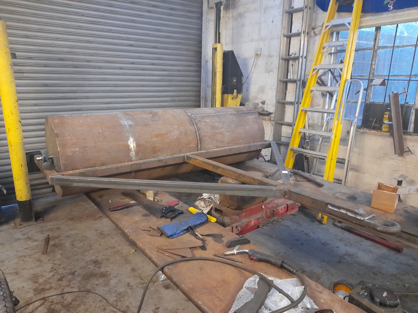

Wouldn't it be easier put a couple of plugs on an end to fill with water, so you can adjust the weight for the soil conditions; a fixed weight can bog down in mud after heavy rains.Field roller for the missus horse paddocks! just some flatting some welds on the roll, fill with concrete and a lick of paint View attachment 288098
Maybe although its fairly thin metal i have made it from, old 3mm ventilation pipe scrap fill it with concrete it will be a bit more substantial that, it will be around 1.2 tone when done being pulled by a MF590 the land is fairly light any way should be okayWouldn't it be easier put a couple of plugs on an end to fill with water, so you can adjust the weight for the soil conditions; a fixed weight can bog down in mud after heavy rains.
With water filled you either want it empty or full, anything else and they slosh about shoving the tow vehicle, on a horse paddock it's probably a quad or a 4x4. Obviously a tractor of any decent size isn't going to be shoved about by 1t of water.Wouldn't it be easier put a couple of plugs on an end to fill with water, so you can adjust the weight for the soil conditions; a fixed weight can bog down in mud after heavy rains.
1978 massey ferguson 590 will be the tow machine, concrete filled will be okay I think personally more practical than water filled for my use.With water filled you either want it empty or full, anything else and they slosh about shoving the tow vehicle, on a horse paddock it's probably a quad or a 4x4. Obviously a tractor of any decent size isn't going to be shoved about by 1t of water.
...it will be around 1.2 tonne when done...
It is indeed 600mm diameter 1950mm length. 0.55 cube so around 1.4 ton total steel and concrete (my estimation was a tad out but not bad for the top of my head)Could you give us some dimensions of it please. Diameter and length. Concrete is about 2.4 tonne per cubic metre (1000 litres) so the volume would be about 0.5m^3 for that weight.
590 will have no problem with it.1978 massey ferguson 590 will be the tow machine, concrete filled will be okay I think personally more practical than water filled for my use.

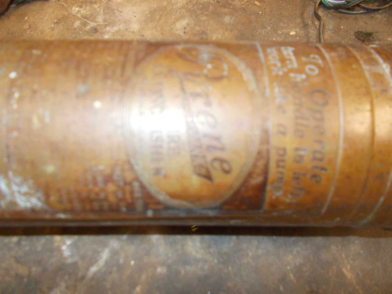

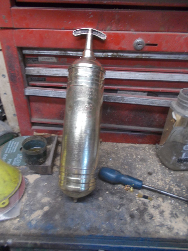

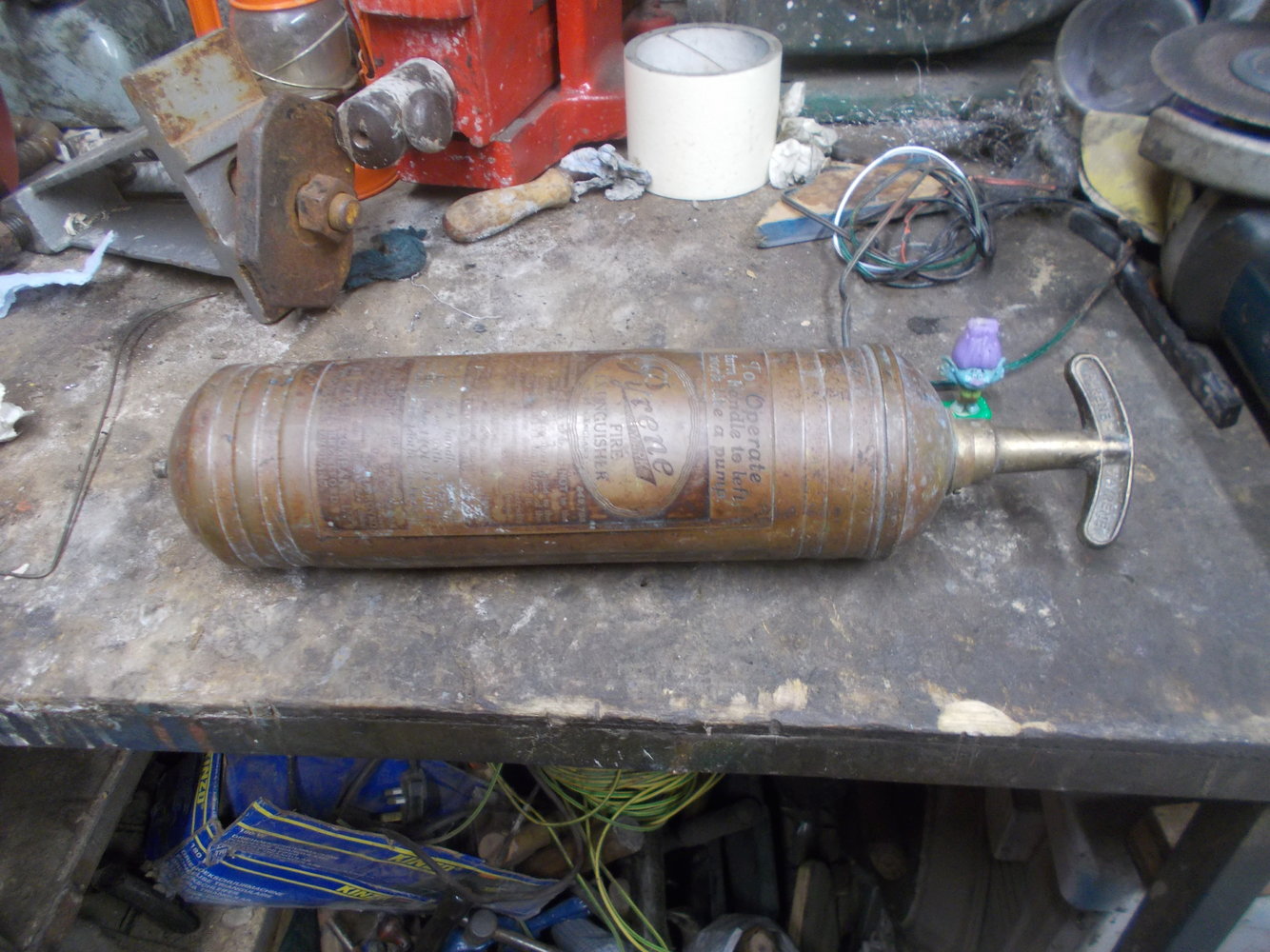

So in between naps I striped, cleaned, serviced, polished and refilled this old fire extinguisher.
I do like these, not as a fire extinguisher, but the look and the use I put them too.
Cat deterrent or weed killer spray.

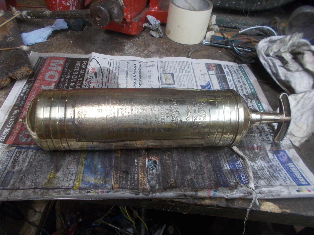

The cleaning was first with wire wool and warm water. Then wire wool and metal polish.
One final polish with felt cloth and brasso.
Now filled with weed killer.
Been set to work.
This is a double action unit. It will dispense the contents with either a push or a pull.
