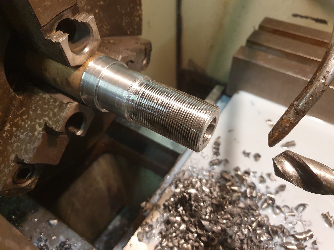

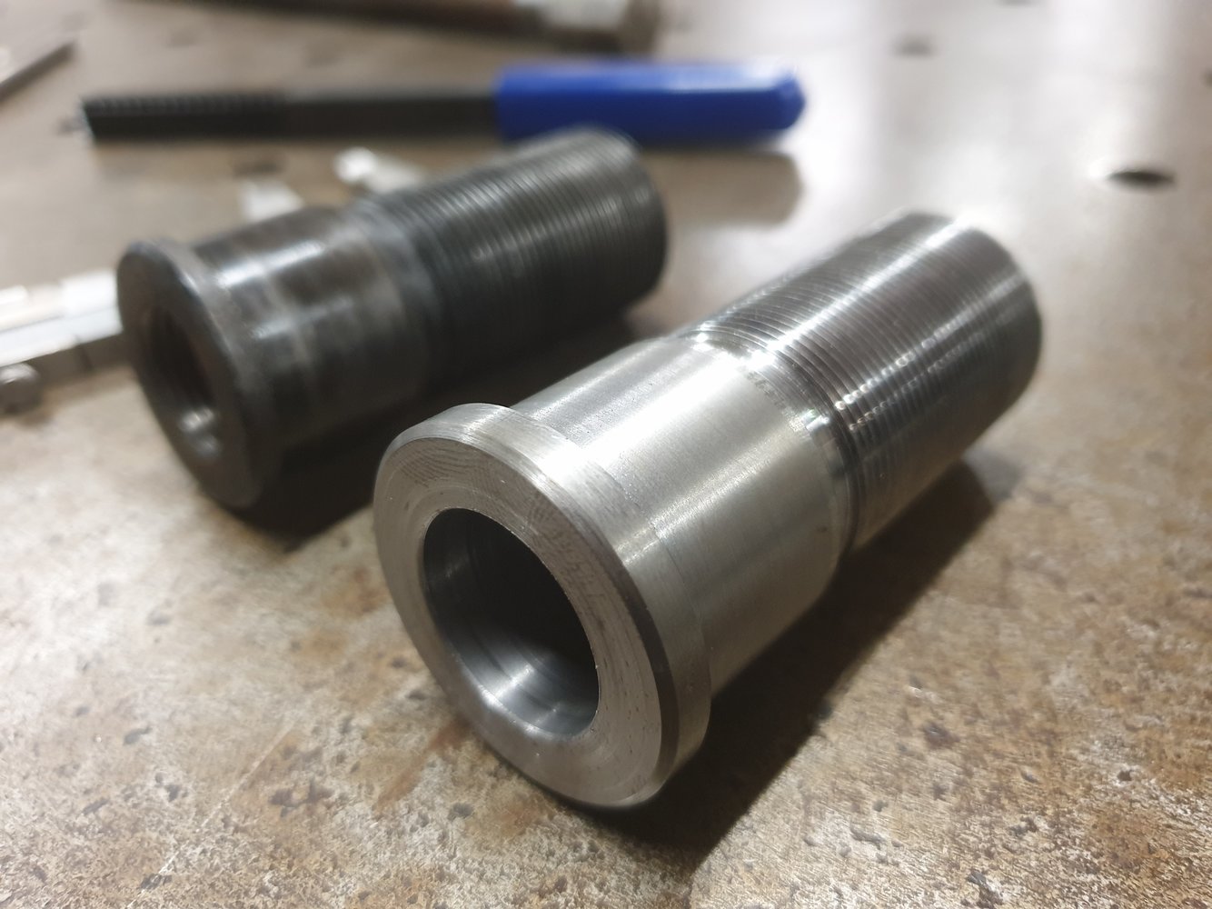

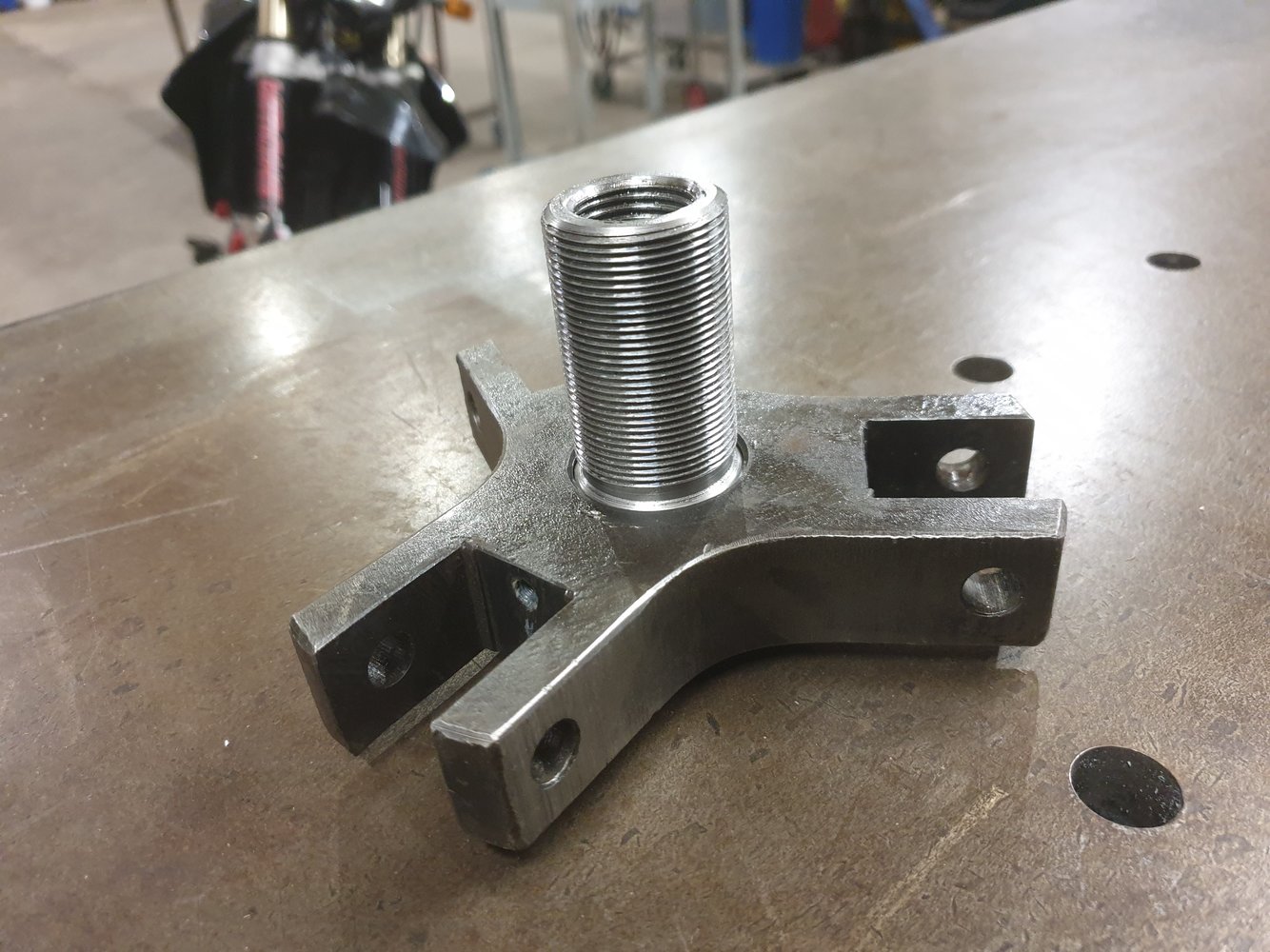

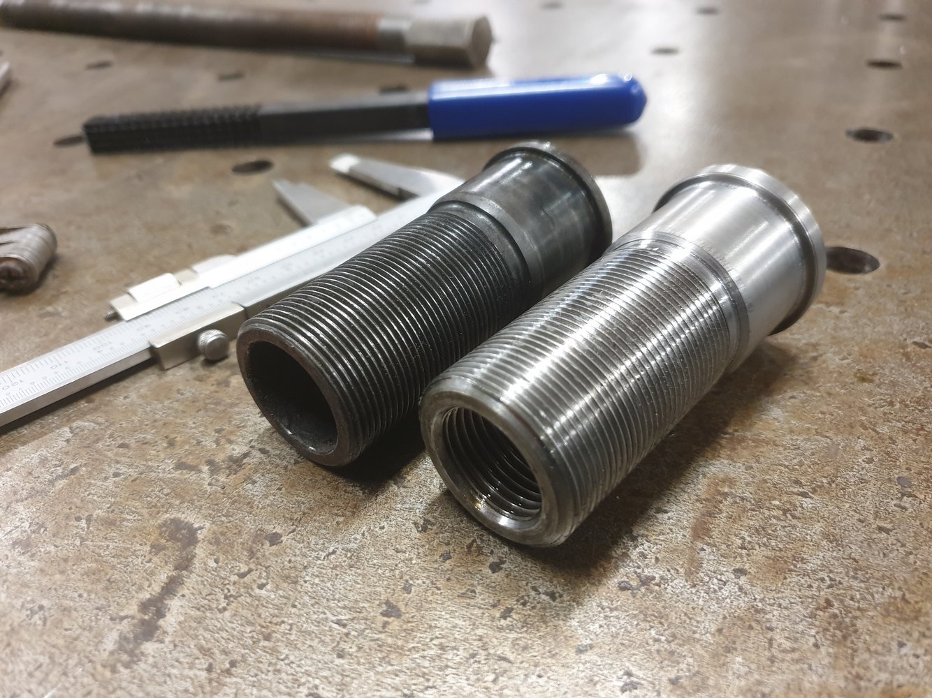

Shouldn't be, even at lowish rpm carbide should work well.Those threads do look pretty good for mild steel though, mine are very ragged edged when using carbide thread inserts
On mild steel? I've never had much joy, maybe my cuts aren't deep enough or something but its literally like its tearing the steel not cutting itShouldn't be, even at lowish rpm carbide should work well.
APT carbide inserts for stainless. They cut great, really sharp, and well priced too. I'll be buying more, I think. The internal threads were Yamaloy inserts from Zoro.Hot rolled doesn’t thread great. Was you using HSS?
Aye, should cut fine, usually my first pass is 0.5 or 0.7 on dia and then 0.2 or 0.3 after.On mild steel? I've never had much joy, maybe my cuts aren't deep enough or something but its literally like its tearing the steel not cutting it
