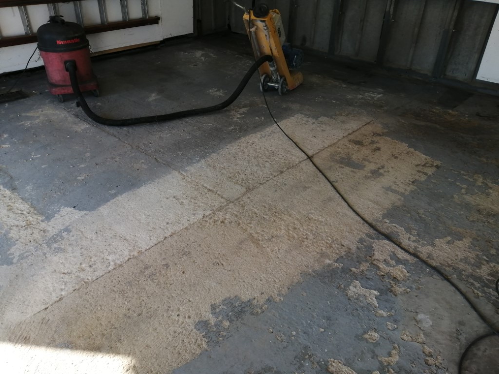

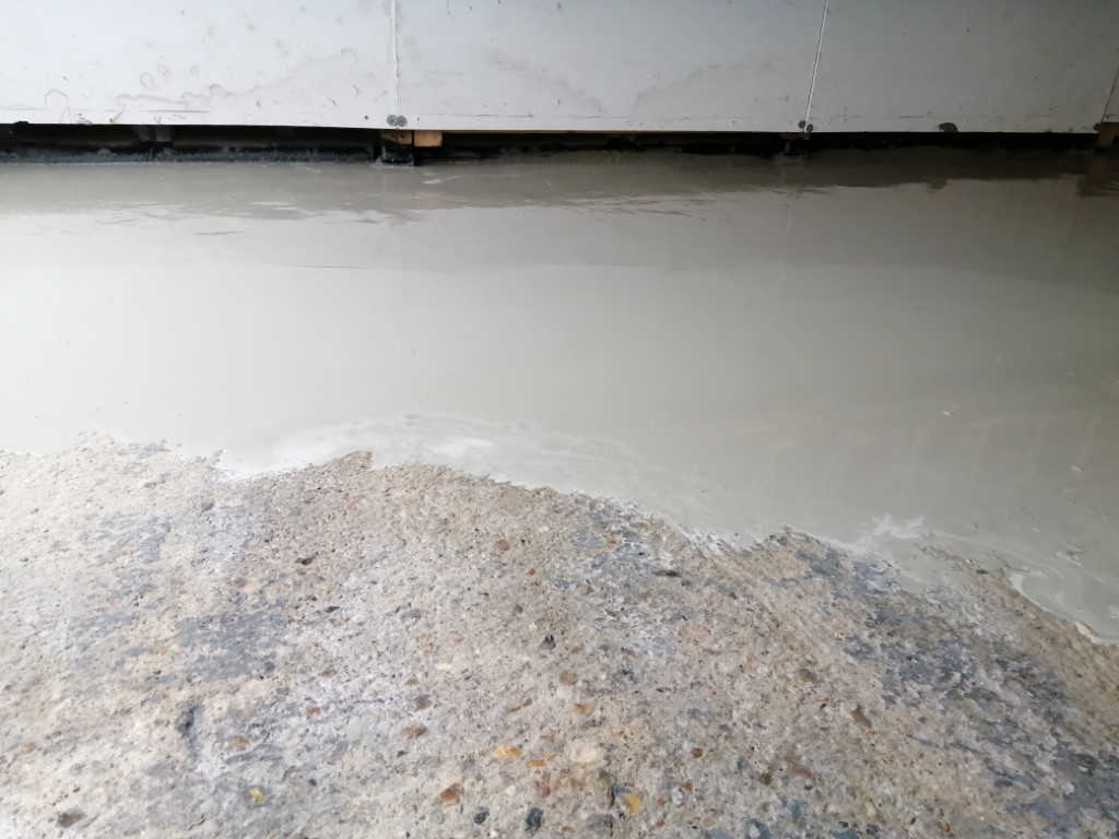

Garage floor laid by someone with no clue. Quite a thick slab but laid with too much water and not enough cement. We had some material left over at work so I brought it home along with a floor scarifier and set aside this weekend for fixing the floor. Rightfully it should be completely removed and re-laid but that's never happening so this is making the best of a bad job.
Grinding the floor. You can see the rough patches where the powdery surface broke up. Some areas were very bad and had been patch-repaired before.

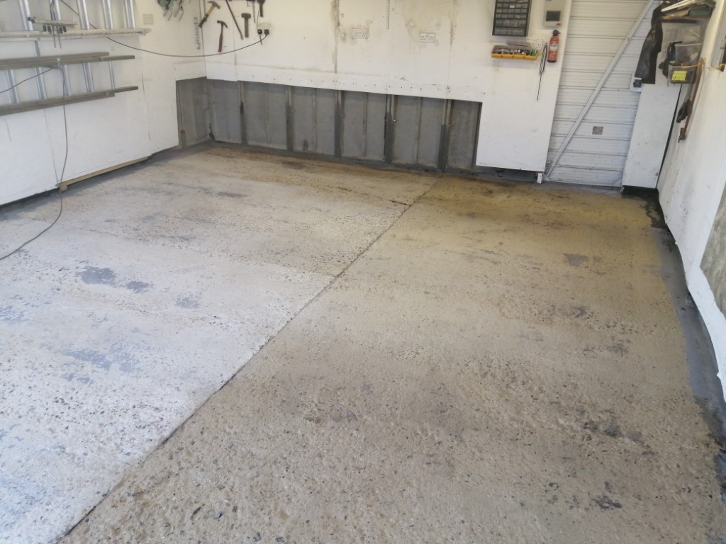

Grinding done yesterday and a good hoovering to pull out all the loose grit. After this the couple of really bad areas were repaired with Fosroc.

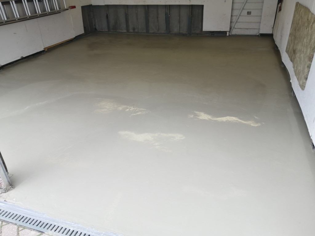

New self-levelling compound going down on top of PVA primer. The stuff (Ardex K301) self-levels but that doesn't mean that you pour it out and forget it - you have to trowel (or roll) it out flat then the trowel marks level themselves. I'm no expert floor layer but it's coming out very respectable.
All done, needs at least 48HRS before driving on it. Going to leave it a few weeks thne give it a couple of coats of light grey floor paint. The white marks are reflections of the striplights.
