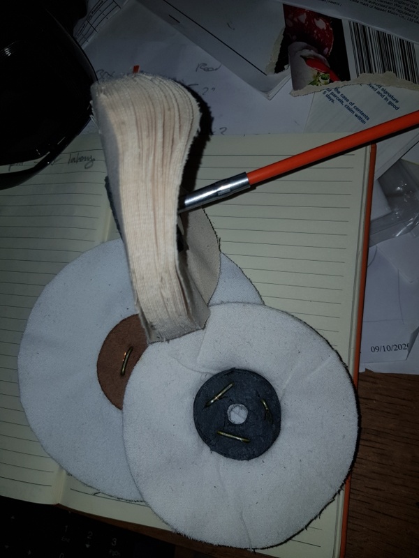

Not so much made as cobbled together. I'm replacing our 15+ year old heat recovery ventilation system and need to clean out the ducts. It's all 4" and chimney brushes are far too coarse, just needs something to budge spiders and dead skin. Also drain rods are a bit too clumsy for delicate ducts including the flexible bits.
Looking around there wasn't anything easily available that wasn't going to cost 20 quid or more and you knew that it would be a pile of rubbish going straight to land fill.
Then, like most good ideas it came to me while walking the pooch. I have electrical duct rods, and I have polishing mops for the bench grinder. One M5 bolt and two repair washers later and the mark one duct sweeper is ready to go.
You can get various mops from very soft up to stiff close stitched of even scotchbrite so should meet every eventuality.
Cheers
Andy
