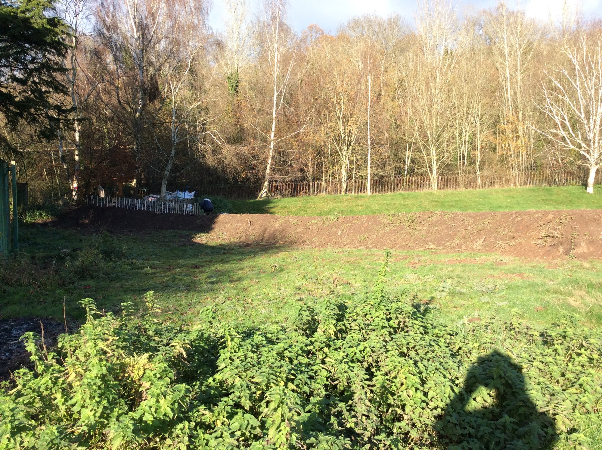

Does making a mess count?View attachment 262448 View attachment 262449 View attachment 262450

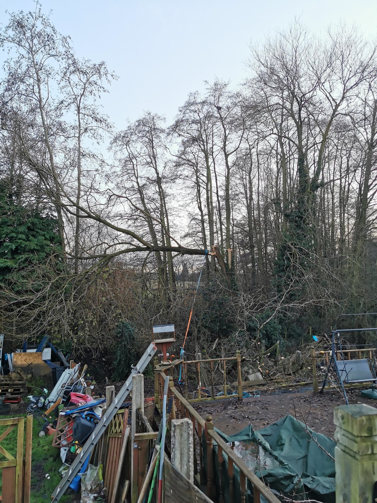

My chain saw gave up so I spoke to Aldi who said they had no battery chainsaws in the country until the 10th Dec but they could ship me one from Germany. It came today so I finally finished chopping that tree down .....but it was in the dark and my phone had only 10% so no after pics yet...
