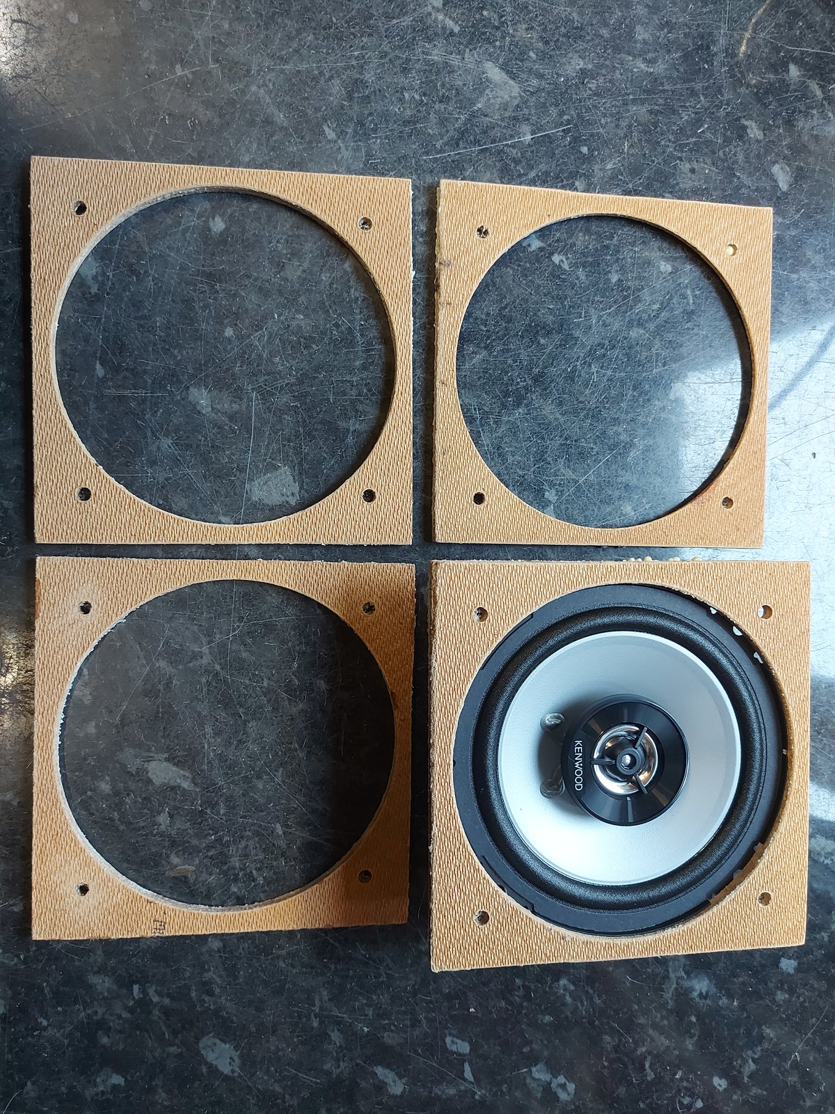

Speaker spacers to replace an original set of 50yr old Voxson speakers in a car.
@Parm will laugh at their size, 130mm.

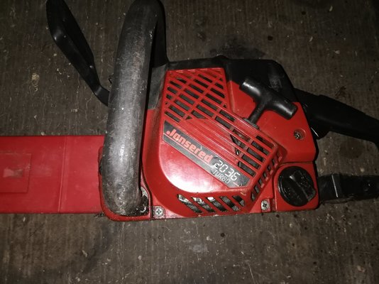

Today I've had to buy firewood with my father.
So tipped the rear seats put a blanket to save my car's interiors
Loaded and unloaded .
Eat fish for lunch .
Got hired for a job I'll be working tomorrow.
And once my nephew wake up I've been working on my chainsaw .
Nothing special just an homeowner grade jonsered .
Which seems to have been made by Husqvarna from what I've understood reading a Facebook group (Stihl users group)
No matter who made it TBH , just curious to know if it's really made by Husqvarna or not .
Can someone please tell me if it's true or not ?, first time I'm having to do with jonsered product,I just know that it's a good brand from users ratings.
So essentially I've saved this saw from the trash bin while working on a jobsite.
Previous owner gave it to me when I've had to repair other things for him .
I've managed to make it run a while ago , replacing the diaphragms on the carb .
But discovered soon where was the problem.
It didn't have power and the engine was inconsistent and it did rev up way too fast

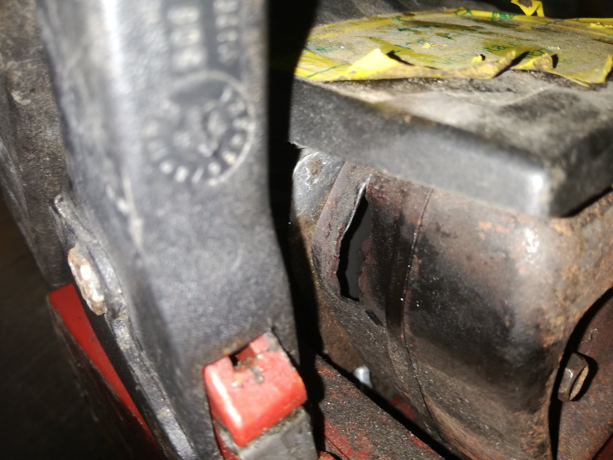

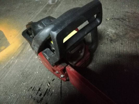

Removed the clutch cover and discovered that the entire power output components were missing ,so no clutch ,no sprocket , and no clutch bell.
Thanks to @MCKDAVID who commented a thread about chainsaws I've posted...
He offered to help me ,he sent me the missing parts with no charges for them.
Thanks again David
So back to the saw , after little bit of adjustments to fit the clutch properly I've managed to make the chainsaw work again.
Very happy .
Then I've removed the muffler to check the exhaust port and discovered that I was working on an half modded saw .
So I've completed the muffler mod .
Nothing special they forgot to make the final exhaust outlet bigger.
So measured the exhaust port, two calculations , and made the muffler outlet roughly 60% of the port dimensions .
Now it runs really well with a good sound .

I should read the plate .Some of the Jonsered saws share the same mechanical parts as the discontinued Huskies, its not hard to cross reference parts like barrels/pistons.
