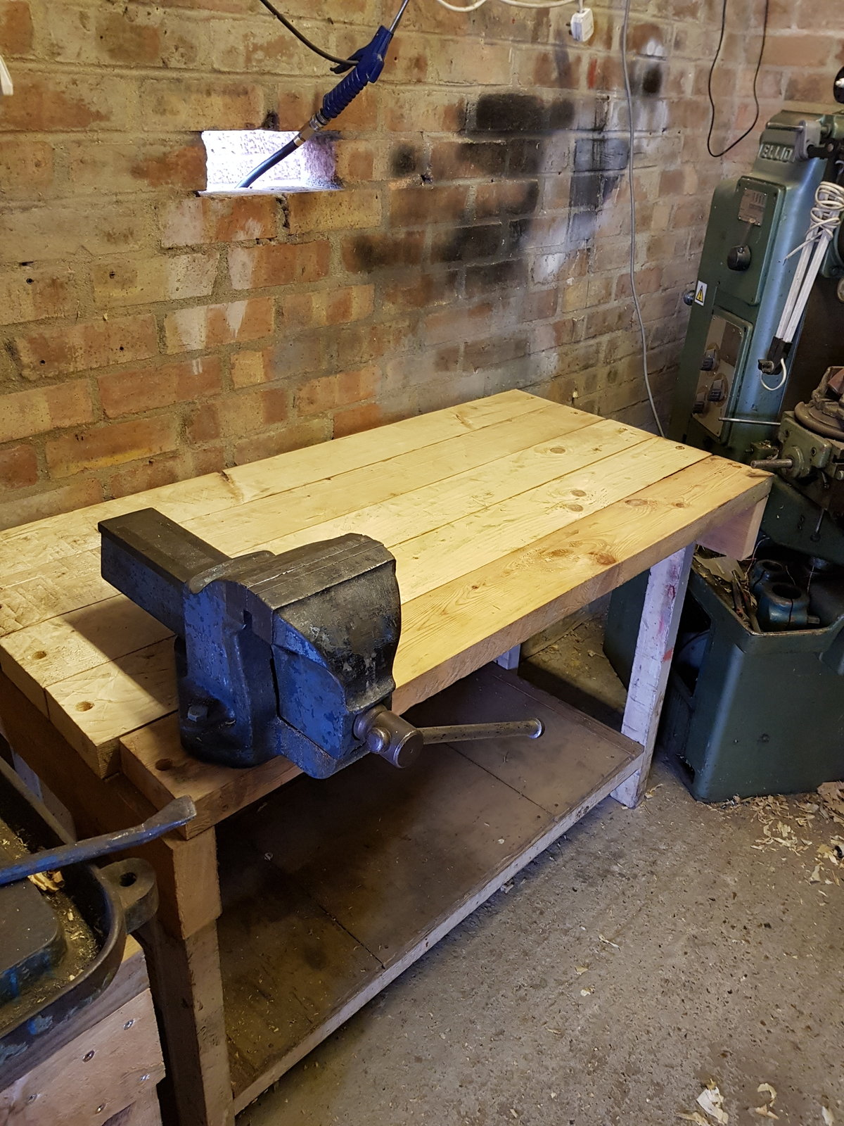

.Finished making a new top on my old work bench this morning;
The old surface was about half an inch thick, peppered with holes and cracks, the boards that made it up weren't the same thickness so there was a dip in the middle like a really shallow tool well. Now it's 50mm thick and after a whole day of planing nearly 5mm off the whole thing it's a nice even flat surface.

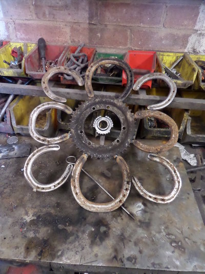

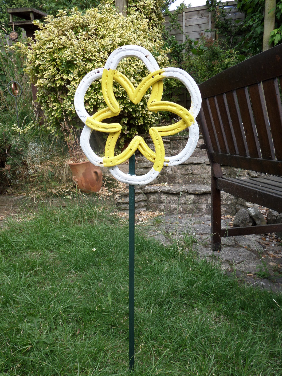

Oh yes, my take on a Venus fly trap for the Mother in law.

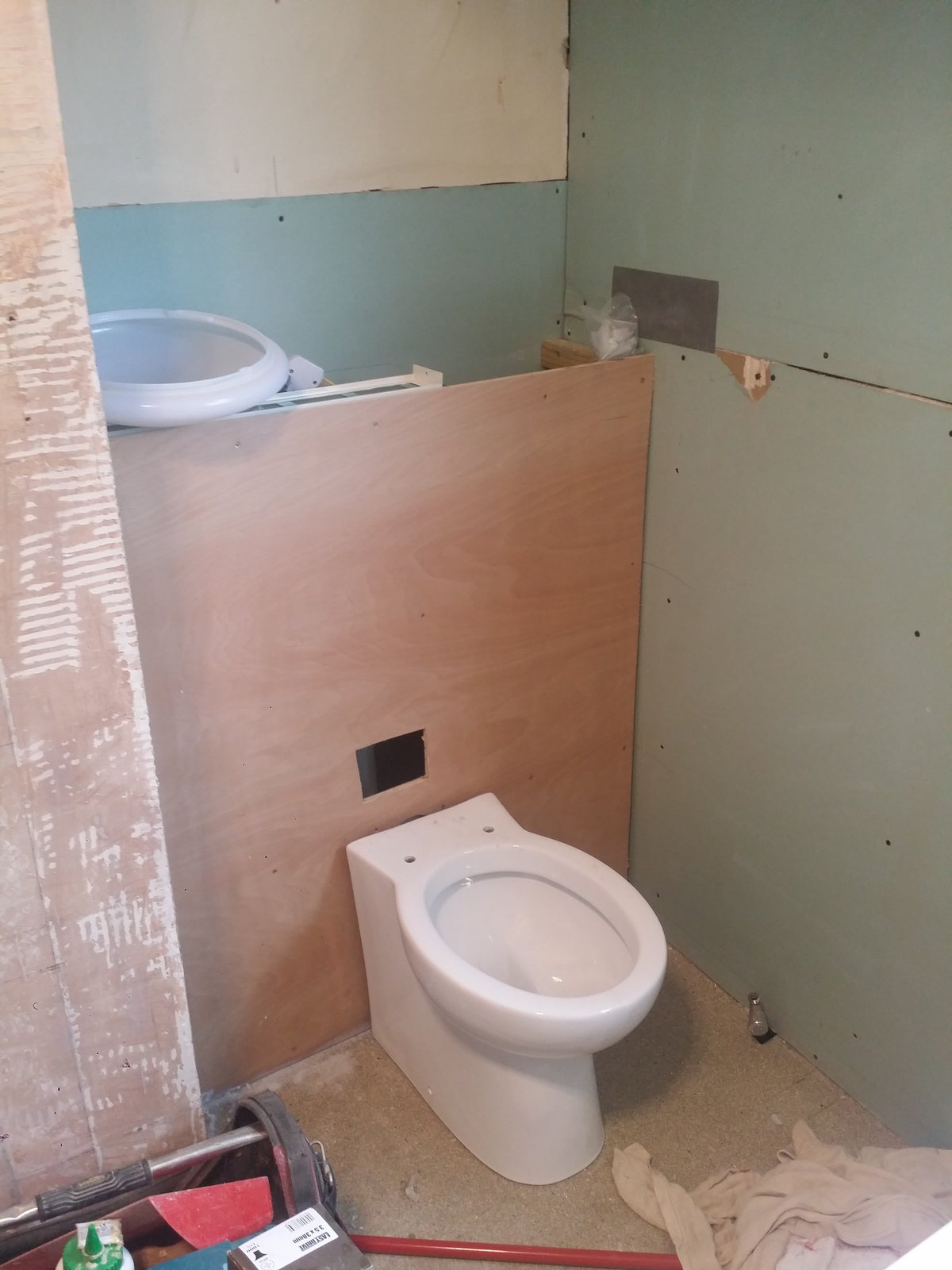

Exhausted. Would have been done without the border.
Battling a pulled back muscle from Tuesday and a cold/throat infection that reared it's head the same day. All I want to do is curl up on the sofa but that won't get me a shower. View attachment 114968
Floor being stuck tomorrow and bottom row in the afternoon and ready for grout Monday.![]()
cant wait to rip the bathrooms out. Hope you feel better soon.Lots of practice mate. The border slowed proceedings. Had to stop after the border and let it set. In hindsight I should have used rapid set for the border but still had a load of adhesive mixed up. Far to many internal corners in that room too. The walls I boarded were easy to tile. The plastered walls were shocking. Belly's and hollows everywhere. Building up walls and shaving tiles eats up time. Home straight now.Hopefully the wife wont see this your much quicker than me only managed to paint three walls this week. I hate paintingcant wait to rip the bathrooms out. Hope you feel better soon.

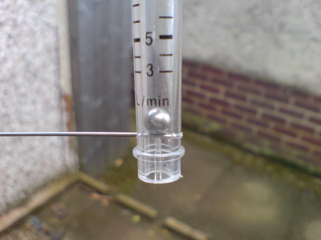

not something Ive made just a simple modification to an ebay pea shooter (for checking gas usage) . Ive got a couple of these and the balls keep sticking, so the easy thing to do is to drill a hole and stick a thin peice if welding rod through it. In this case it was a 1.00 stainless rod. at high flow rates the rod may be sligthly restrictive, but cant see it being an issue at up to 10lpm which is what I'd use as a maximum.
It's a neat trick providing your pin is a perfect seal in the drilled holesnot something Ive made just a simple modification to an ebay pea shooter (for checking gas usage) . Ive got a couple of these and the balls keep sticking, so the easy thing to do is to drill a hole and stick a thin peice if welding rod through it. In this case it was a 1.00 stainless rod. at high flow rates the rod may be sligthly restrictive, but cant see it being an issue at up to 10lpm which is what I'd use as a maximum.
