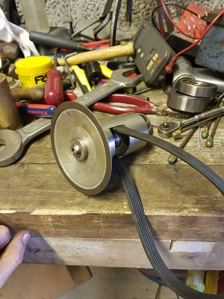

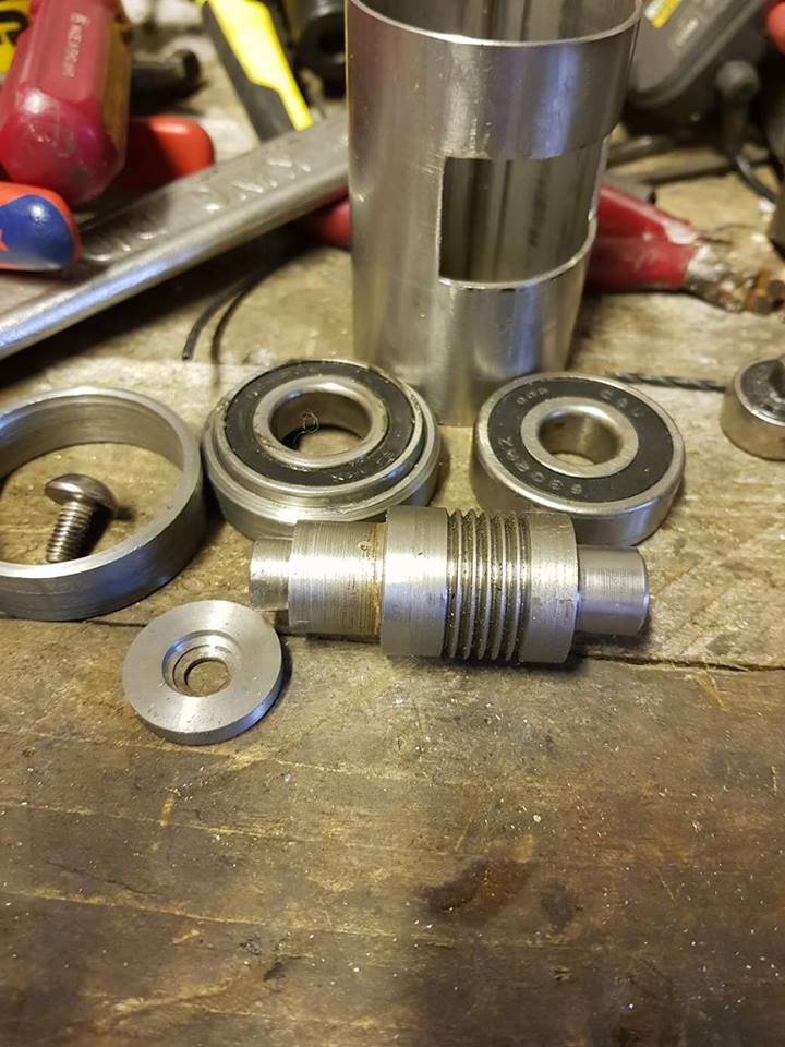

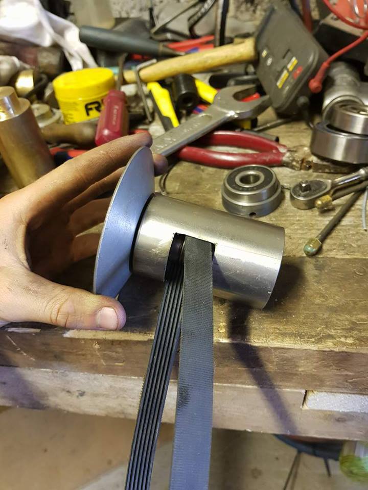

You got to clean up that bench mate..I've started making a small bench grinder for sharpening brazed carbide tooling;
View attachment 113464 View attachment 113463
Unfortunately I've cut the grooves for the poly vee belt too close, only slightly but enough for it not to stay in place. I think I've also damaged the bearings pressing them in place and I don't have a spare for the front one (It's got a bigger ID than the back so there's a bigger surface for the wheel to mount against).
I also haven't figured how I'm going to mount it either, ideally I'd just weld something up...
