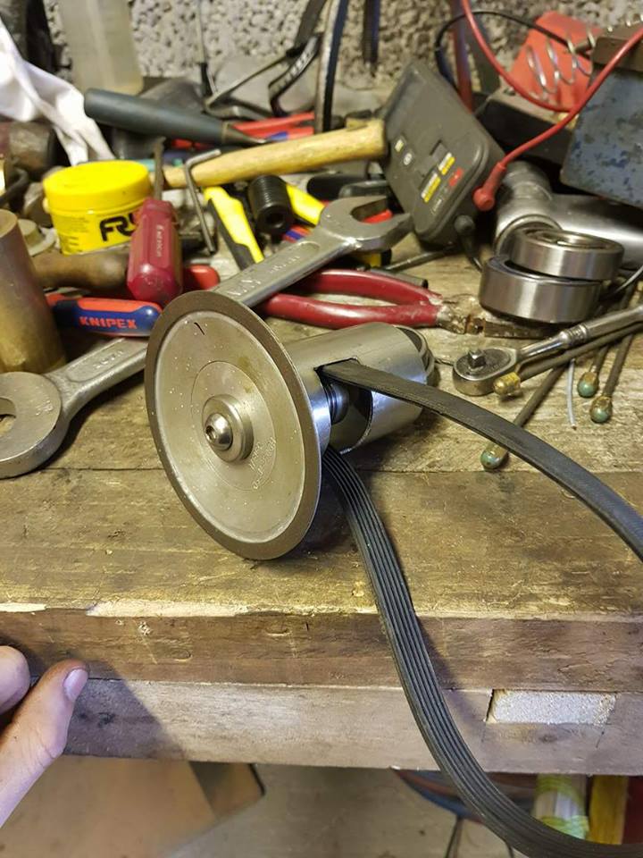

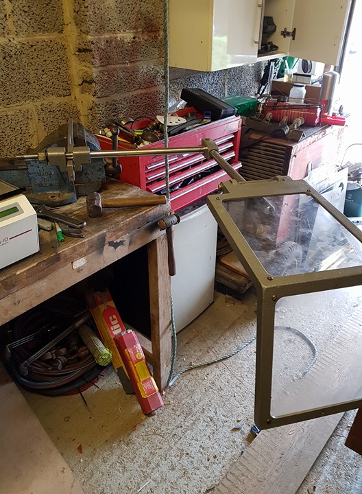

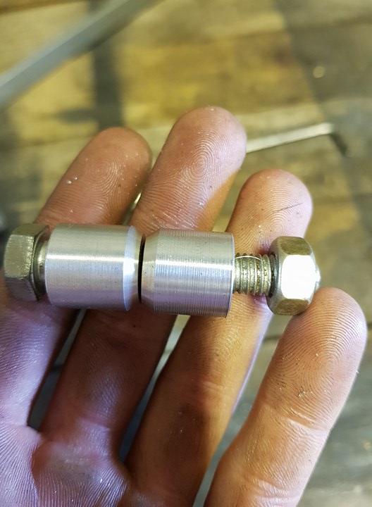

. They go in a hole that intersects another hole with a shaft though it at a right angle, tightening the bolt makes the angled faces clamp the shaft in place. Not sure what the guard is from but they're surprisingly expensive on eBay

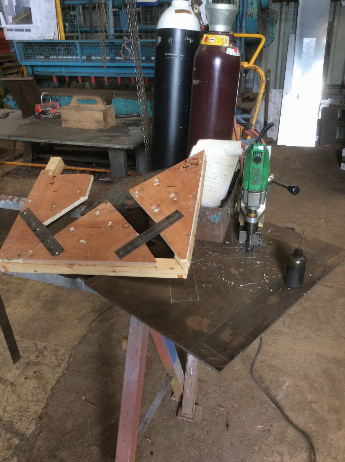

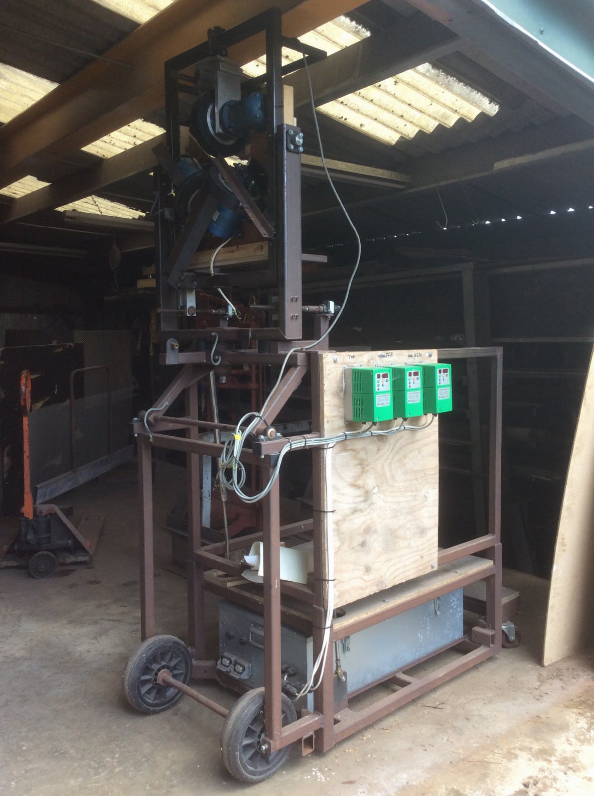

.Looking at your location in guessing this is one of Henry Pryors machines?View attachment 113064 View attachment 113063 Started on the MERLYN today been in the workshop 3 weeks waiting for a steel plate to replace the ply.
It's an automatic cricket bowling m/c,a customers that's had a gap in producing these,the plate locates the drive motors,attached to wheels that lob the ball,a lot of precision alignment req first,hence the temporary guide bars.
Profile some 8mm plate tomorrow .

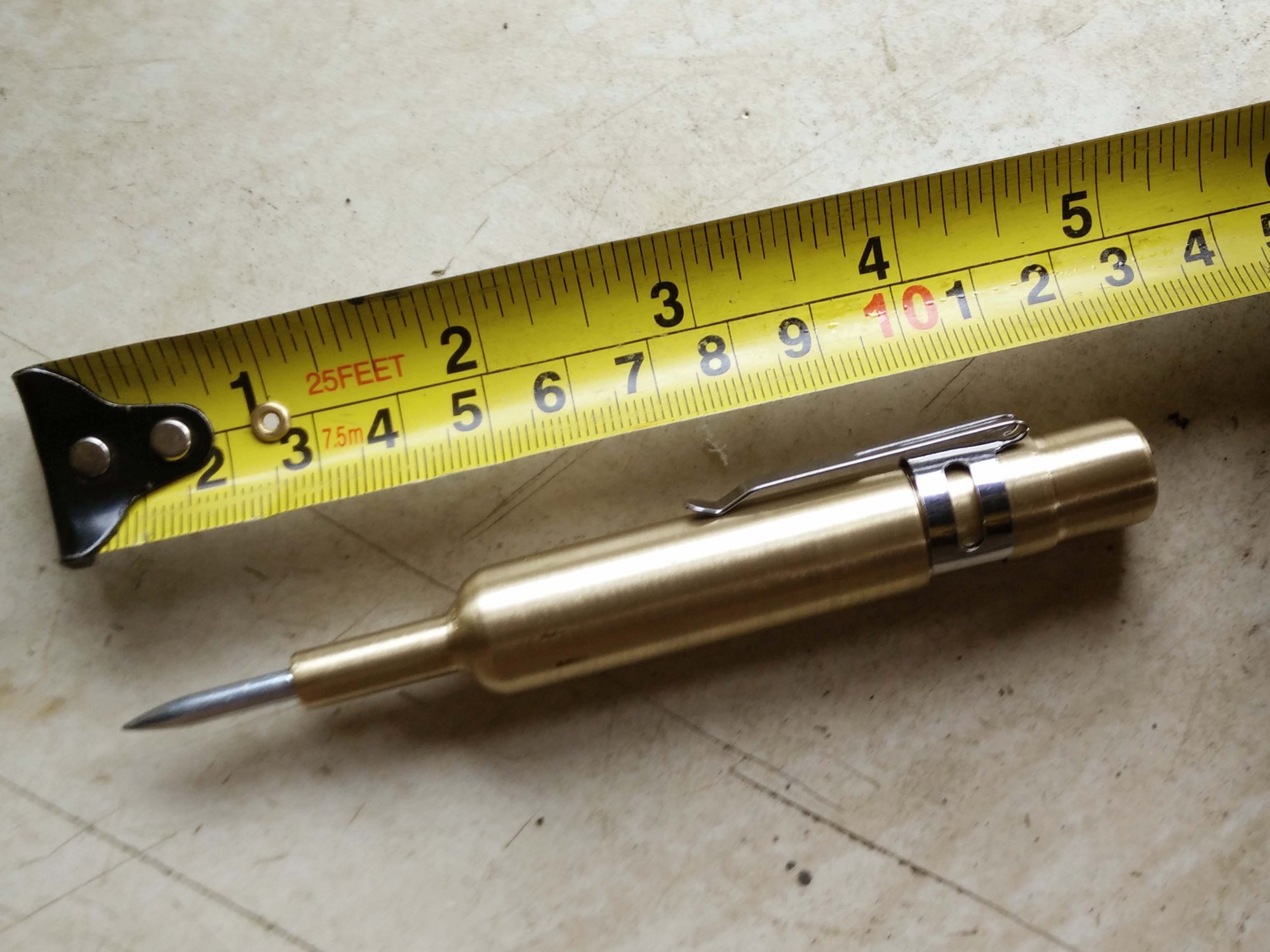

A scriber, I'm still enjoying the novelty of being able to poke around in the scrap bin and actually make something from nothing. Point will get properly sharpened tomorrow.
What did you make the tip from? Just that Tig Tungstens make excellent scribers.
